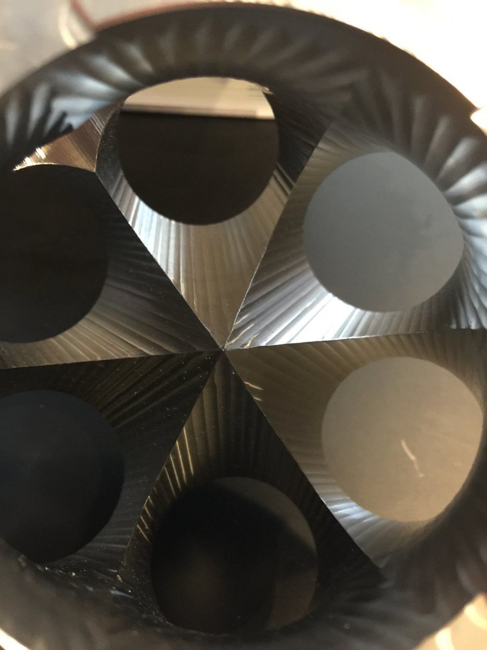

This thing is badass in person and shipping from Finland was fast! And the price was amazing! Half of what it would cost me here.
It is the turbo collector. Each exhaust runner will come out of the head to this collector and then the turbo bolts to it. The exhaust gases flow to this, get narrowed down to increase velocity, they spin the turbine, the turbine spins the compressor, and that's how you get extra air.
What is the side entrance for?
It is for the wastegate, it is what bleeds off the exhaust gases to control boost so that you are not running full boost all the time. It is pressure set by using different springs, and then you further control when and how much the wastegate opens by using boost pressure on the back side of the diaphragm. That exhaust gas is then sent either out through a "scream" pipe or back into the downpipe.
I won't be using a turbosmart, I will be using a Tial, but they are almost identical now days. But they had better pics and a video so I could better describe.
