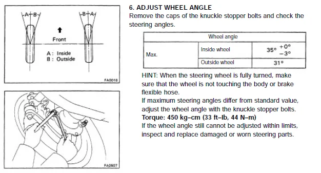

Rob - The steering stops were all adjusted on the 1991 LSJ80 when the last alignment was performed before to our Alaska trip this summer. They were all mismatched prior to the alignment and were not effectively limiting the steering travel at full lock, as designed. This is most likely where the difference exists between the two trucks. Perhaps I adjusted them a bit too much on the "conservative side" to limit potential steering component damage.

From the FSM:
Great info! I suspect that's where the disconnect is.
Perfect, thank you!
