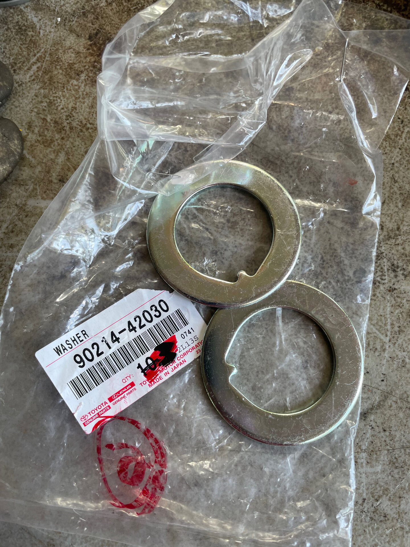

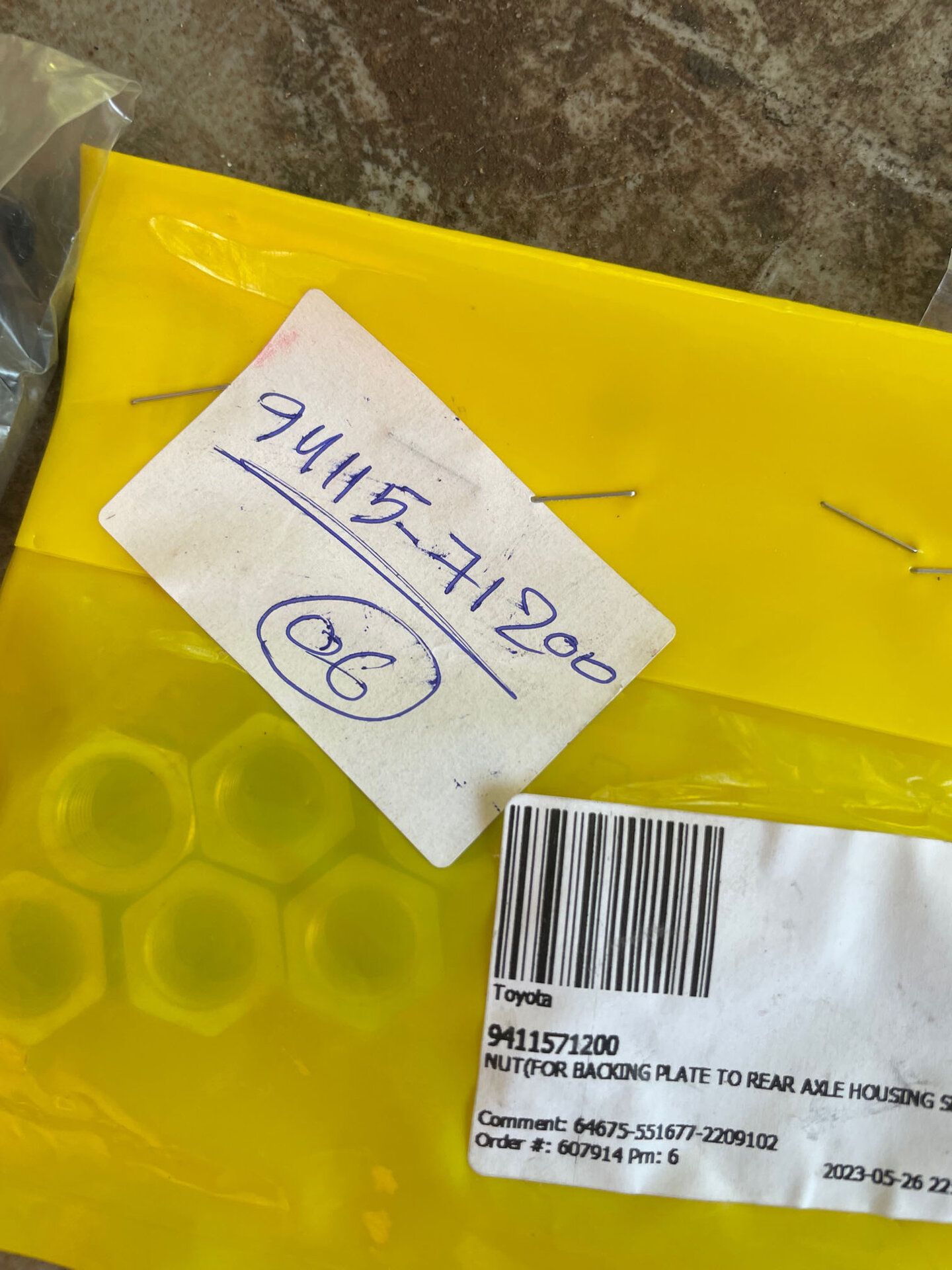

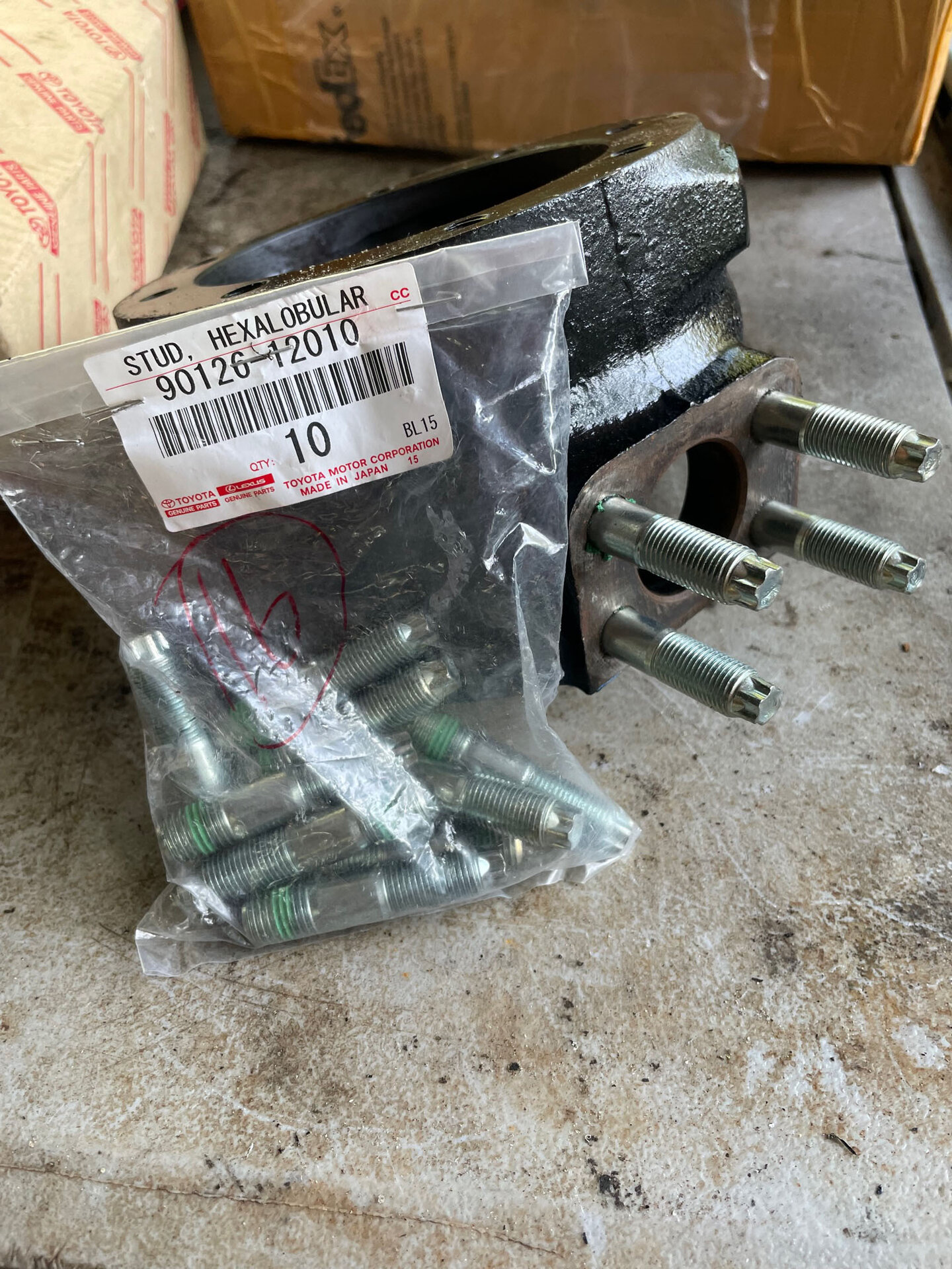

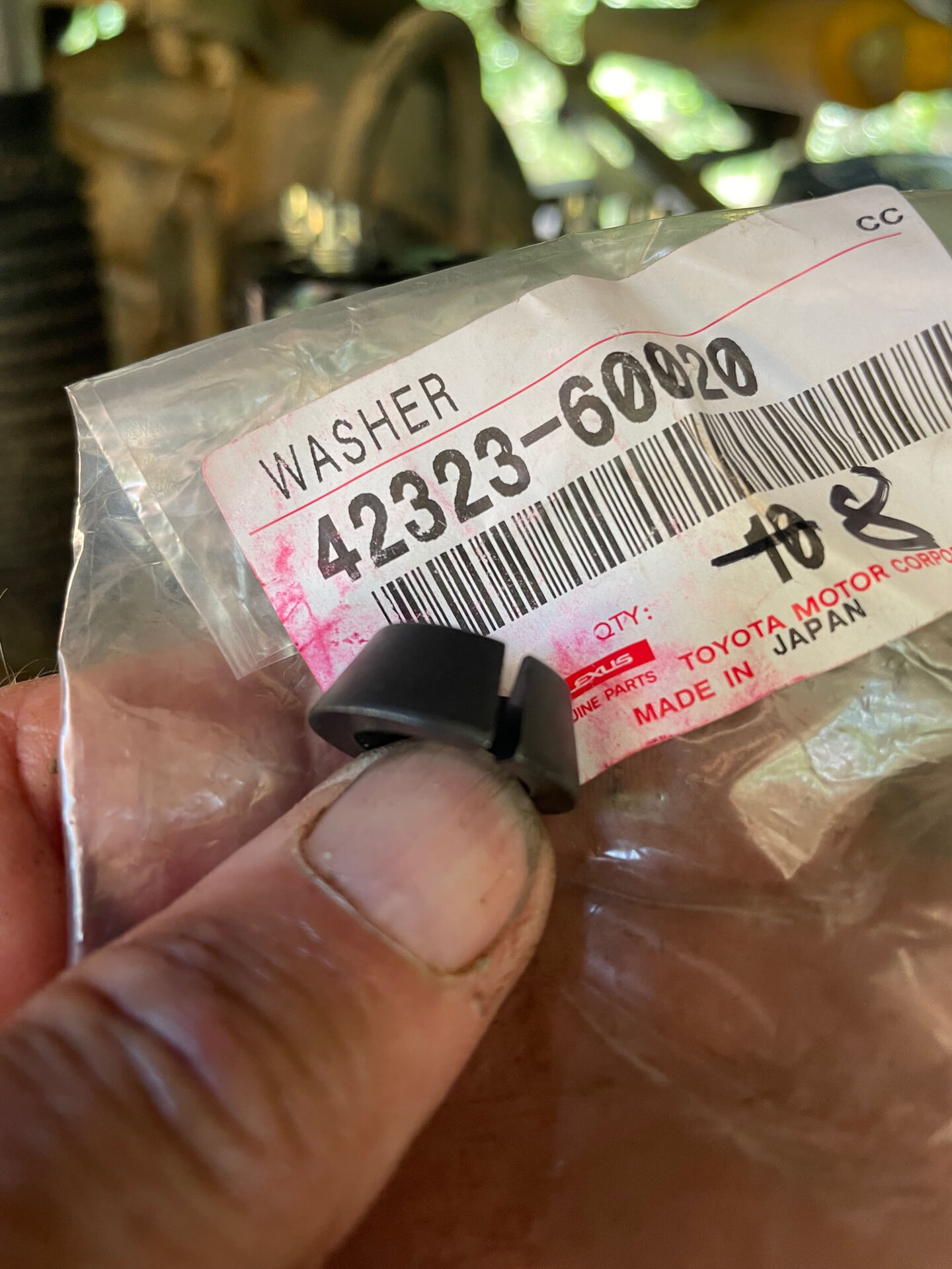

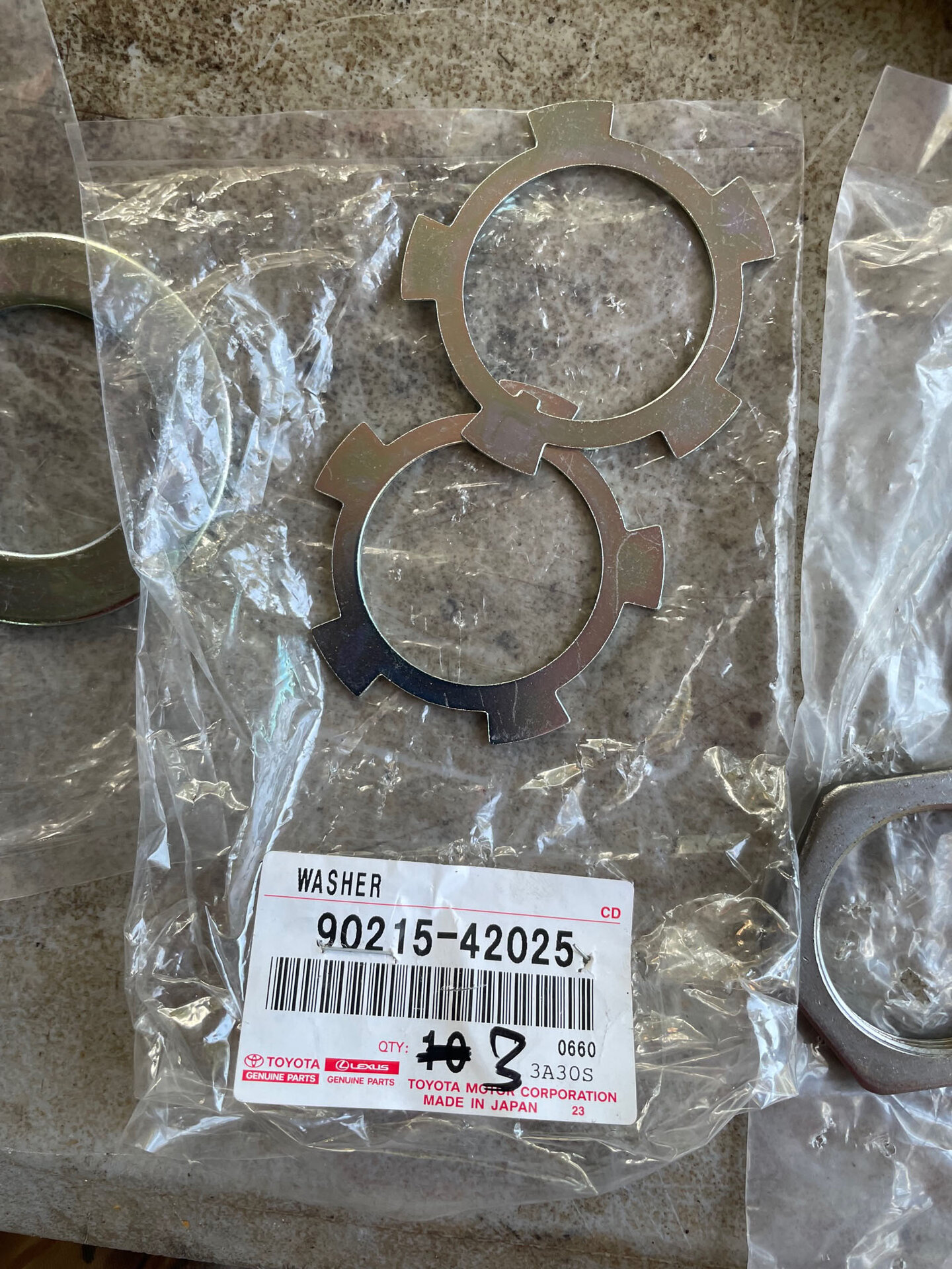

Knuckles went back together with new OEM fastners. Knuckle studs were upgraded, new cone washers, flat and wave washers, and nuts. Not knowing how many times these knuckles were dismantled and rebuilt, nor if parts were correctly reused, and that they've also seen a lot of use I decided to replace all with new OEM. Ordering parts through Partsouq eases the $$ pain.
After I set up the knuckles and installed the spindles I hit each fastener with a dot of paint to indicate that that piece had been properly torqued.

I should have the Toyota part numbers saved I used for the caliper brackets (the stock bolts aren’t long enough)- think they were 100 series hub studs but will have to confirm.
They had a good shoulder and hood thread engagement.

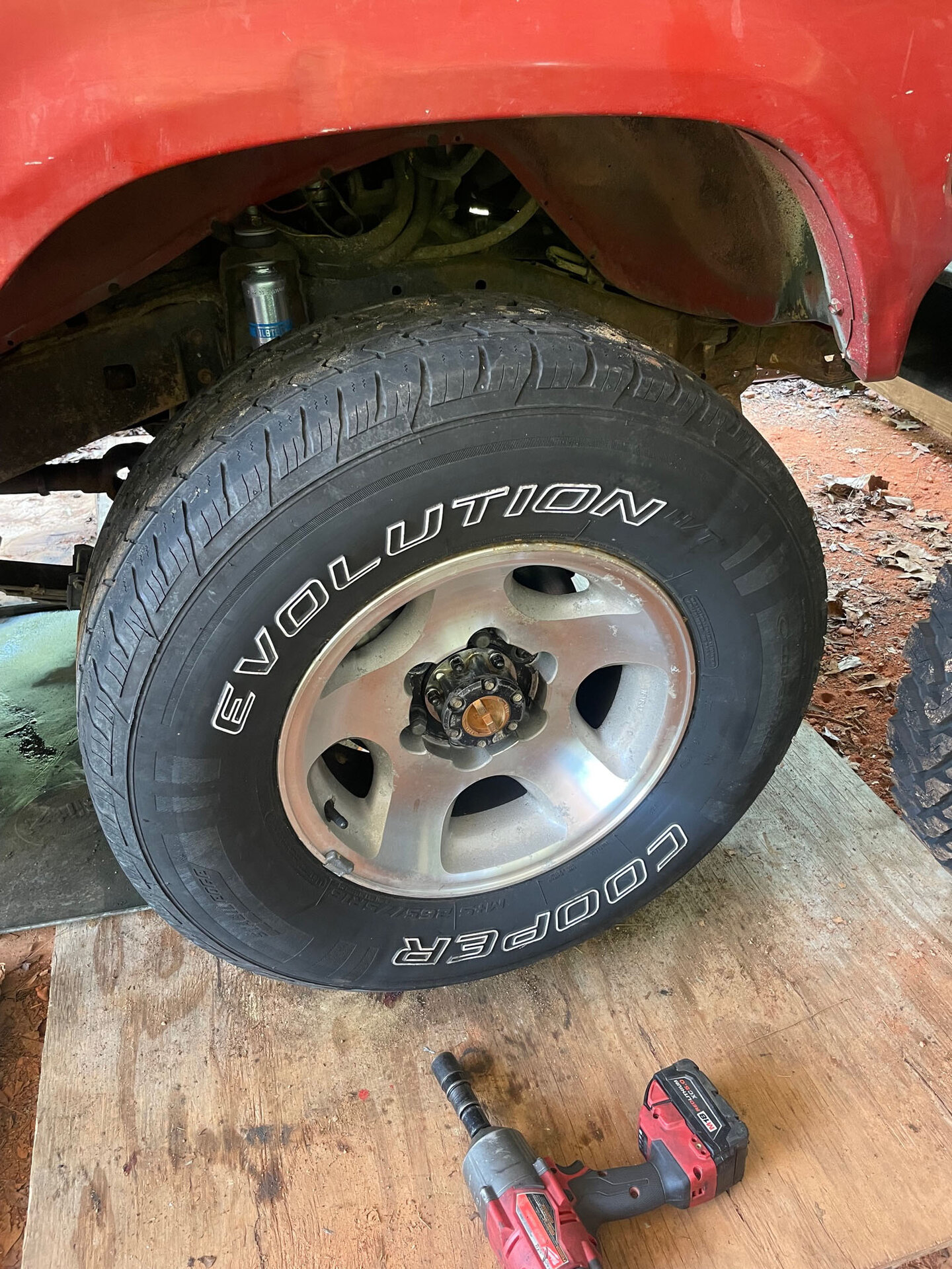

Test fit an 80 series aluminum wheel, which will not work. I tightened down 3 lug nuts and the wheel was tightly pressed against the caliper (?), it wouldn't rotate.
I have >1 million miles spread across a mini-truck, FJ40, FJ60s, and FZJ80, the OEM spindle nuts have always worked for me so I'll stay with them.
I should've mentioned I don't think they're better quality than OEM necessarily, but definitely just as good with the added convenience of being reusable and less likely for my sometimes shaky hands to have the socket slip off when torquing the nuts thanks to them being thicker.
