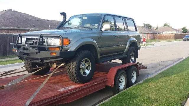

107 k on it. 850j and 863s, ARB winch bumper, safari snorkel. Seller said it had a locked up motor but when I got home last night(this morning) I was able to turn it with a breaker bar and then gently bump it with the starter. Didn't come close to turning it one revolution. Going to wait till I pull the valve cover and plugs. PO said he was driving it and it locked up and he drove on to his parents house???????? Friend who knows about cars said it was locked up. Thanks to Jeff and Kathie Old for checking it out for us.
