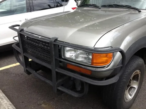

There is going to be a fully built 40th with SC, OEM aux tank, full expo build, HG and all PM done to it with 160k miles, all parts bought from me or CDan, tons of JDM goodies
Coming out of LA real soon.
Real baby rig.... Seriously pampered.
