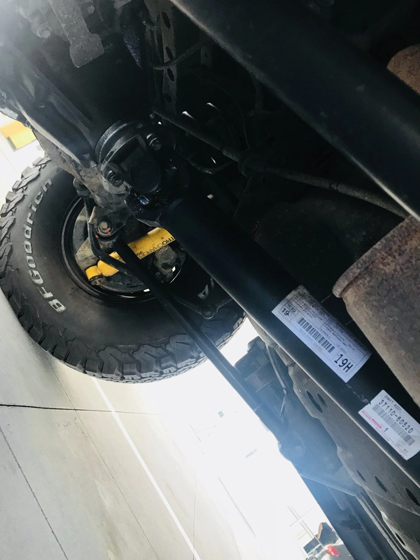

Even with a full sus refresh with oem bushings, new tie rods, double cardan front, and full front and rear axle rebuild with only the best made in jpn parts, I had a clunk upon throttle app at say traffic lights.
Got a new rear driveshaft. Now it’s like a Tesla. Zero clunk. Still plenty of emissions though.
You can go cheaper with just oem ujoints. I reduced my risk by eliminating variables.
I also fitted a brand new genuine rear shaft recently - for mine it was a 37110-60450. New slip joints have very little rotational freeplay but they still must have a very small amount otherwise the slip joint cannot function.
I'm just about to replace the front shaft as well - it had large freeplay in the slip joint but as part-time 4wd hardly ever gets used.
