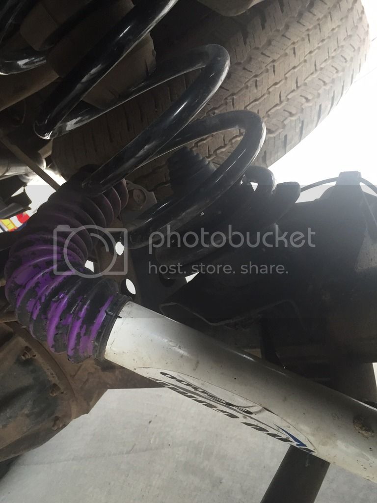

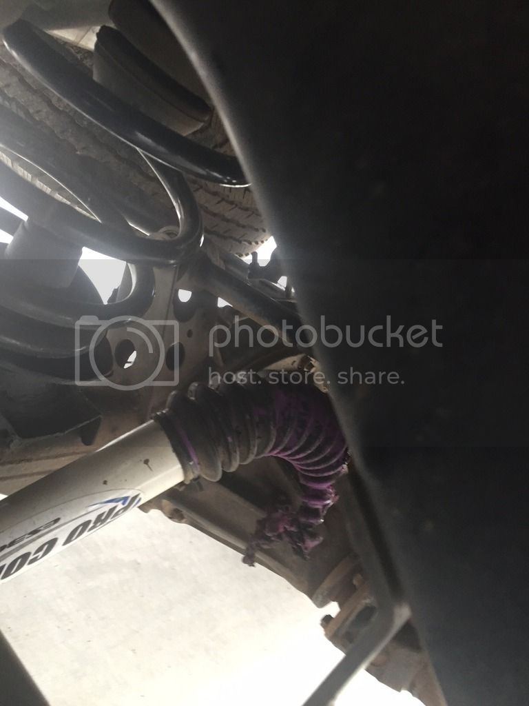

longer shocks to match - Oh yes, this is one thing Trail Boss mentioned...my shocks have come out twice now, and they stated he simply put on too short of shocks...ARGH...almost funny how much I got screwed...He did move locations back to his house from a shop he had, so, I think I have a good case against the guy, so long as he didn't fully shut down his LLC & if he did, the courts won't let me sue him personally.

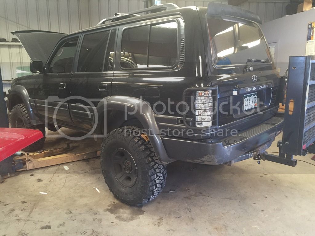

Let's see some pics of lift and what they cut, how did they lift the front? If you wanna come to grand junction colo I'll help ya fix it all, tell ya what to buy and I'll put it on for ya, but for 4 inch lift all ya need is springs shocks castor correction maybe drive shaft , could do rear links to correct angles, panga rds if ya want, maybe he didn't tighten your tie rods or used wrong ones?
Here's a pic of the back platform he built. Instead of having the spring platform, he cut off the dome piece of that and put a thick cylinder pipe in the hole which he welded and then welded a circular ring on the pipe as a new platform for the springs. The front was done similarly. Oh yes, this is also the first time the suspension fell out...HA

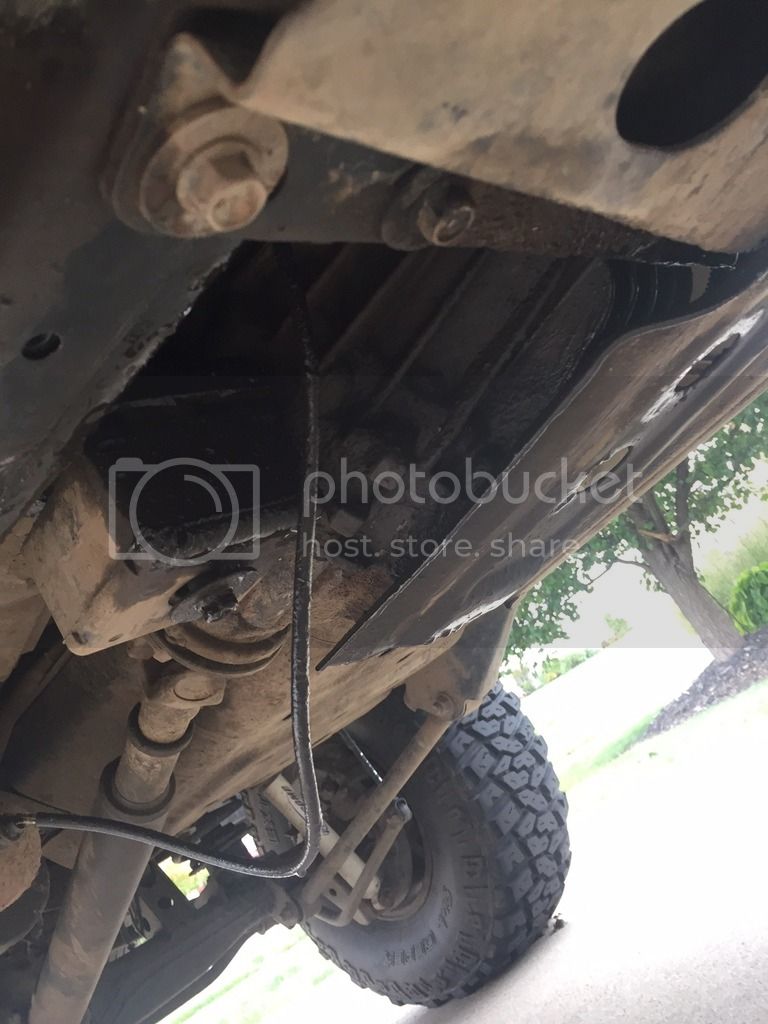

Here's the best picture I have of where the transmission fluid is leaking, but this is from the passenger side of the truck looking toward the rear, and again, you can see the platforms he build on the back axle for the springs. The bolt to unscrew and pump transmission fluid in is on the driver side of the truck.
Are your shocks bent? You could have wallard out your steering arms if tierod end was banging around and maybe messed up the wheel bearings when the rod end broke
Boss Trial in Tucson stated they think the shocks he bought were just too short. They fell out this time after a good trail, but, after they fixed them and made some adjustments to make them more secure, they completely broke without even doing any difficult or even medium trails.

Here's another pic of the platform he built for the back a little more close up, but a little dark:
That's just stupid, I hope whoever did this doesn't reproduce, get your rig to a capable shop as mentioned above, let them straighten it out and enjoy it. I hope you can recoup what you lost..... best of luck!!
