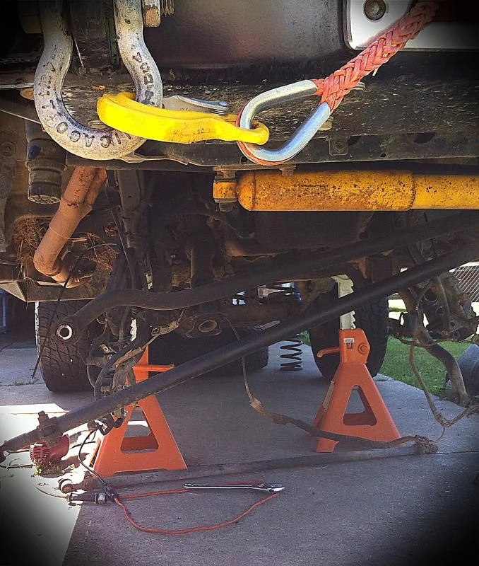

So I got my frontend out this weekend and have a weeks worth of blasting, painting and cleaning to do. That front end had seen its better days and hopefully I'll get to do the rear next offseason. Paul and I were discussing the fact its doesn't matter how many times you rebuild one of these its still one of the filthiest jobs you can do on your rig no matter how much you try not to make a mess :frown: spilled the gear oil and grease solution into the grass trying to move it so I could break it down I thought I was in the clear missed staining the cement :) but here comes Kristen in some new tan shoes with her puppy dragging right through it when my back was turned :bang: Ordered a second box of Marlin goods today so I'm hoping I'll have everything covered when its time to put it all back together.
Nice! She's gonna look Purdy!
