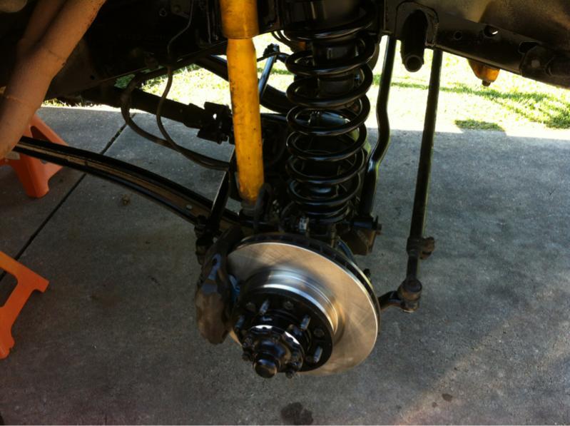

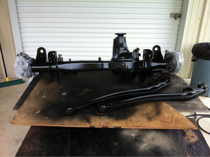

Well the weekend was semi productive not much time ferrying Holden back and forth to the festival. The third is in, gracious Mr Kegley, wire wheeled and sanded till I got it clean also hit the front of the frame and got it cleaned up. Finally mixed up a batch of rustoleum in the sprayer and soaked it all down. At least it'll be clean for the ride up to Tennessee ;) I fought one of the long field wipers last night and finally got it in, hopefully as advertised they are the last ones I'll install in this 80. Will put the other one in this afternoon and hopefully be wheeling it out to hang under the frontend. My neighbors look at me funny when I start up the 80 and let it run a while when it's sitting on jackstands ??? Someone has to be the redneck of the neighborhood right? LOL

Done ... And I don't know that the frontend will ever look this clean again so I have to document it :) besides the locker being engaged and not unlocking on the first test drive that failed I couldn't get out of the neighborhood. I popped the locker out and swung the lever manually with a gasket scrapper to unlock it then buttoned it back up and took the kids out for ice cream on a second test drive. Frontend felt good and tight and the locker engages in and out like it should. Will pop the backup pull-part rear locker and harness in the rear tomorrow or Monday then start packing it for GSMTR :) hope your weekend is good one as well :)
