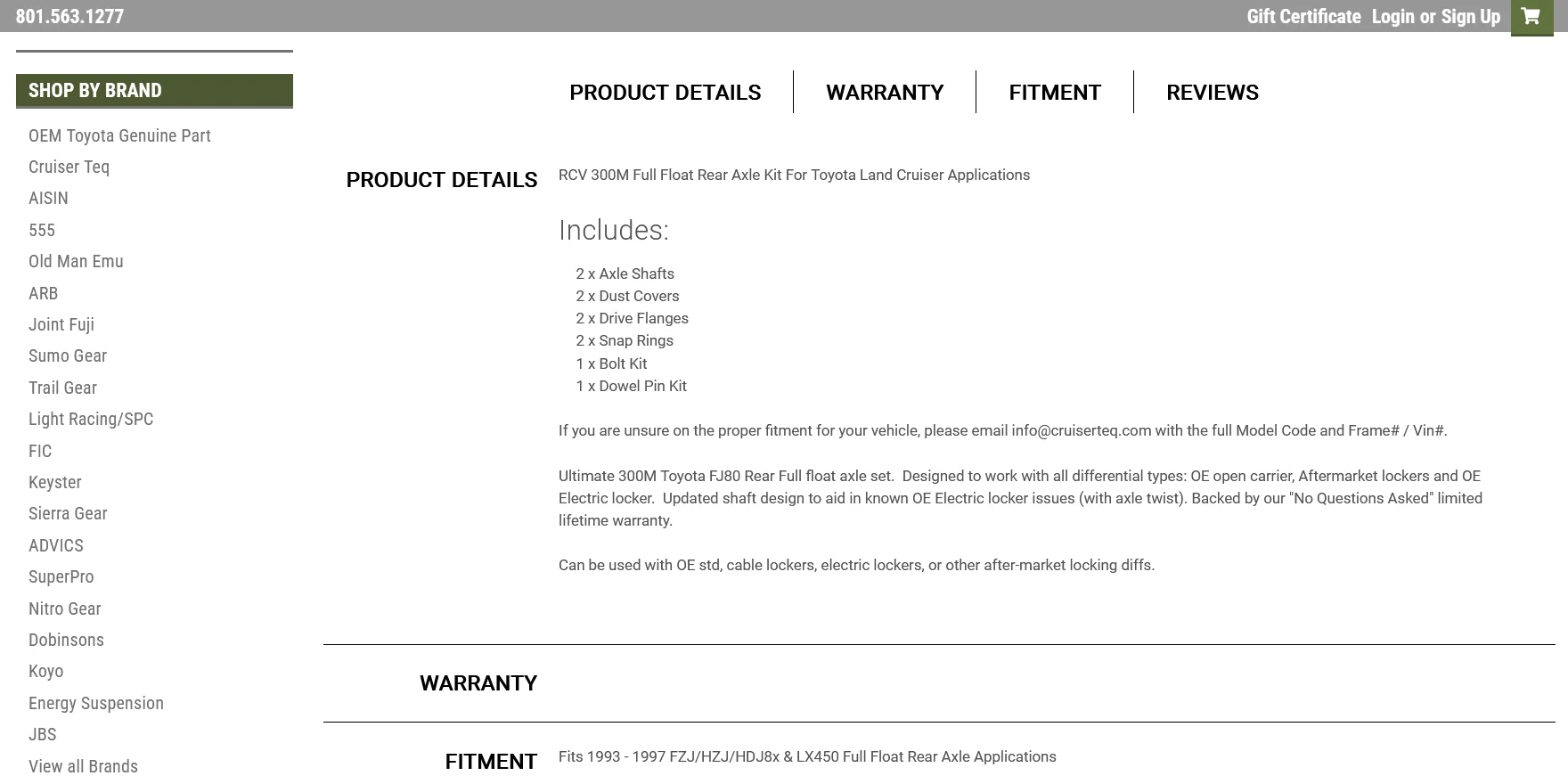

You can buy aftermarket shafts, CruiserTEQ has them (these are the full floating design, they don't list the semi-floating design):
These are sold in sets of two (both long and short) and are designed to fit all differential types. They will have the particular information you are looking for, if you really want to make one for yourself.
