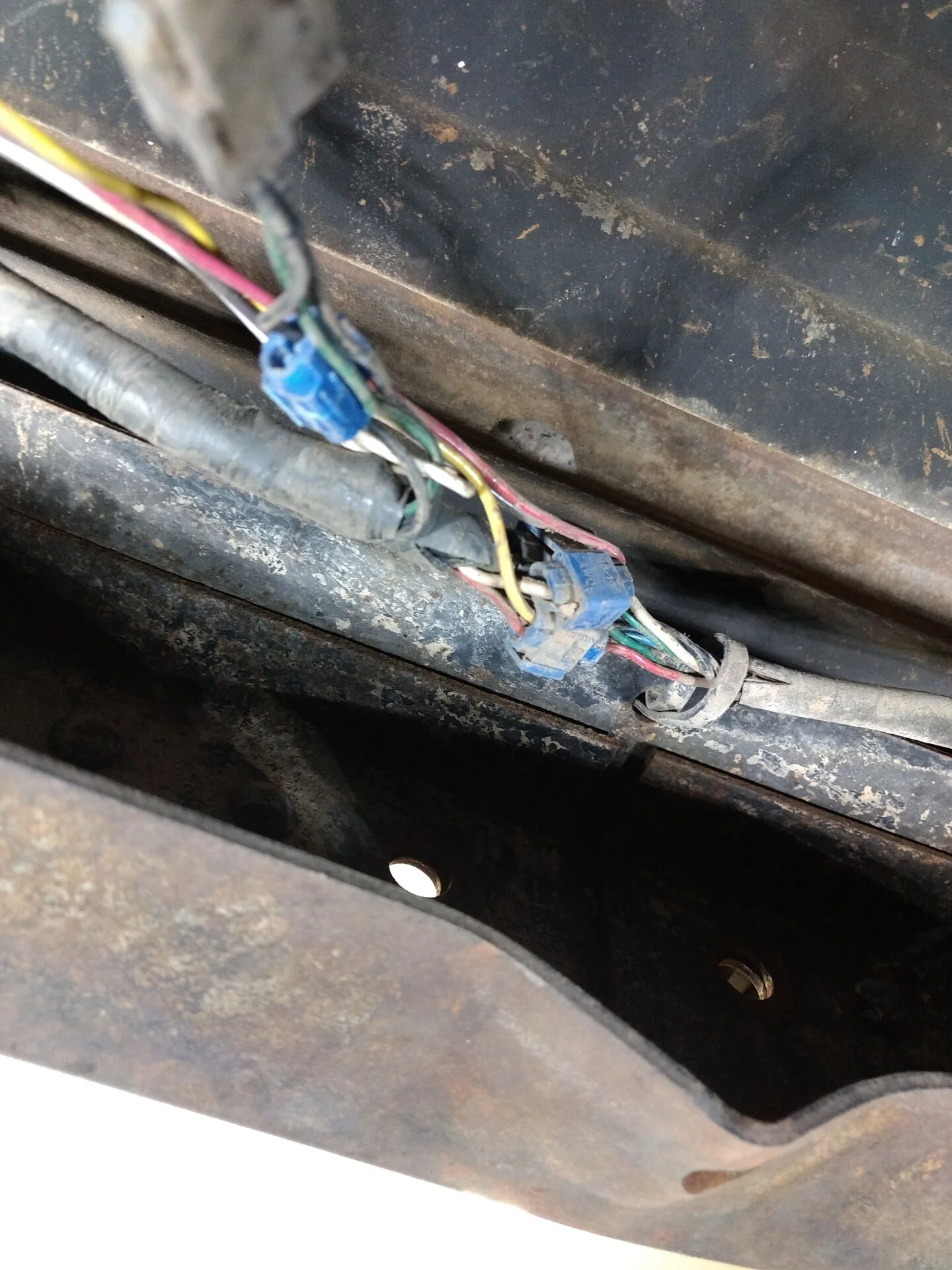

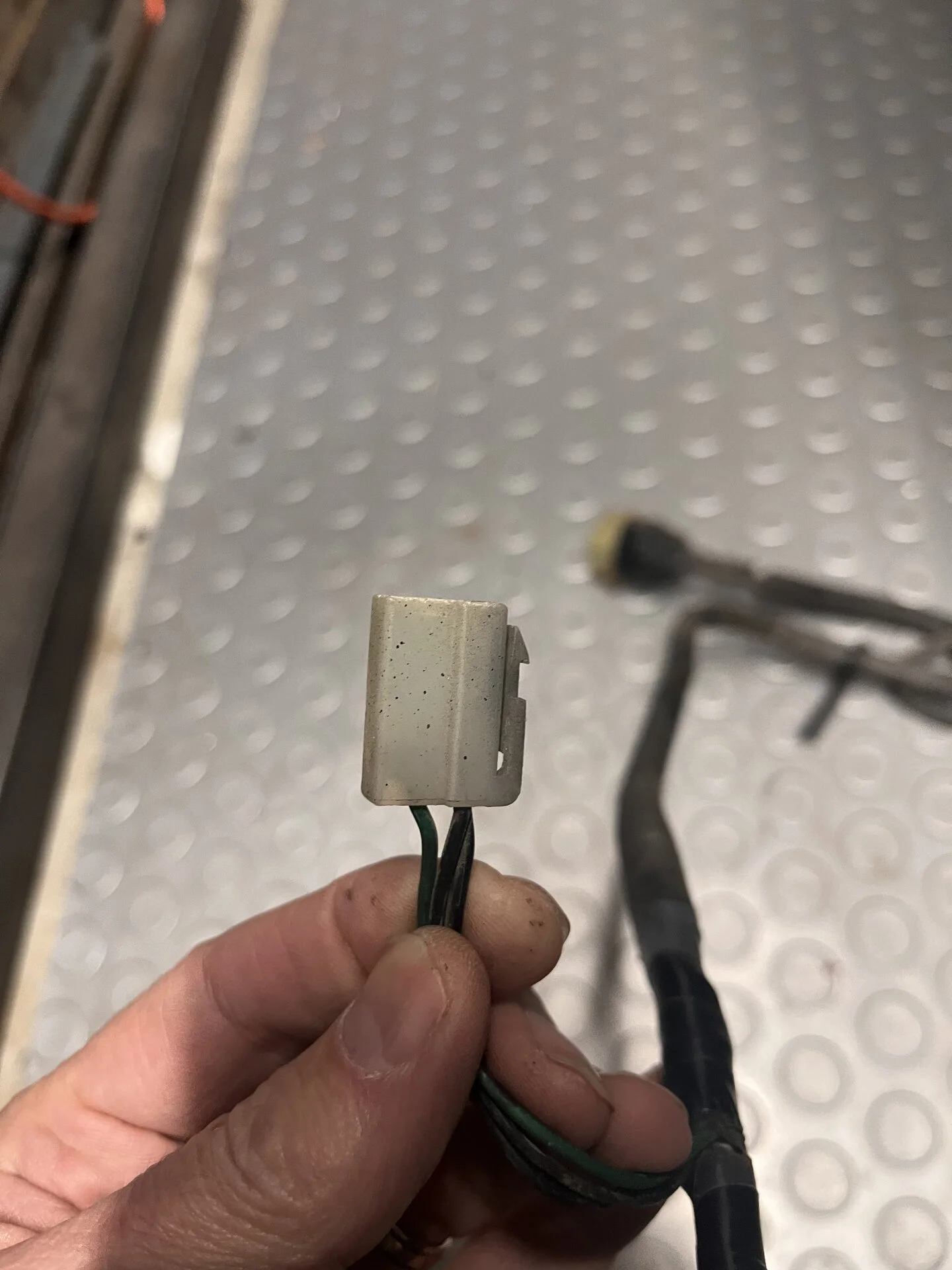

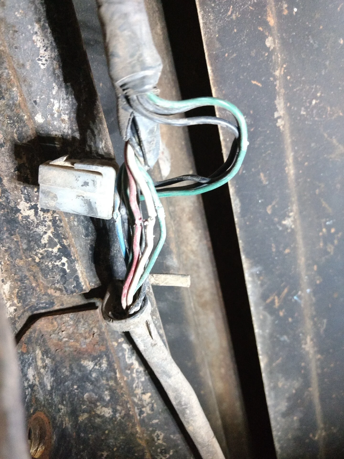

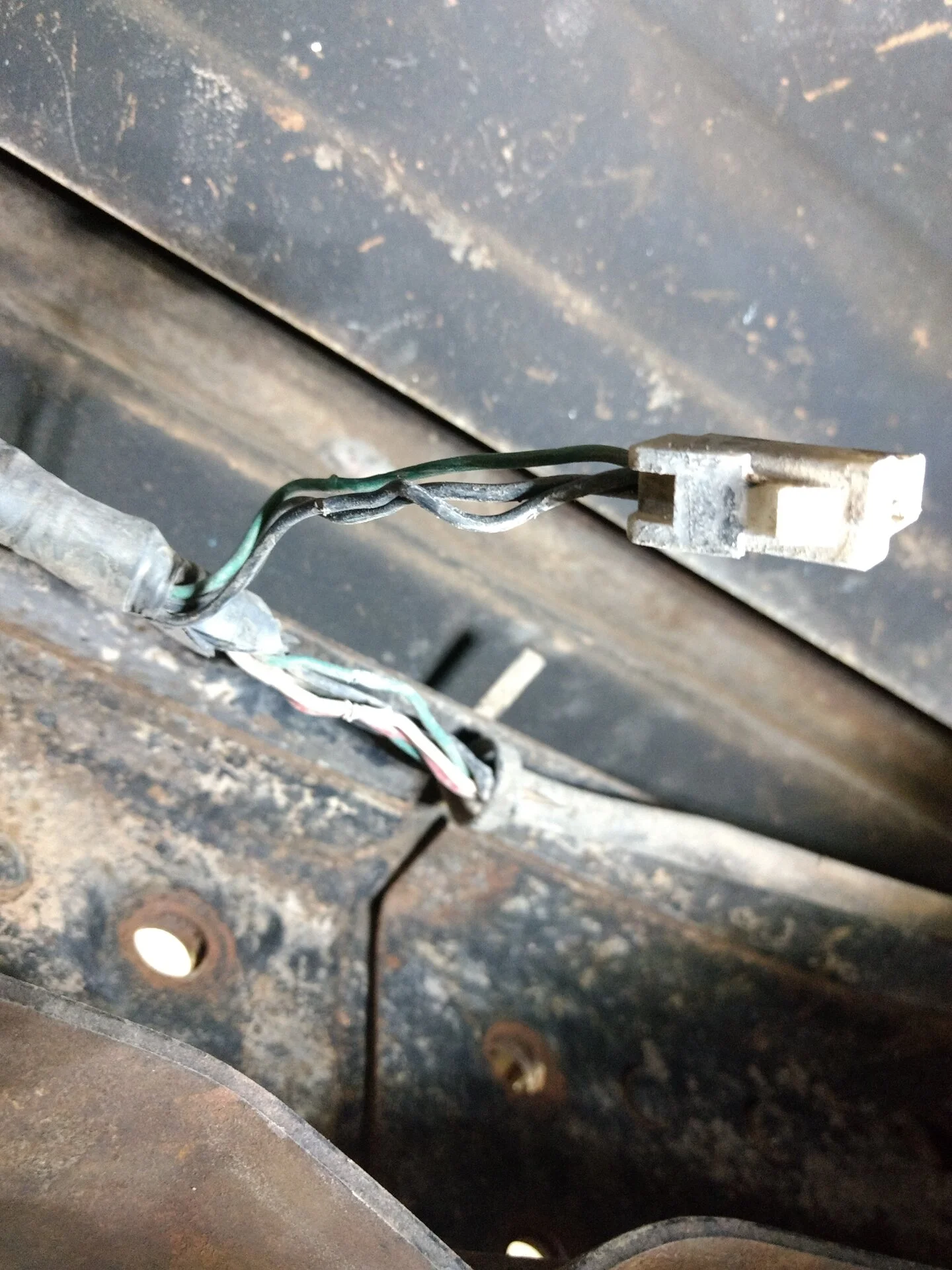

So I pulled the rear wiring harness to clean it up and found an extra plug. It’s in the middle of the rear frame cross member, midway between the tail light pig tails. It is the same style plug as the rear side marker lights and the harness appears factory (in the pics I have started to pull the factory wrap). It has a green wire and a black wire. Tested the wires and the green wire has continuity with the green wire on the marker light. The black wire has continuity with ground (white/black). It’s not license plate lights, those come off the harness at the passenger side rear marker light and have bullet connectors. I checked the schematic and didn’t see anything. Any guesses?
Since it is in the middle, is it possible they are for trailer lights?
Hmm, maybe. I did just find this thread where the plug is mentioned.
Pretty sure my 79 has the trailer plug. I know my 10/75 has one.

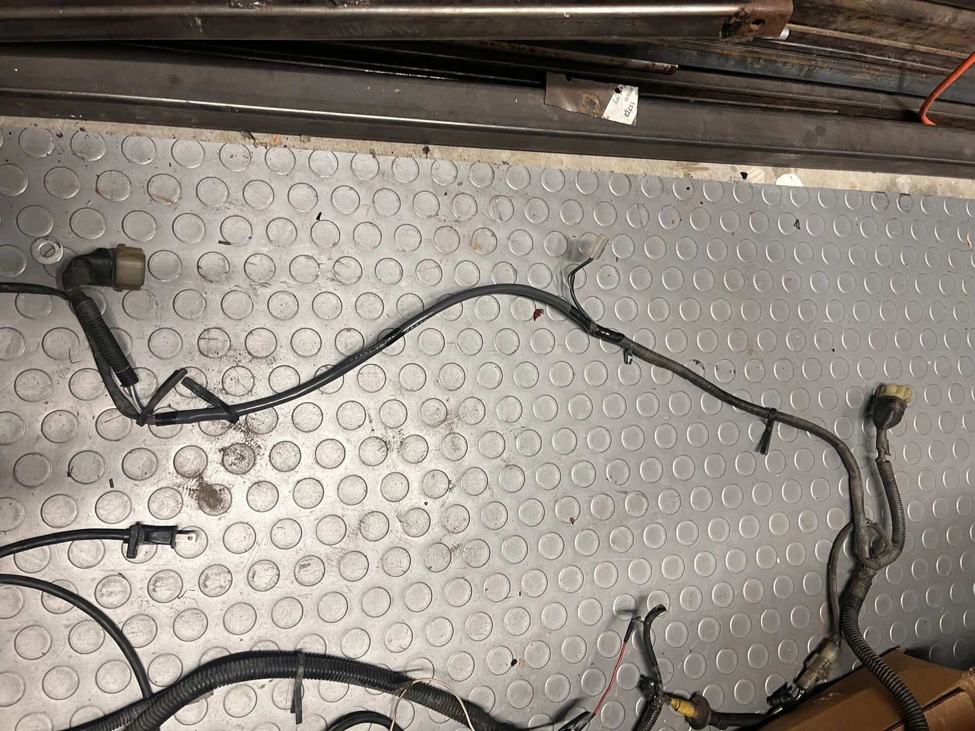

Looking thru old photos appears I cleaned up a PO wiring hacks back in 2019.
While not being used it did have this there not being used.

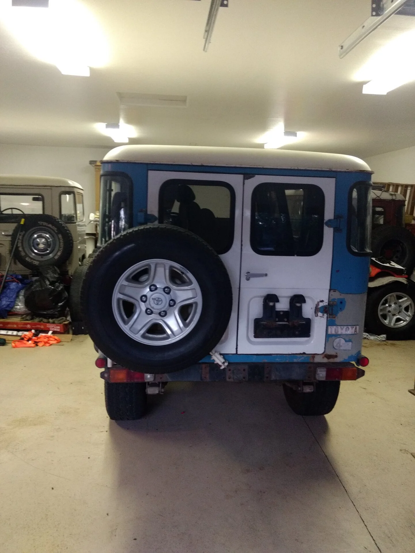

This a a 3/79 FJ40.
