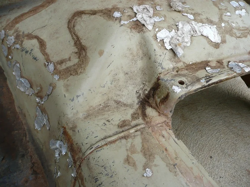

Yes and no. The 1/79-10/82 requires fewer mods and looks closer stock when done. 9/72-1/79 while needing more mods the section needed the mods is a separate piece and can be done outside the vehicle. E-9/72 has a channel at the back of the transmission cover the removed for a four speed and the cover was longer. Ideally a 10/82+ floor would need no mods.
Here is what the section in front of the inspection cover looks like starting 10/82. Left side is the earlier height. Toyota raised the rest when the five speed started. I know it's been done with less height added.
