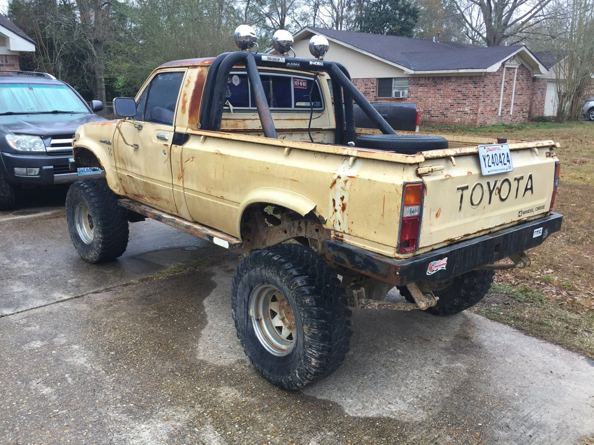

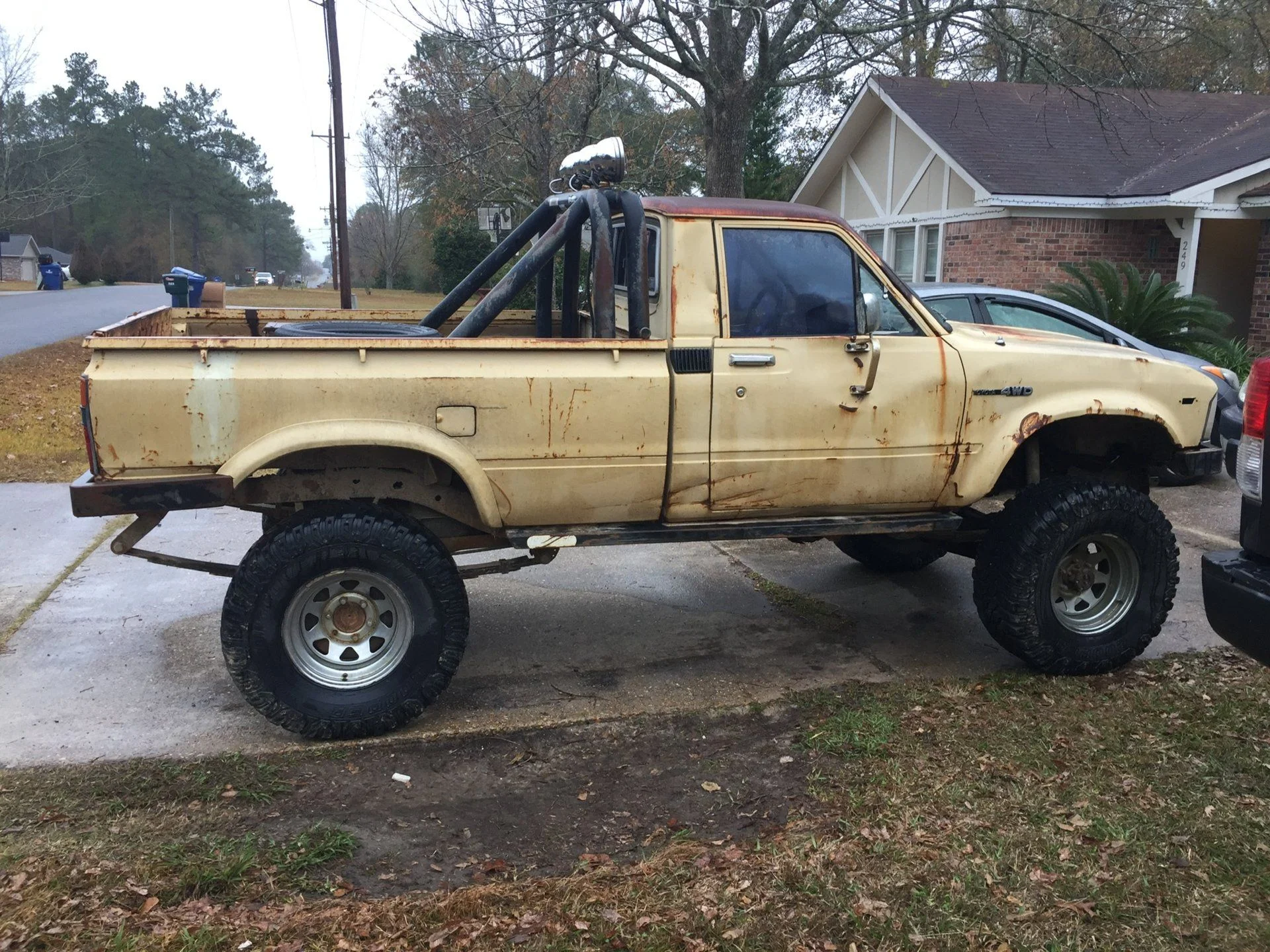

I’m swapping my 1st gen 4Runner for a 1980 pickup with my son. He bought the truck from a forum member and he’s been too busy to do anything with it other than drive it and a little maintenance.
I plan to clean it up and paint it and use it as a backup more mild wheeler and occasional daily driver. I know, patina, but on the East coast, that Southwest scorch will turn to rust.
I would love a source for the driver rear fender flair and a dash pad. Any sources? I couldn’t find anything with google. Thank you, this is the truck.

That's a long bed that's been shortened. Come out of AZ?

Yes, it did. There aren’t any in the yards around here...

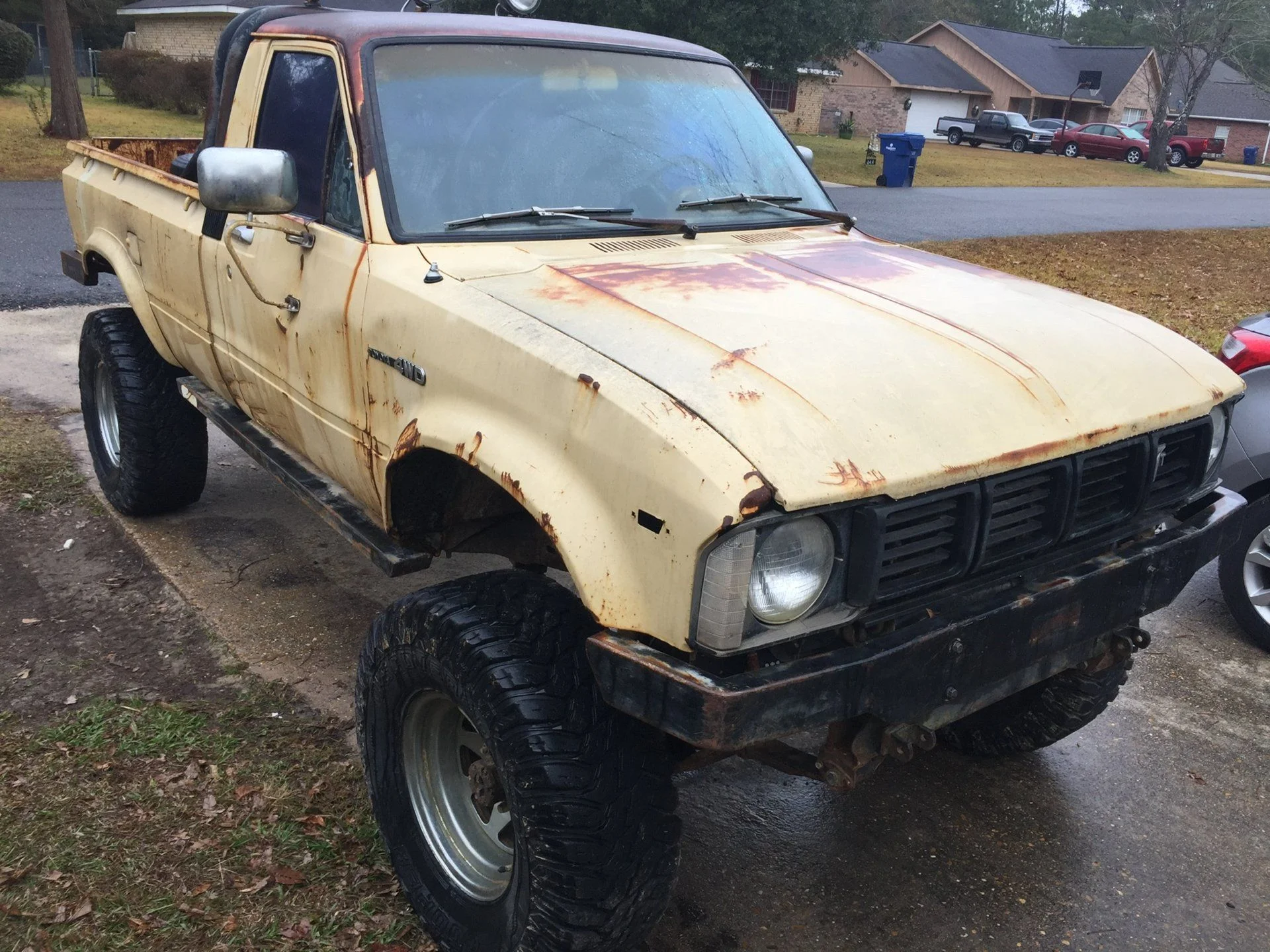

Yup, that's my old rig! That truck was awesome! Always started and wheeled great.
I always loved the patina, but it doesn't look like she's enjoying the weather over there as the surface rust seems to be getting worse. Are you going to paint it the OG color? I'd slap some cheapie front fenders on it so it as the front ones aren't salvageable

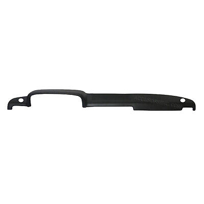

As for the dash pad, I'd just get one of these for the time being and glue it onto the original one. The OG is definitely not repairable with the big hole in the passenger side.
This is the only color I could find with the side vents. I'd get yourself a can of vinyl paint and some adhesive promoter and paint it before you stick it on. Keep a lookout on eBay for an original one - they do pop up from time to time but cost a small fortune.

I think the patina ship has sailed on this one. Don’t feel bad about painting it given the current condition. Once “people” (you know who you are!) have hacked beds/frame etc the whole keep it original thing is done. Just make it yours and enjoy it!

Nope, definitely not going to bed liner anything. Like yotadude520 suggested, I’m going to get some fenders, and paint it the original color. I had an ‘81 the same color from ‘83-‘88. The dash pad is actually available from Toyota, I’ll probably bite the bullet for that. Otherwise, just clean it up a little and drive it.

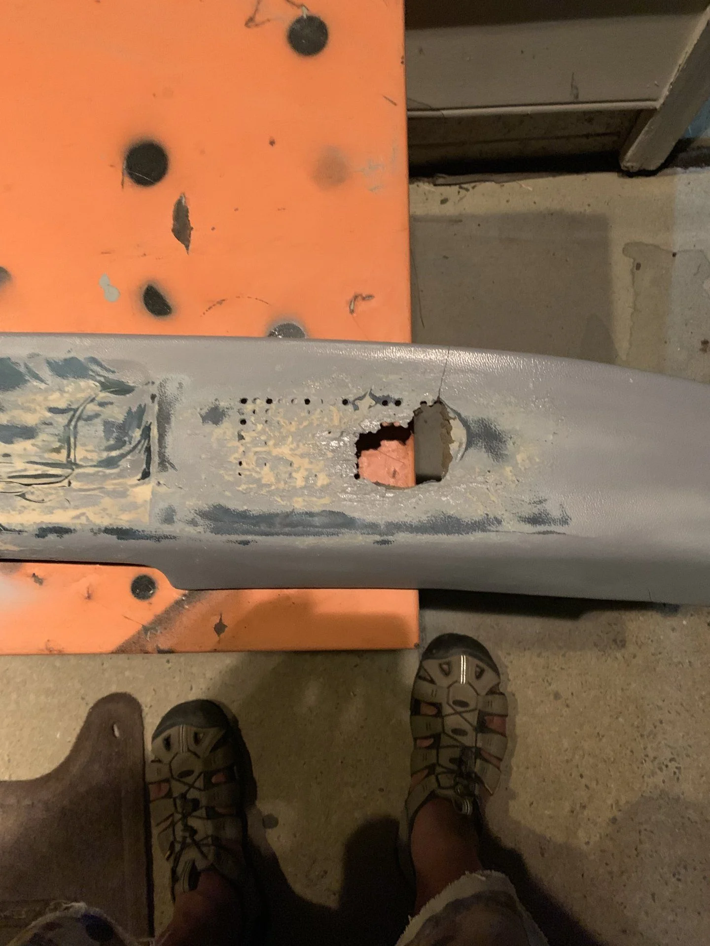

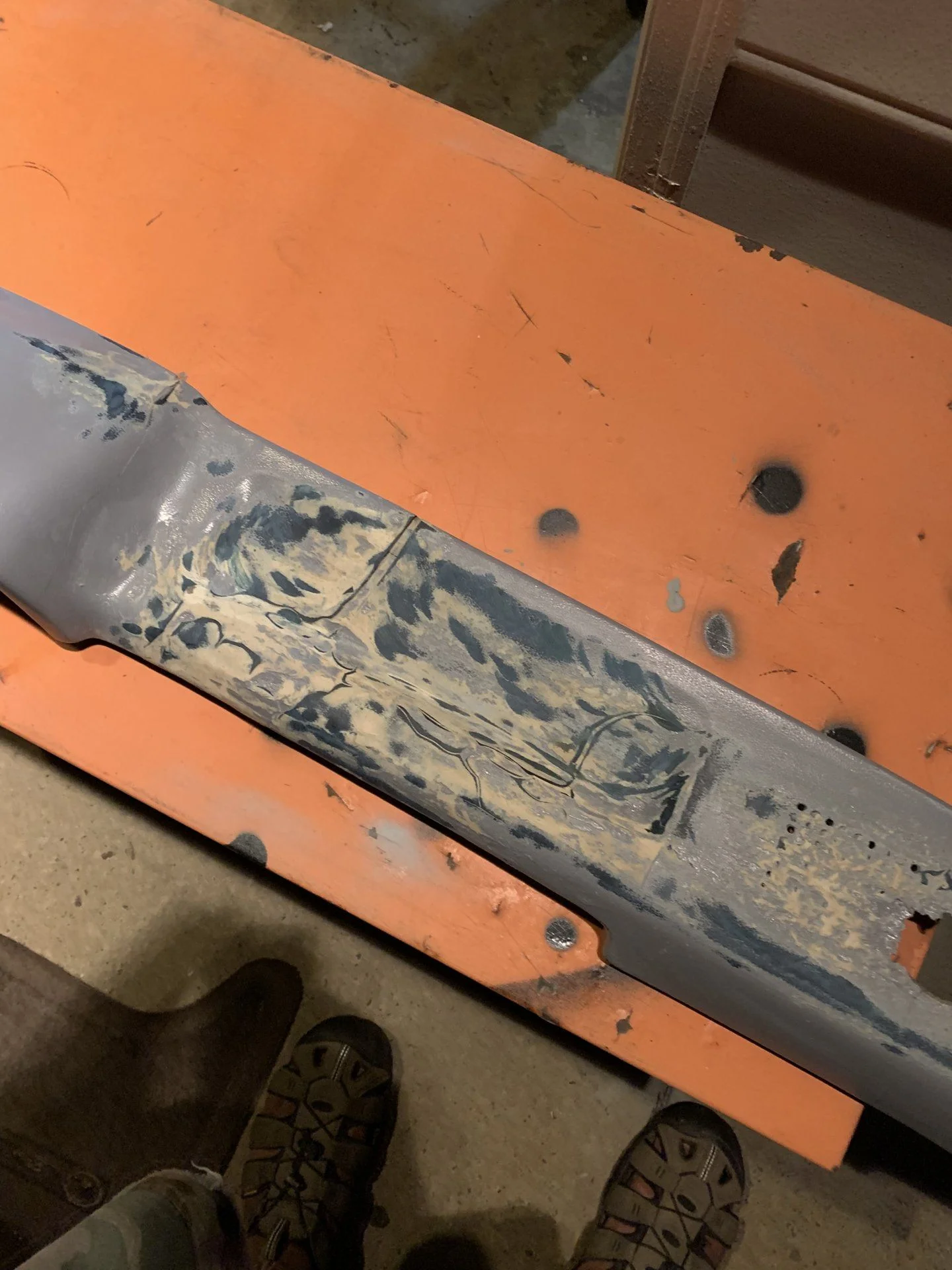

I repaired my dash cap by using liquid nails and tweed. I l already had the liquid nails in the garage and have about $20 worth of tweed material.
my dash wash so bad and crusty that I could not even pull of the dash.
I poured liquid nails over all the bad parts and just caked it on. I spread it out somewhat evenly and left it to dry for a week. It looked horrible. When dry / hardened I was able to take the dash pad out. I simply used a grinder with a flap disk to take the extra liquid nails off. Once it was somewhat level and smooth I sprayed contact cement on it and later the material over it.
you can use any bonding agent instead of liquid nails like bondo or even better bondo with fiberglass in it,liquid nails is just what I had in the garage at the time. I used gray tweed because I like the look but u can use vinyl or any material you want and any color you want.
here are some bad pictures I took when I did it
Wow, that is a unique and cheap solution. Well done.
