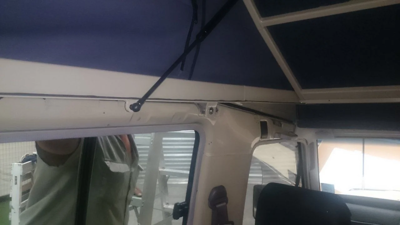

But you will think the tiny layer of metal in the roof serves to "Square out" the rectangular structure, plus cutting the small beams will make the walls of the troopy come in a out..
Do they make Gussets, reinforcement, provisions, tension straps/wires, whatever to account for the lack of structure, for example a convertible is usually heavier than the same car with the roof because it need to be reinforced at the bottom with much heavier materials (think TRellis instead of heavy beam)
Any broken/hard to open windows, funky ripples on the paint, gaps on doors..
Ps: Your truck is my favorite of all of them and with that Pop up, Wowsers, so awesome..
G'day Patineto, the body on the Troopy is not a structural component the same way as the body of a more modern 4x4 is. The Troopy body is, more or less, a "superstructure" built on the chassis. The Alu-Cab flip top maintains the integrity of the body "shape" and rigidity because it has a frame that is bolted and glued into place. The cut is above the gutter line and the main structural components around the windscreen, door pillars and the rear door frame are left undisturbed.
It is pretty much as rigid as it was with the original roof. Sliding windows move freely, the wind up windows are the same, and all of the "shut lines" on the body panels and around the doors are unchanged.
The flip top is all aluminium and weighs about 120 kg, and my guess is that the section of steel roof that was cut off weighed about 50 kg. The overall net extra weight on the top of the Troopy is about the same as adding a roof top tent to a standard vehicle.

G'Day Patineto, I agree, any box will flex without cross bracing. This photo shows the detail of two of the four brackets that are used to bolt the top to the body. The flip top frame is made up of 3 mm aluminium folded into a sort of "box-girder" arrangement - very rigid and very strong for the weight.View attachment 1309967
The "captive nut" is a M8 rivnut set into the body where the former cross members were located.
The brackets are about 5mm thick. Here is a photo of the brackets:View attachment 1309972 View attachment 1309973
It looks very sound, so you truck does have some cross members..
Ps: I'm a Rivnut freak but I will suggest to spot weld some real nuts if is possible for long term reliability, riv-nuts and side loads don't get along that well, specially the aluminum ones....
