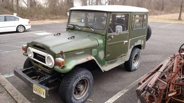

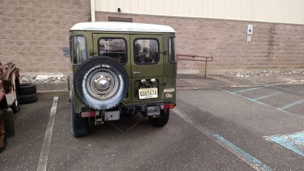

secured my 1978 fj40 today. Brought it home to pa from south jersey, only 44k miles and less rust than I was expecting. Everything work as it should and I'm hoping to get if fixed up and painted by the end of the summer. Enjoy pics!
As for the color I doubt it will stay yellow.
I'm right below the town of stroudsburg pa. Along the deleware

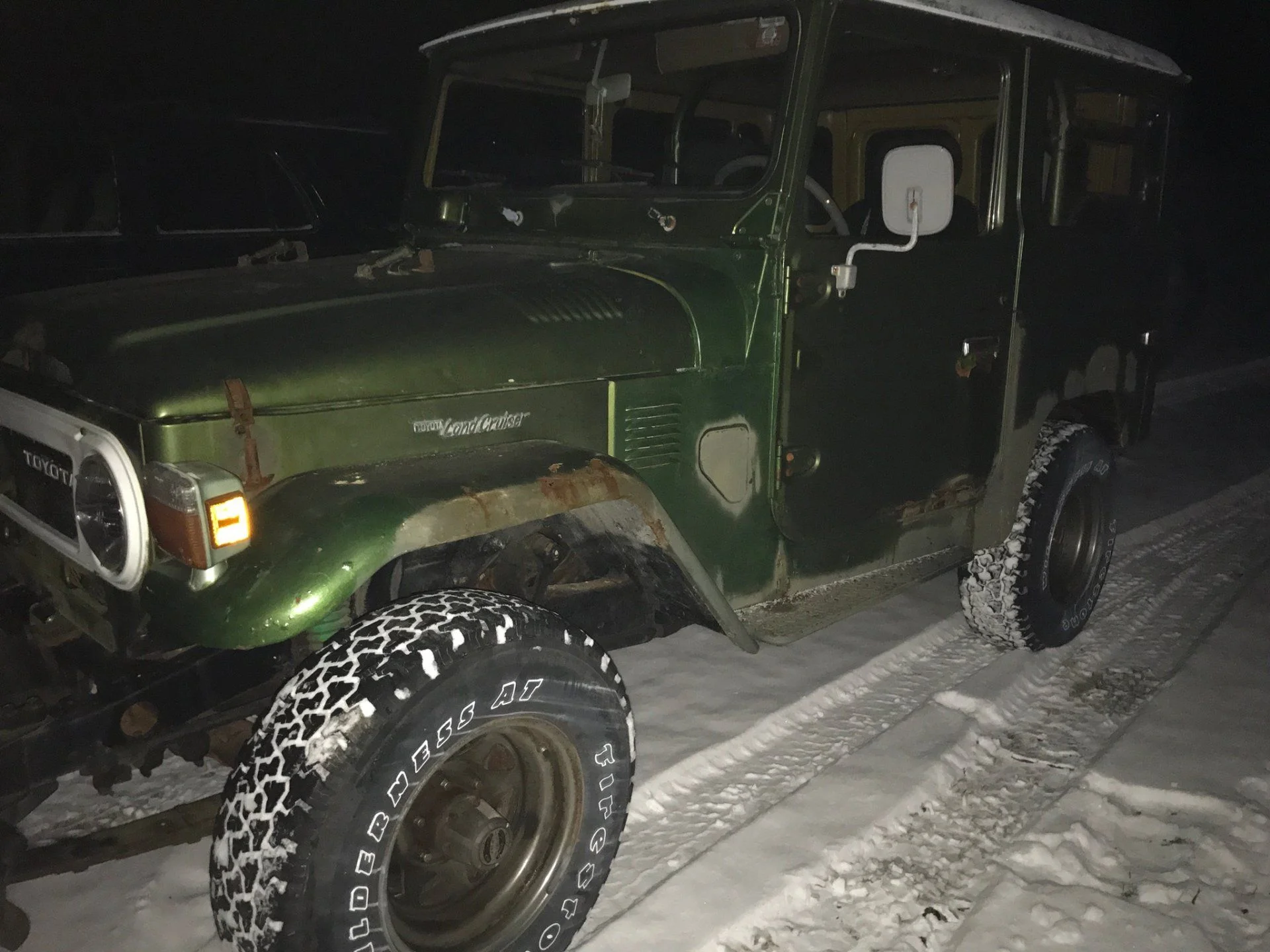

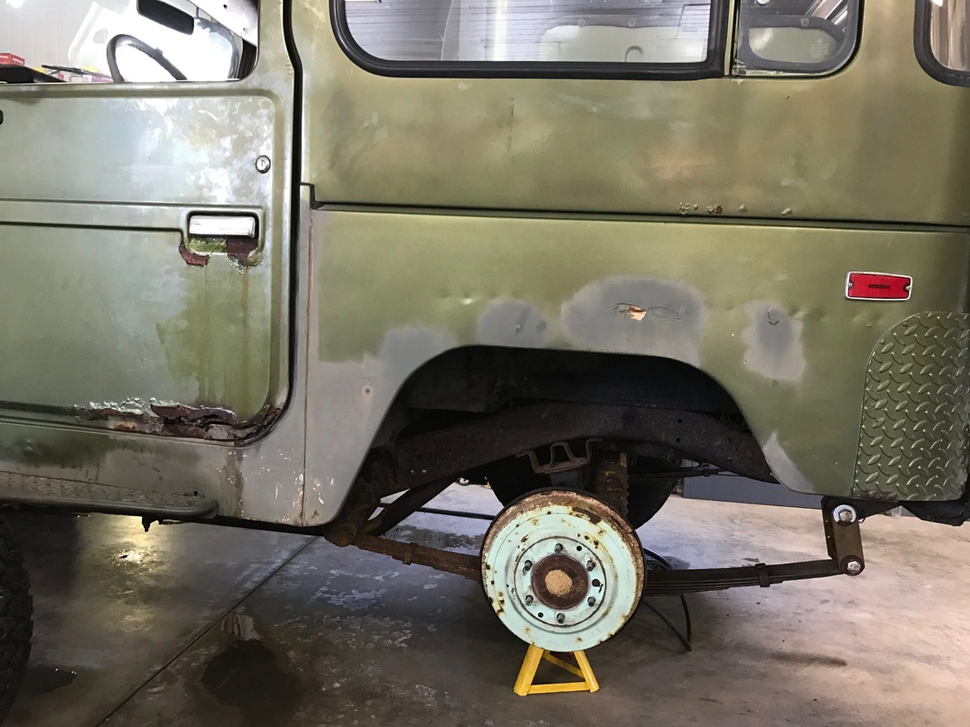

New progress. Dug the fj out of the snow yesterday after it got buried by the big storm. Much to my dismay the 4wd would not work, so after dissassembling the hubs and cleaning / relubing I was on to the rear breaks. I went with new centric brand wheel cylinders. The old one were frozen fast. The drums came off eventually with the aide of a hammer and chisel, no surprise since the fj Hadn't moved for 10 years prior. Wheels spun nice and free when the task was accomplished however once it was on the ground something is still sticking hard in reverse. I didn't get a chance to bleed or Adjust anything yet however I suspect the parking break. That will be a project for another day, as well as a new slave cylinder that is becoming increasingly leaky.
On a side note why the drums are painted the sea foam- color they are is beyond me but painting was not in the time budget the last few days

I know you said your rear wheels spin freely. One thing I wondered about is when you added new rear cylinders did you put the tall side of the adjuster ramp on the perimeter. The ramps should slope so that they encourage the shoes remain centered. Long shot but something to double check if you run out if idea's.
I believe FJ40Jim helped JDC1 on his build thread on the ramp issue
yes ramps are sloping in, luckily I read the thread your speaking of while my drums were still off. I believe its narrowed down to transmission, it will roll with trans in neutral, with trans in gear and transfer in neutral, but not with trans in gear clutch in, tested with vehicle running
