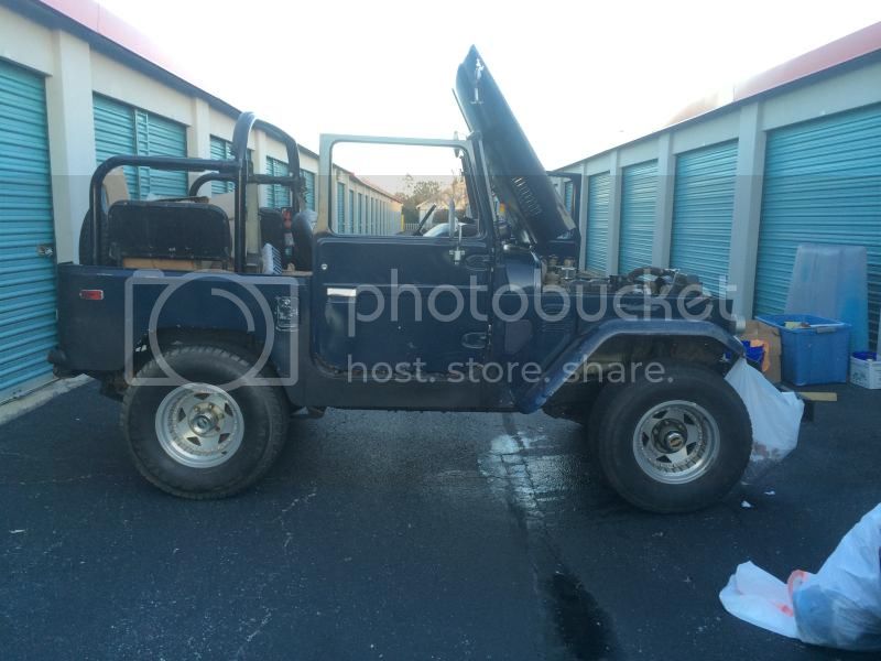

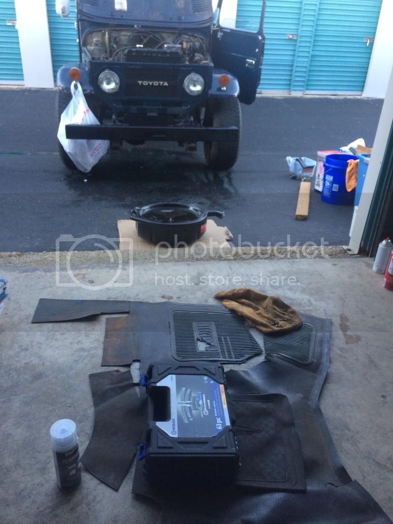

I was able to spend some time today away from work and mess around alittle. I changed the pcv valve and grommet I was kinda surprised the old one was made in USA, it didn't seem to be functioning and I couldn't hear anything move when I shook it. The old rubber seal was like a hard plastic glued in place after all the years it had been on there. I had to spend thirty minutes taking it off slowly so I wouldn't drop pieces that broke off back in the engine.
I also changed the oil and put in an STP oil treatment that says adds zddp, I found at a Walmart so I hope it's good. Used the available toyota filter and a new oil plug and gasket from Beno.
I sprayed more penetrant oil to hopefully make things easier next time I go. Im still concerned the thermostat housing will be a major pain with one bolt already broken. I think that may be put off until the summer, I don't want to try and unbolt everything from the block and break a bolt and have no way to move the cruiser back inside the storage unit. It will give me time to find a heat source to give the bolts some help unseizing.
Being new to working on vehicles I couldn't find a way for the little gasket that comes with the filter to go on, is that a bad thing?
The motor oddly seemed to idle alittle rougher after the stuff I did today but as soon as the gas is touched even alittle it is very smooth so I'm thinking if any problem exists it could be fuel with the little sputters at times. What's odd is if I cut the motor off and started again the idle wouldn't be as rough.
I hope the storage unit doesn't notice I spilt some oil. I cleaned with simple green and brake parts cleaner to get rid of the spills.

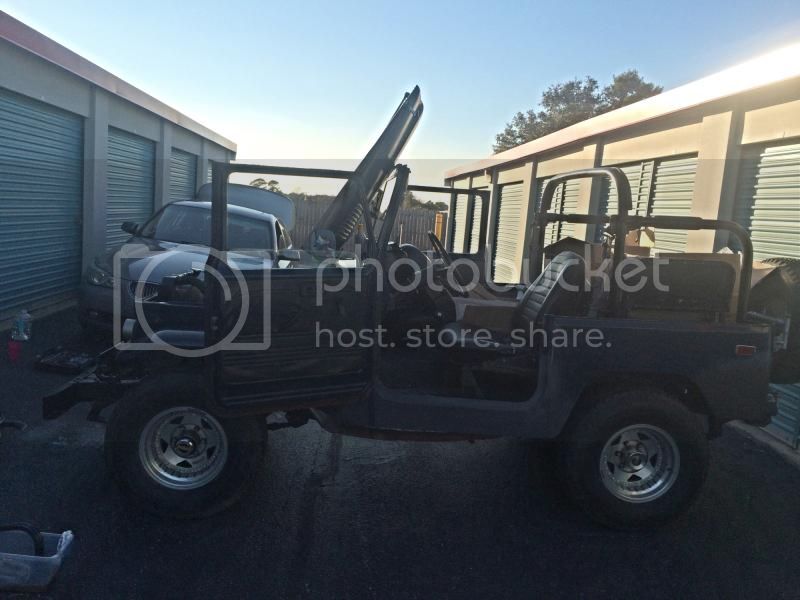

Since I have always wanted a project Toyota 4x4 as long as I could remember I somewhat put the cart before the horse or in this case the cruiser before the garage.
I have to keep it at the storage unit for the time being as the house it would normally be parked at is being remodeled and I don't want to show people where a my 40 is parked. But once the spring gets here I should have the driveway back and can do bigger things like the tie rods, coolant flush, axle service and the brakes. I'm eyeing those nice brake lines a member makes but I gotta slow down on the cruiser spending for a long while. Maybe Xmas present haha
I always like looking back at old pictures and what's changed.
