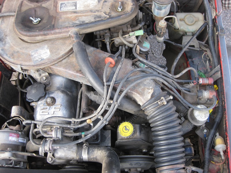

Great thread, still need to identify that down facing port on the front of my '78 OEM Carb and what to do with it as I am desmogged.

TLS, The downward facing port off the bottom of the HIC should be connected to a fitting on the side of the carb insulator baseplate, next to the hose from canister purge VCV.

Jim I only have one fitting there and it is connected to VCV, I can post a pic..............
