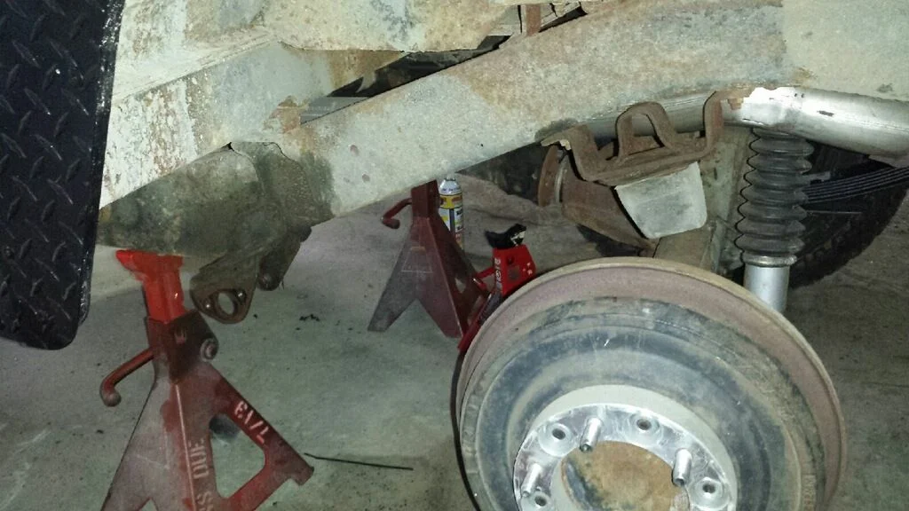

Finishing up the aft section today...

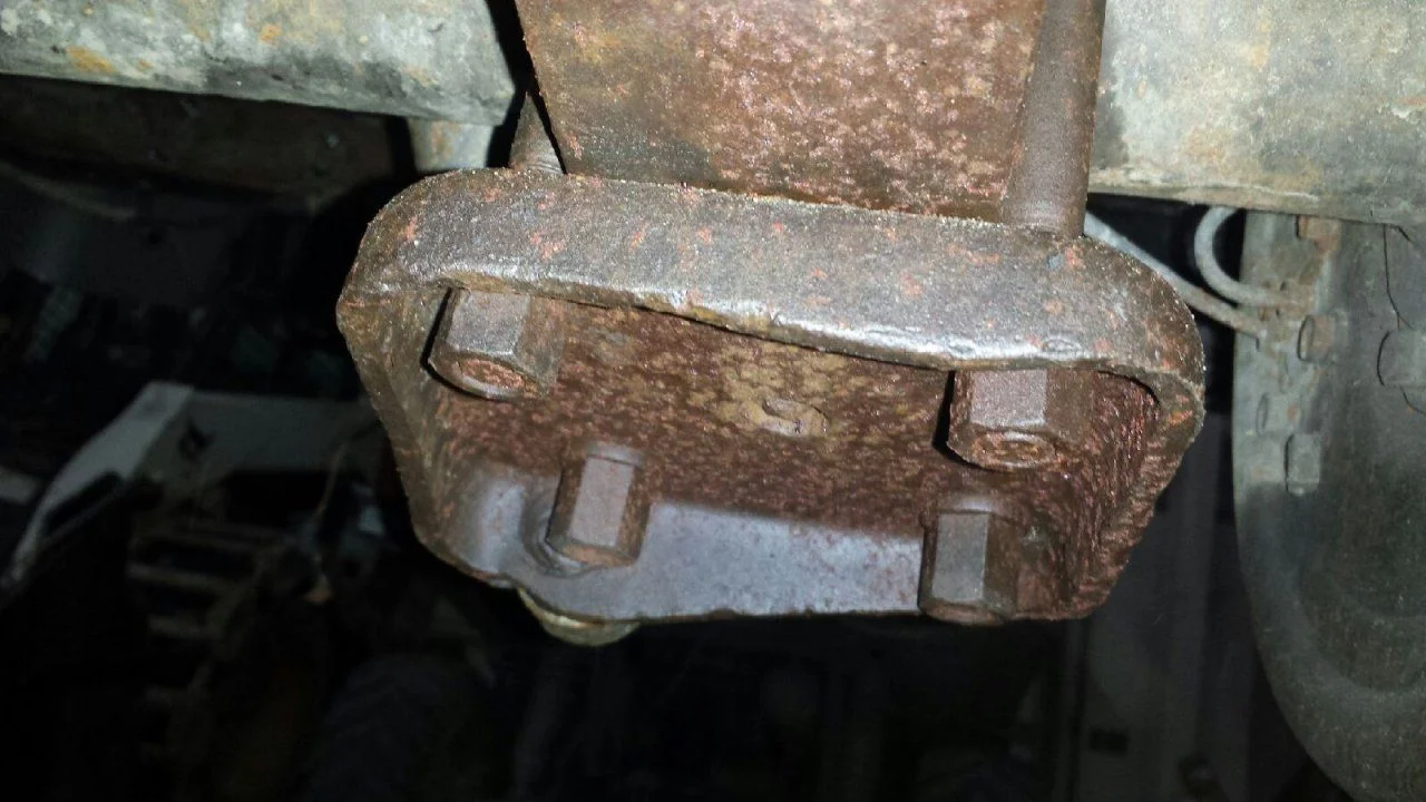

Pre- execution photo's. No real surprises...Other than the rear drivers side shackle, which took some mild persuasion, all the hardware came off without additional effort...

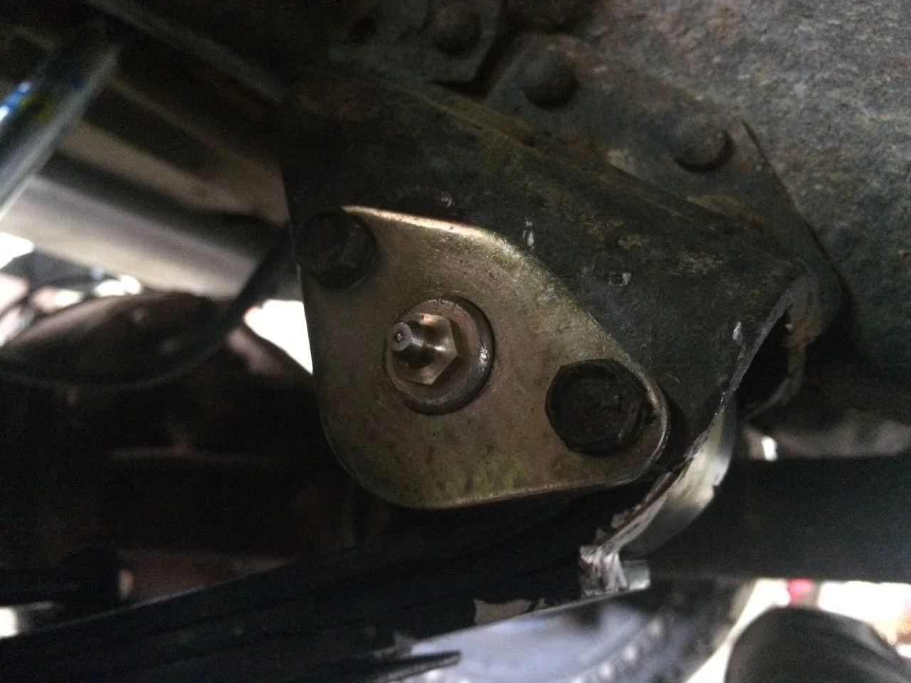

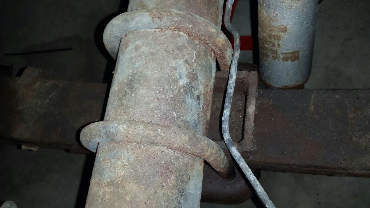

Take a good hard look at all the brake lines while you were there?
I just changed all my lines going to the back... I have been under ... Around... And upside down in the cruiser for the last 25 years and never once did I notice the compression fitting at the long section
Tucked under the frame clip ... Kinda surprised it never let go

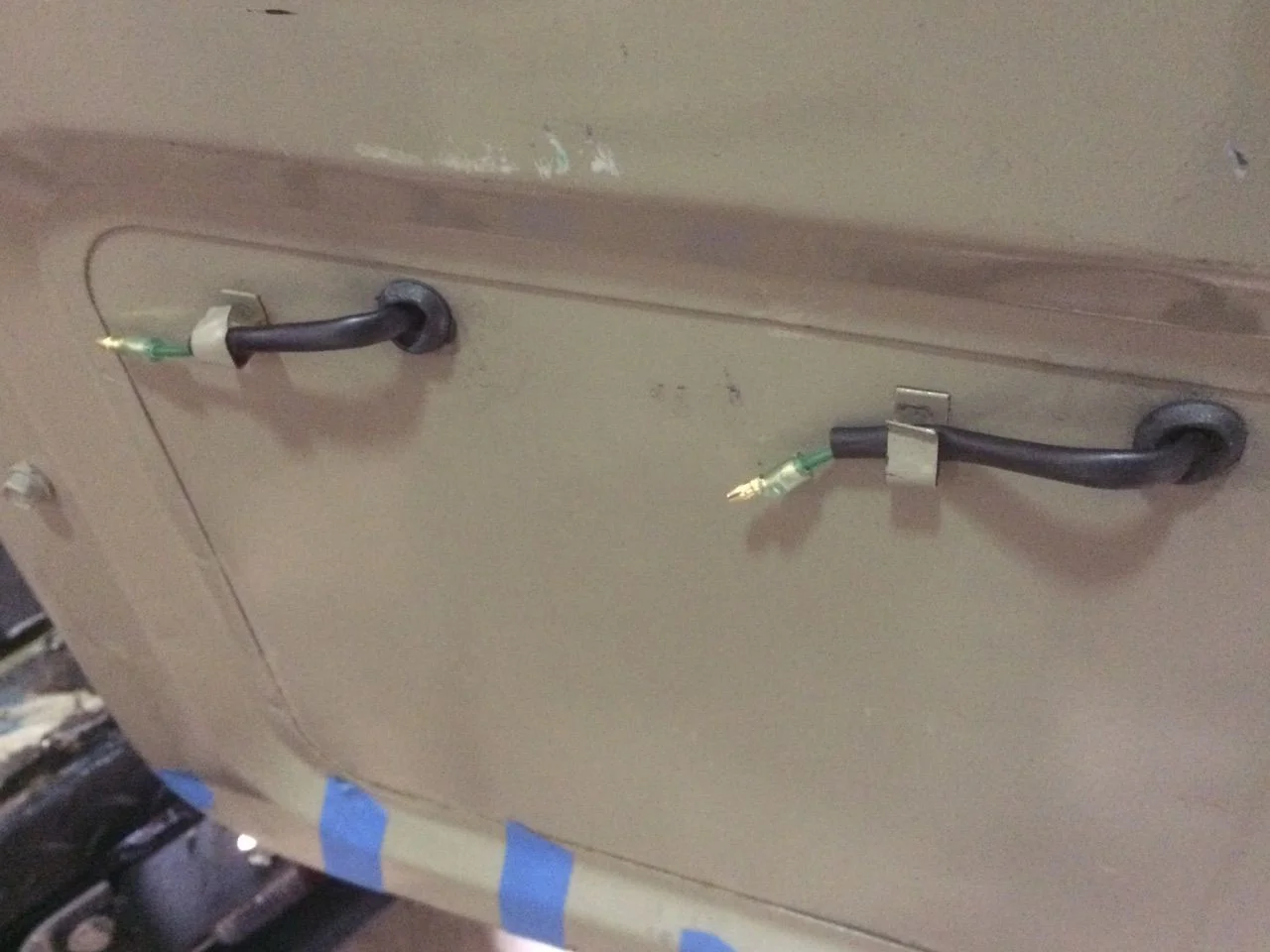

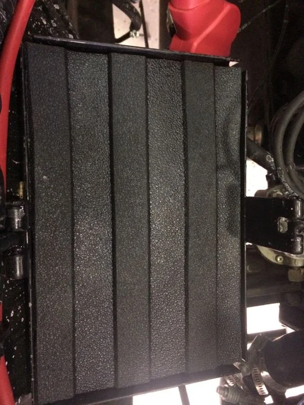

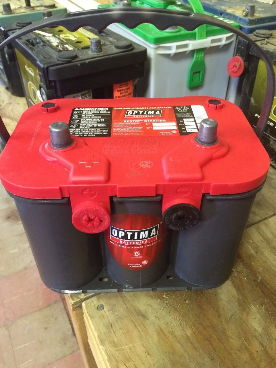

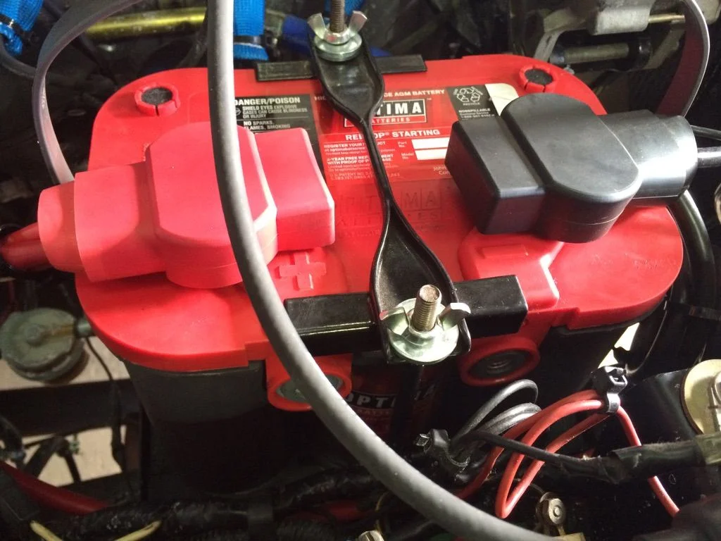

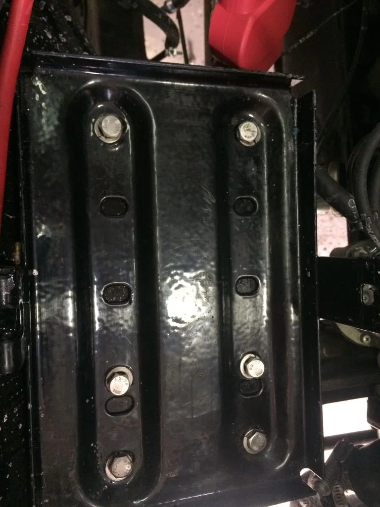

Finishing some small projects today..Bigger things were afoot also. Cut a battery mat from some leftovers. Going back to a "Red-Top" too. Battery was a spare I ended up with in a trade.

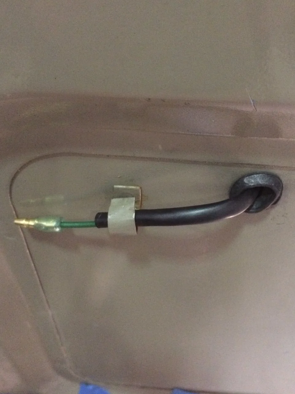

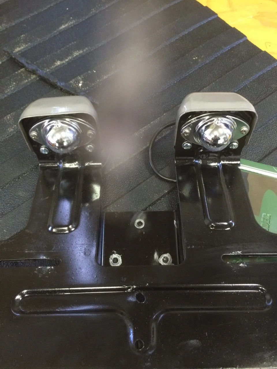

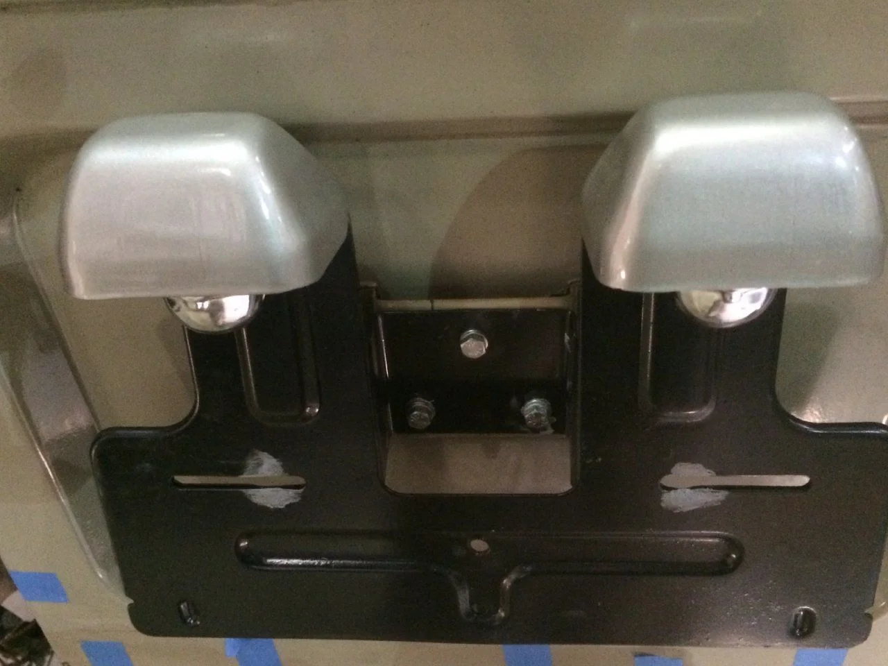

Ran the wire(s) through the rear ambi door. Made the adjustments to the light brackets also...

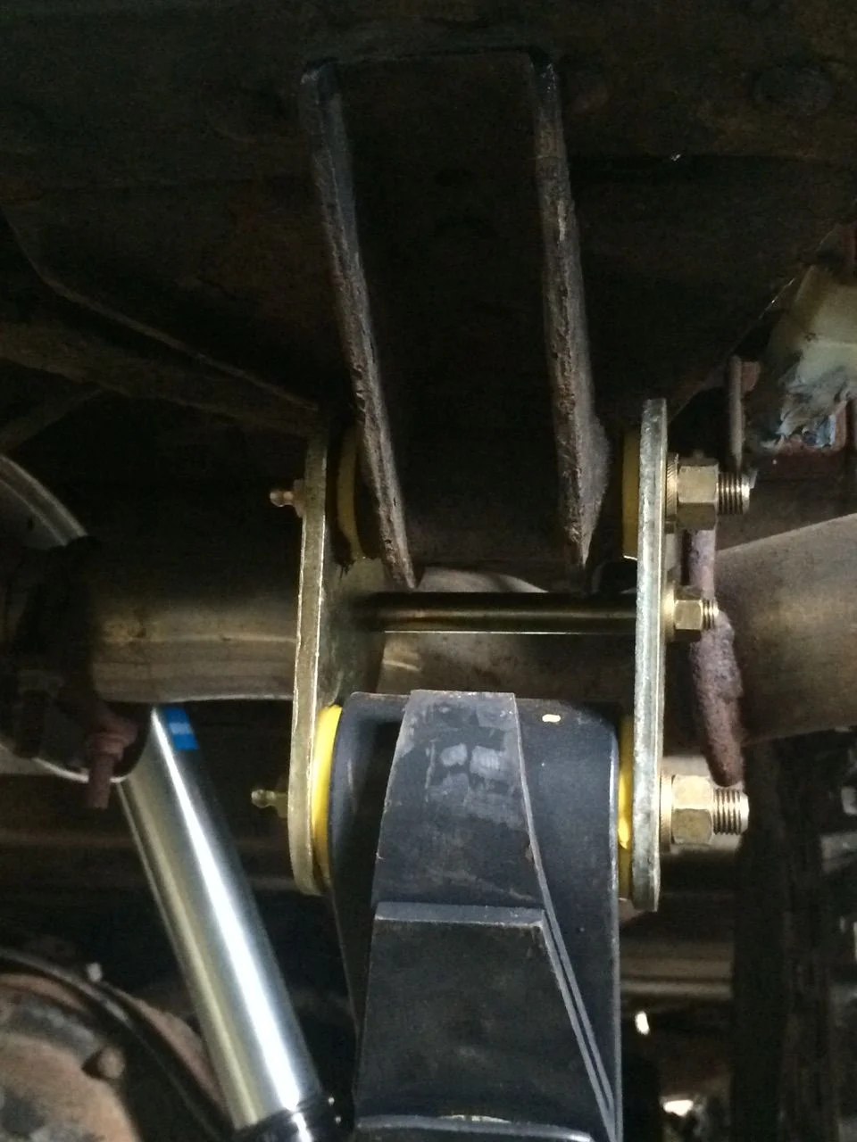

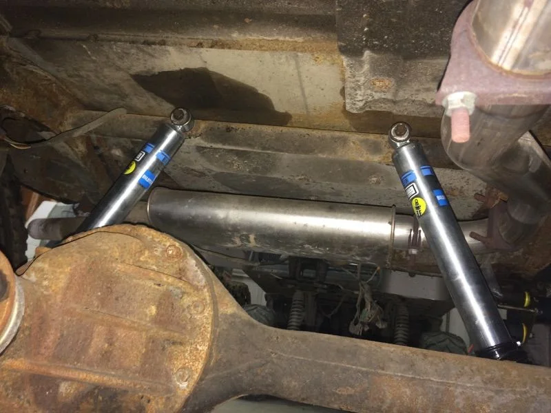

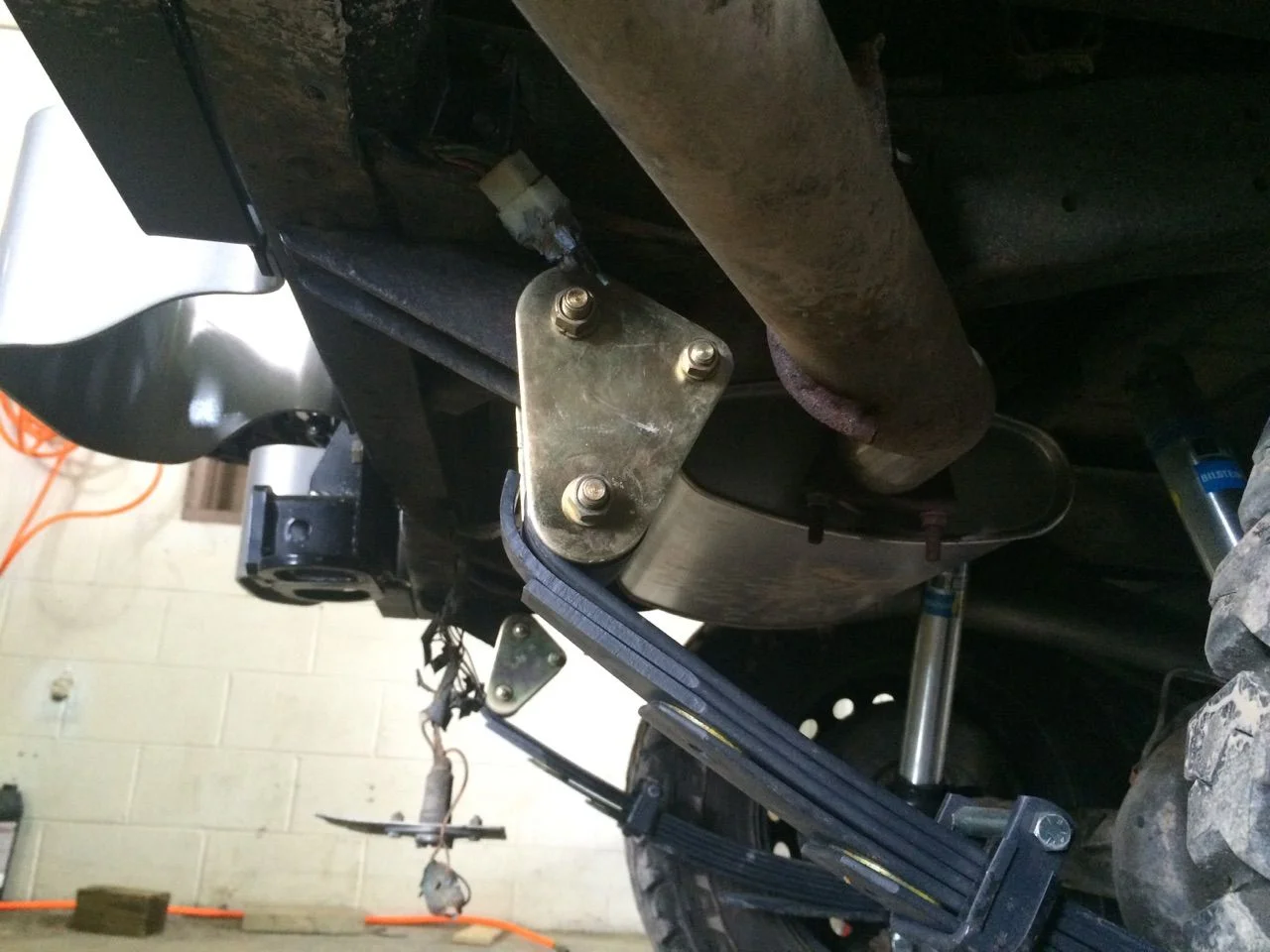

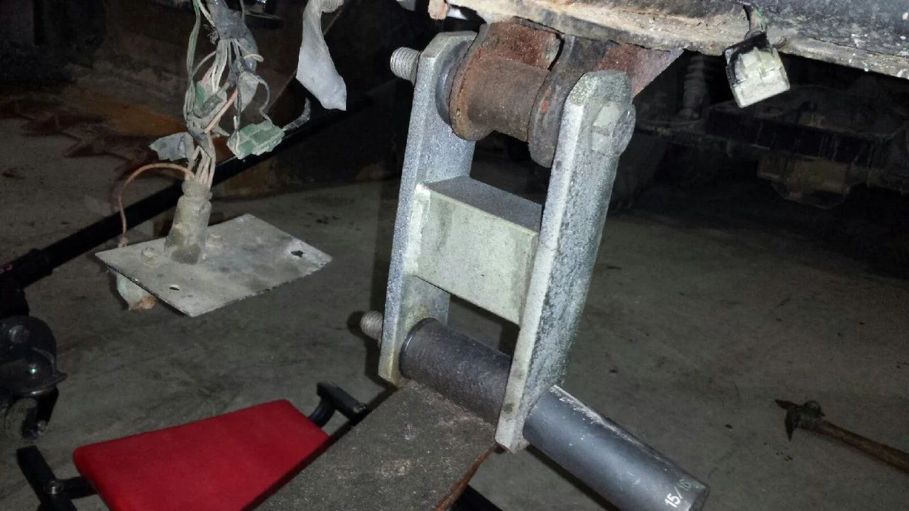

some shots of the Driver/Rear passenger side spring pack, U-bolts, shocks and shackles installed..
Why did you install the rear grease fittings facing inwards? It'll be kinda hard to grease up on all fours.:hillbilly:
