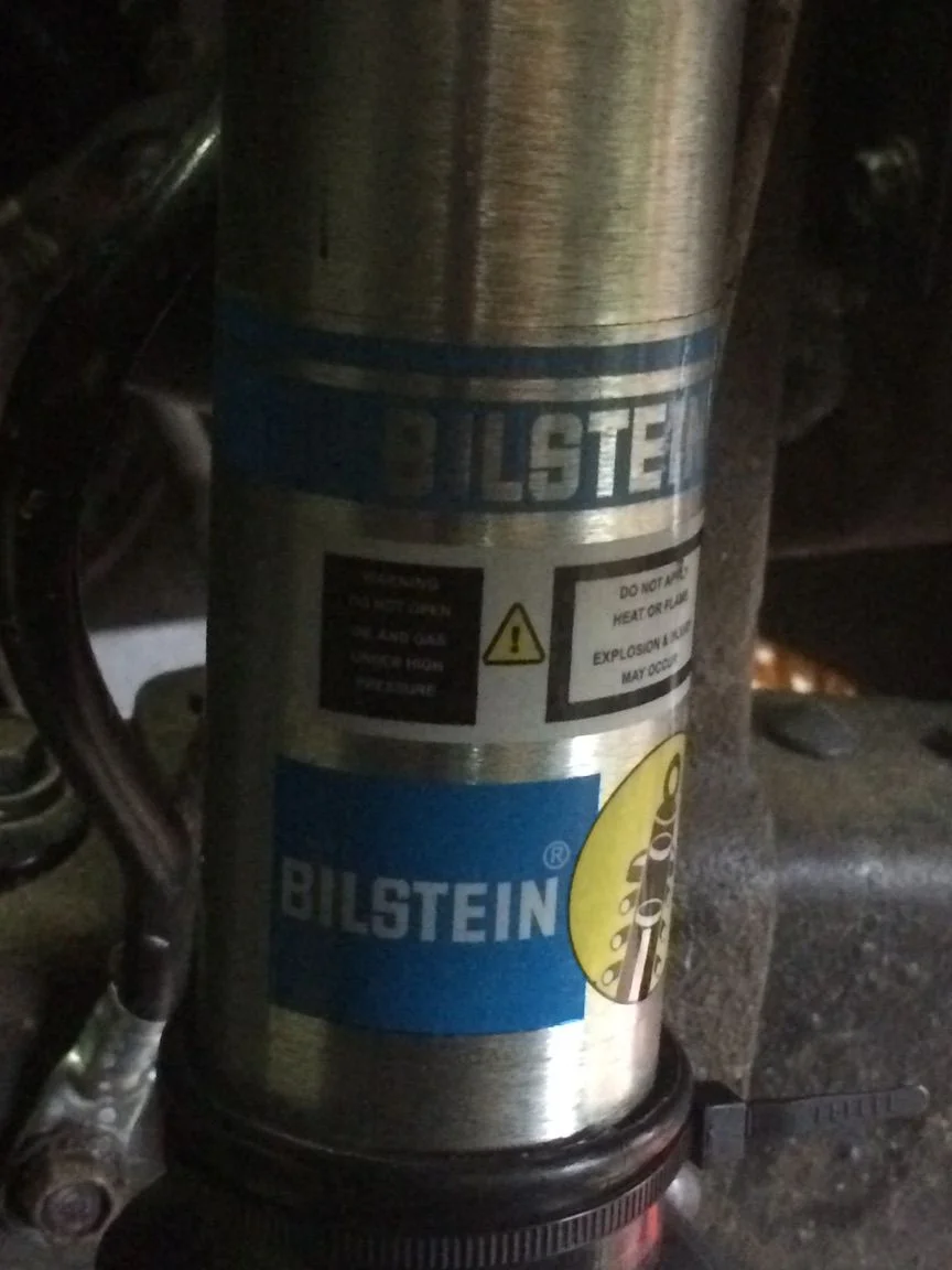

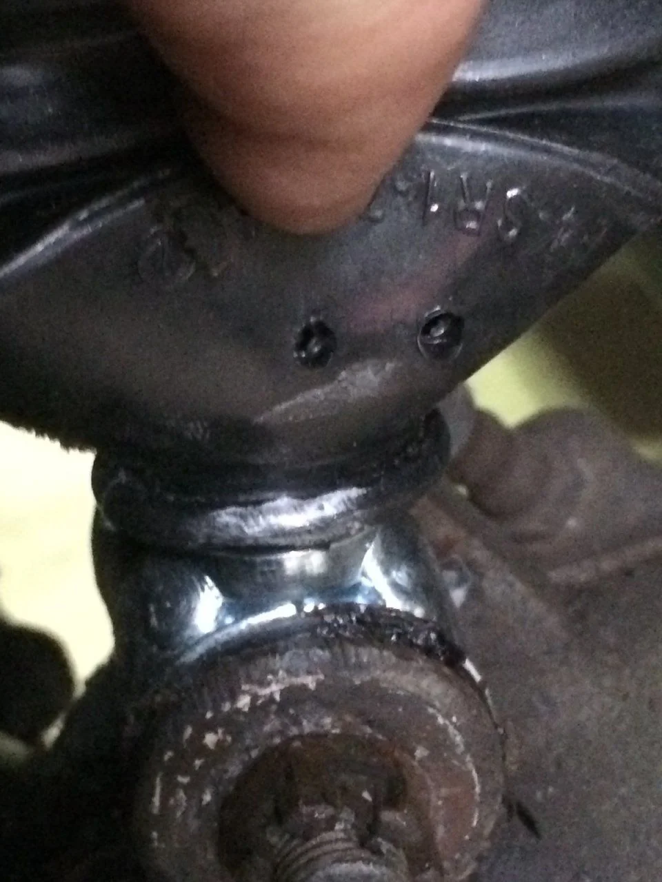

what was the logic (or need) to install them in reverse from that of the previous orientation (with the bellows of the new ones positioned low)?
Late reply..Crazy weekend. I had a late start getting out of the mountains on Friday and hit a wall of snow on my way back to P-burg....But, the FJC on the Coopers never missed a beat...
"On a monotube shock, the piston can be used up and down.Most cases it’s better down, (like on race cars which use monotubes)So Bilstein, KYB engineers and others will do this when it’s better.
You can’t do that on a twin tube low pressure (1960’s tech) design. When the boot is down, Bilstein puts 2 or 3 small holes to let any moisture or condensation to drain out.(those engineers think of everything"
Bilstein’s tech –
Just following up. Note the weep hole(s) at the bottom of the bellows. I'll probably discard them at some point. Also, when in doubt you have to go with the "marketing Dept". Mounted "can up" you can read "Bilstein"..

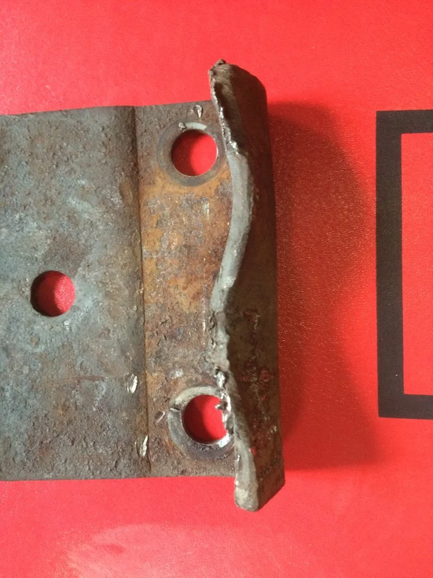

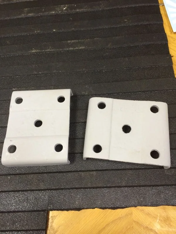

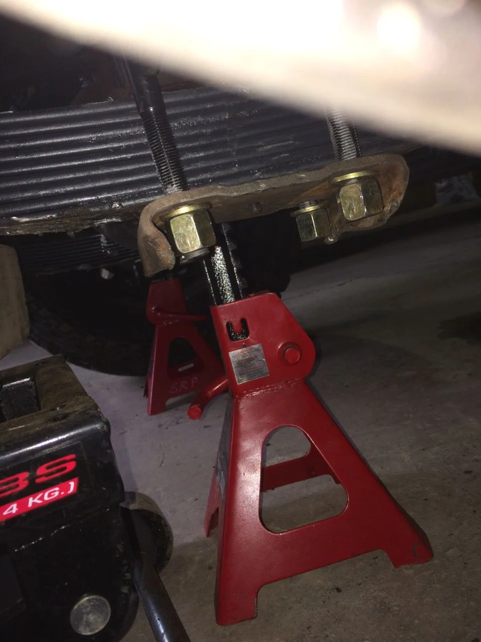

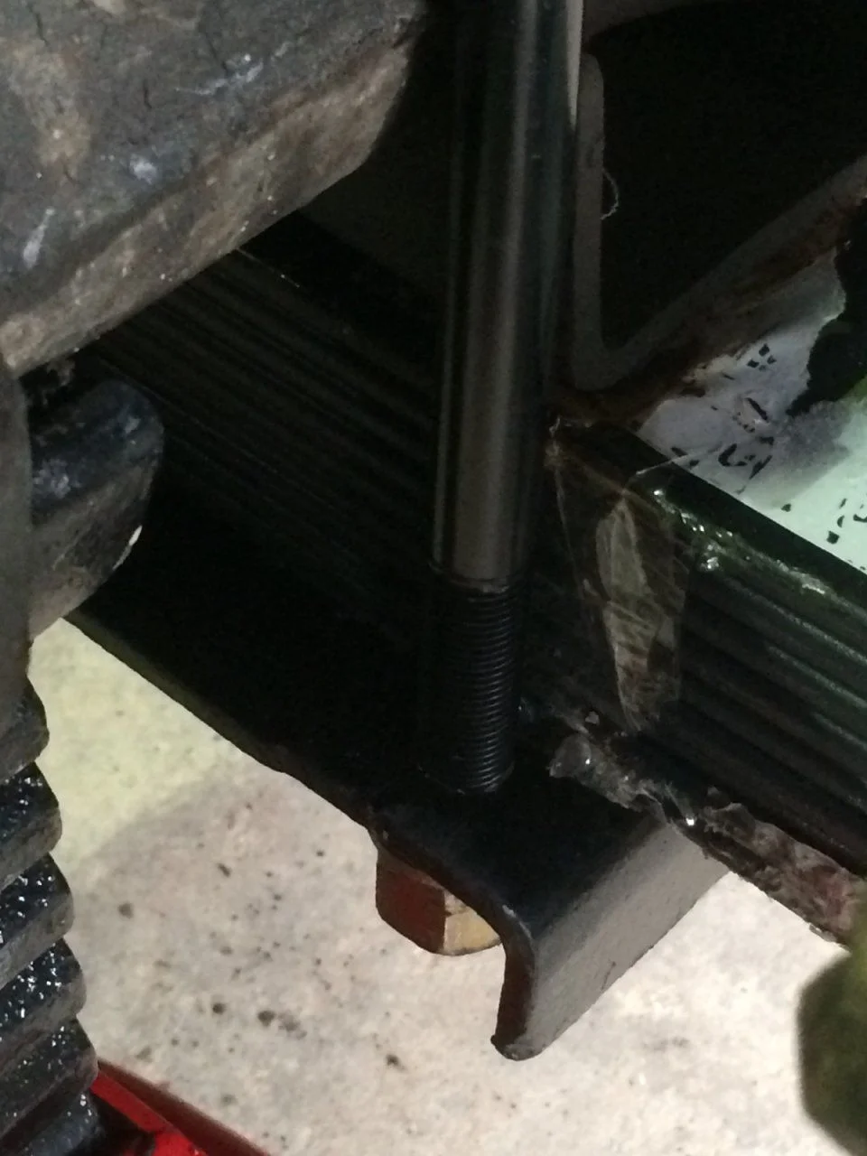

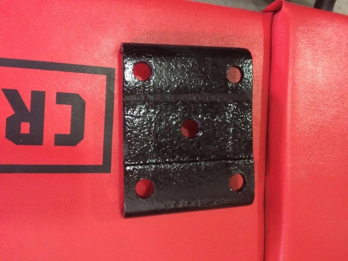

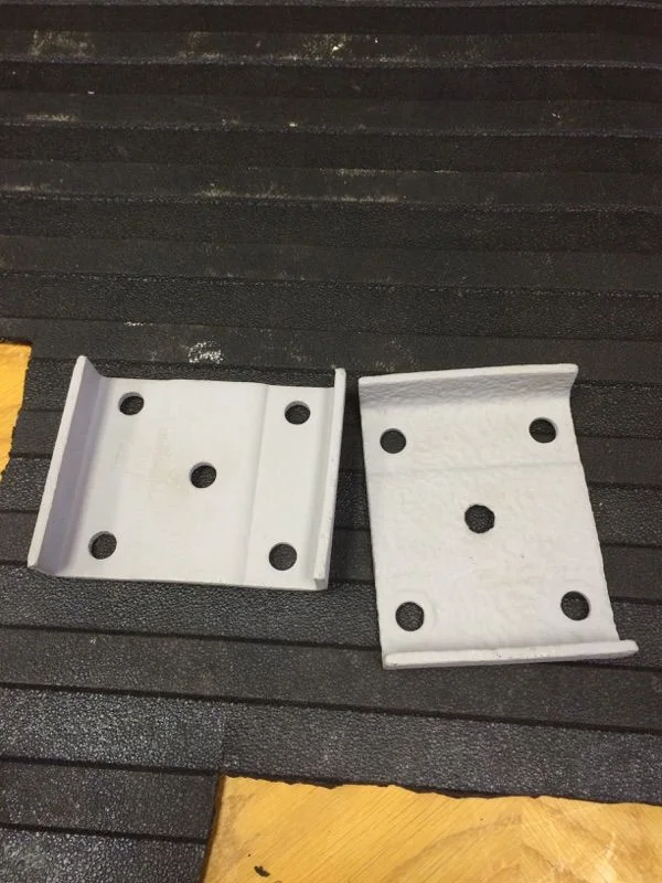

During the front spring pack installation, I discovered the front spring plates were "boogered-up". Found a spare set that looked to be in somewhat better condition (not bent). Came primed. They are a bit pock-marked, but seem to be in serviceable condition and should last me well into the future....
Replaced both spring plates after an epoxy spray..

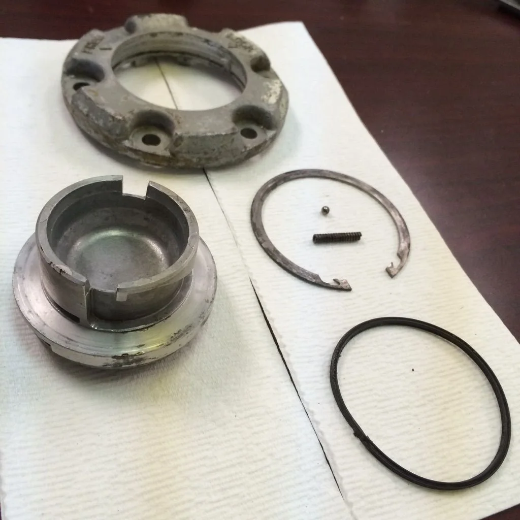

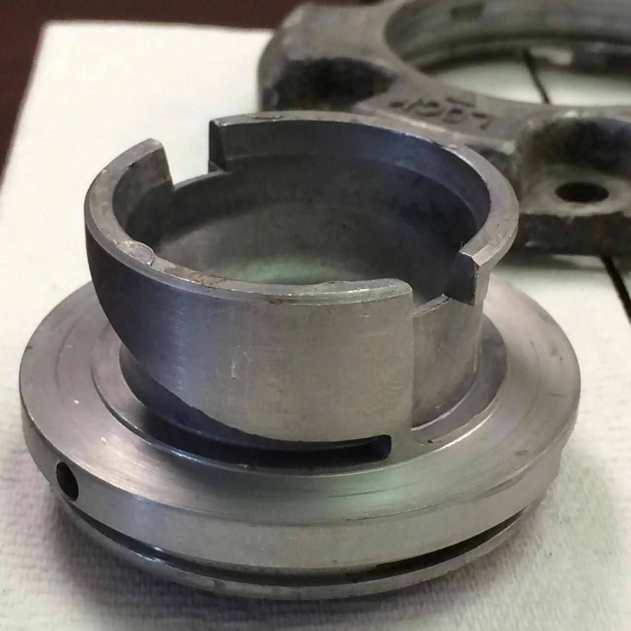

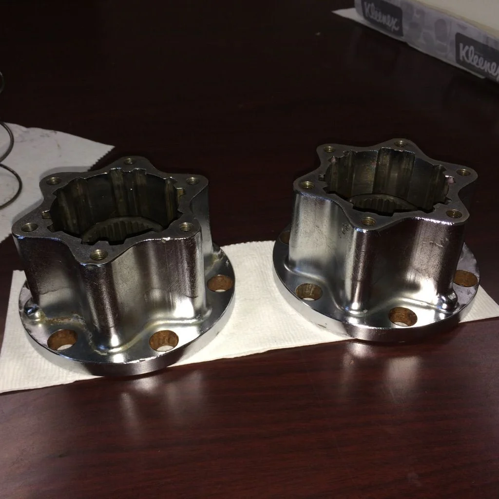

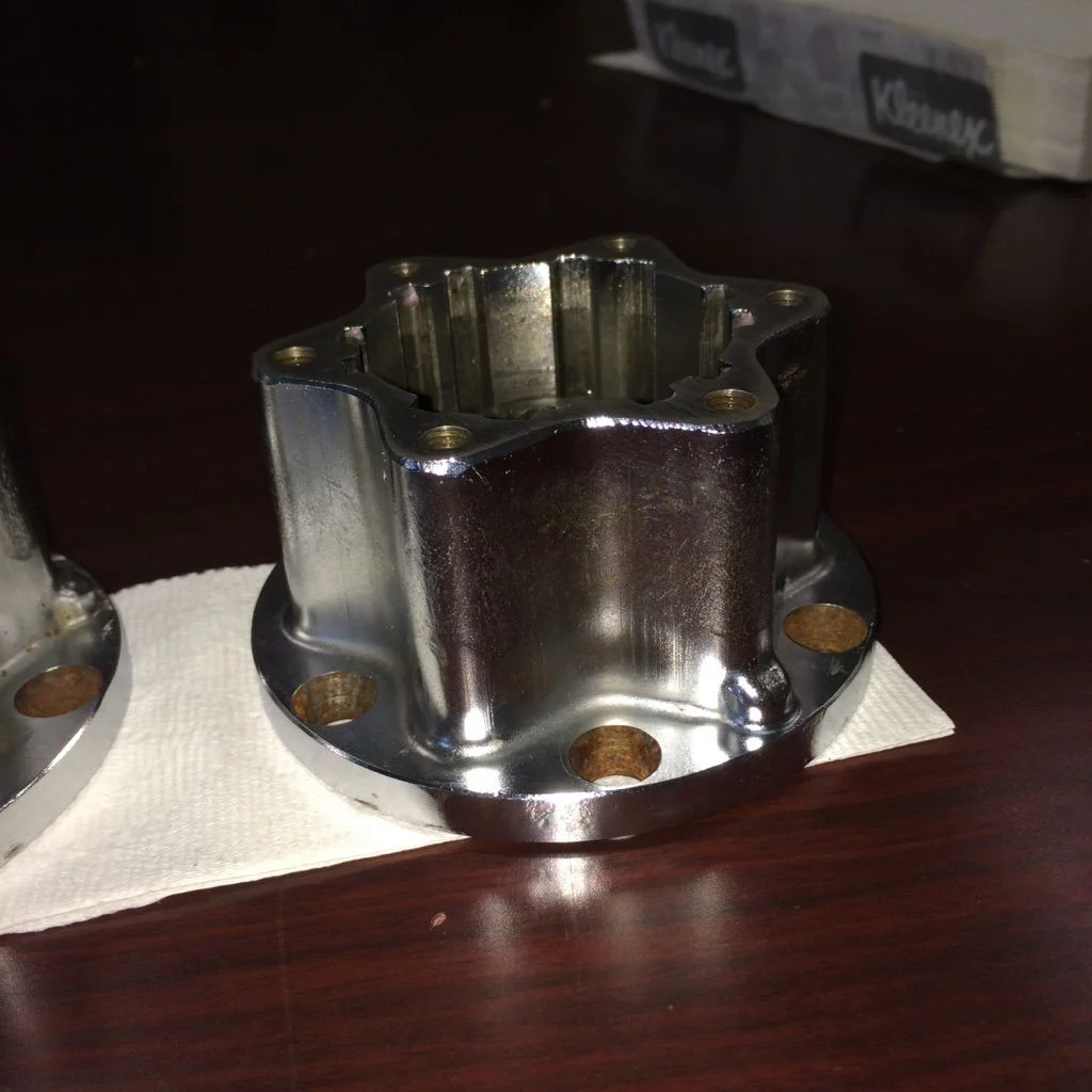

Started the disassembly process on the ASCO hubs. Cleaned the housing assemblies with a little fine steel wool. Spent just a couple of minutes on each to see how things will shape up. I'll run these through the parts washer once I have them completely apart.

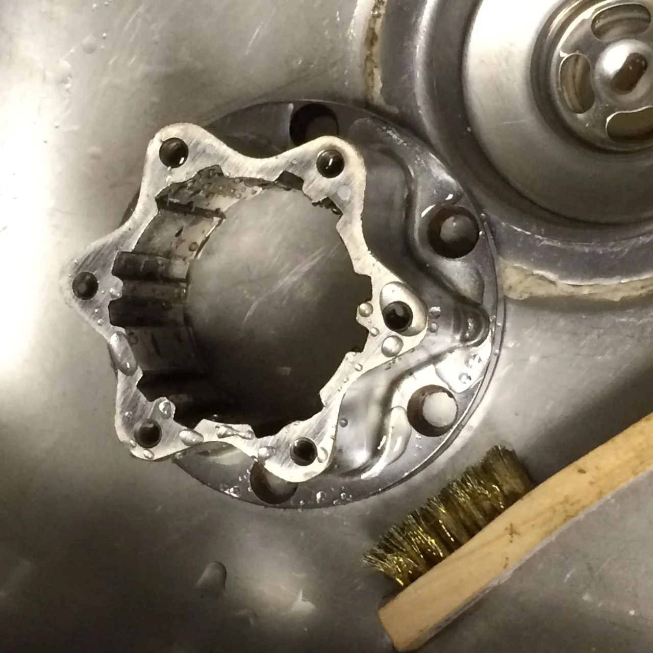

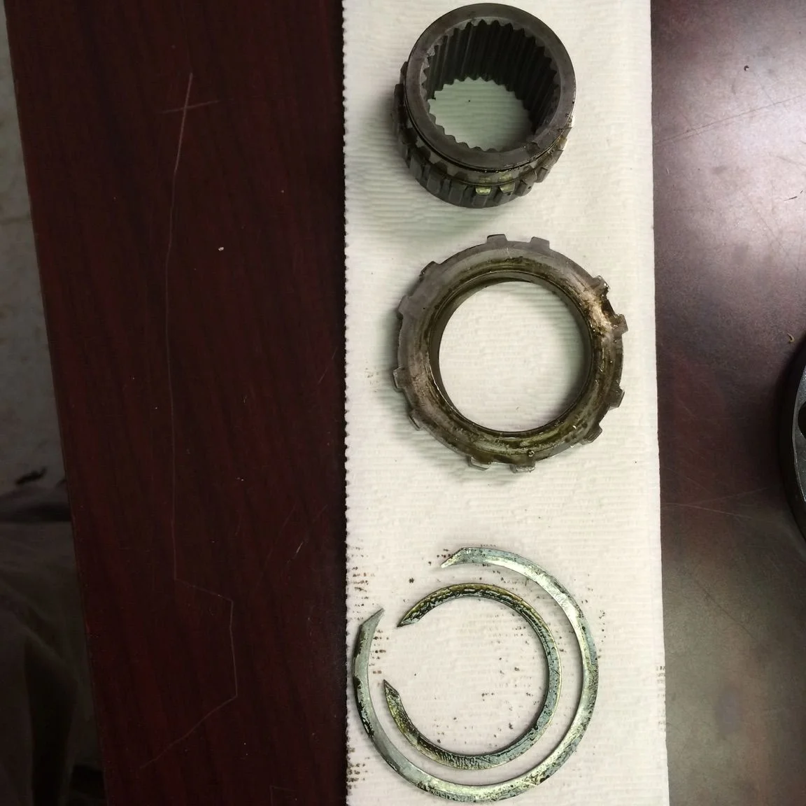

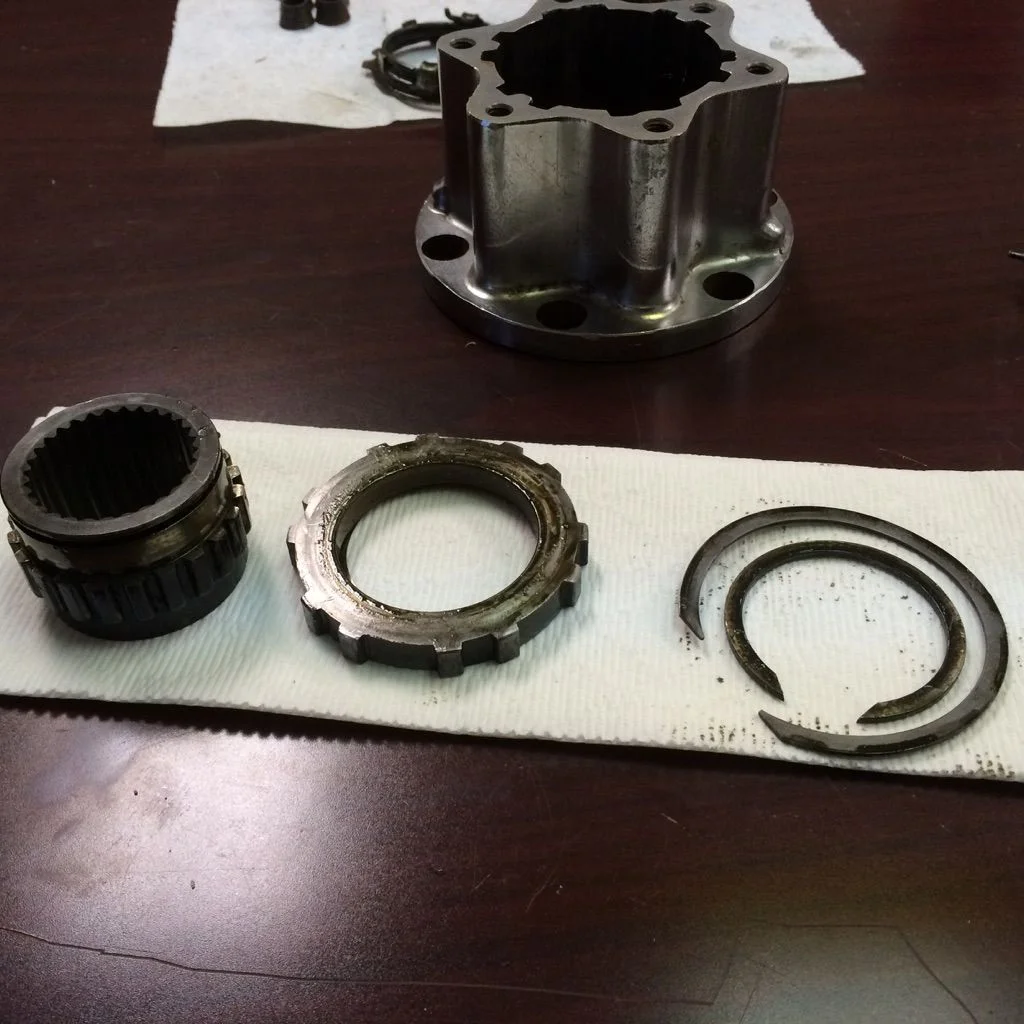

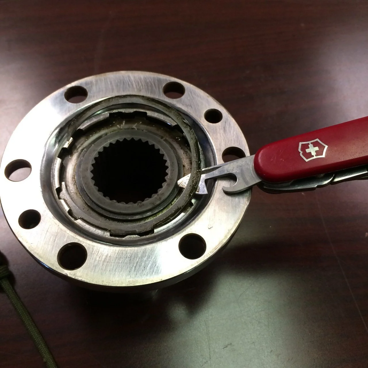

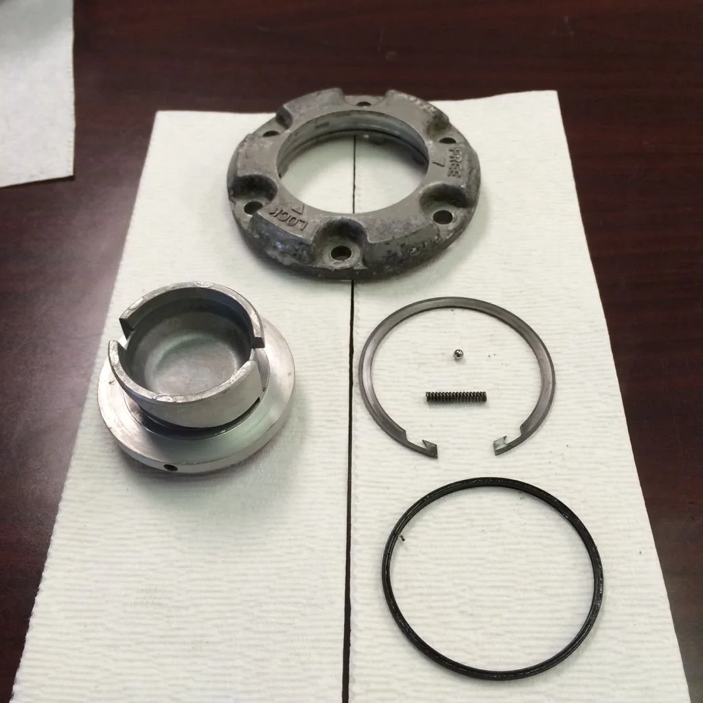

Breaking down the hub body. My Swiss Army Knife has been around along time. Made short work of the outer and inner snap ring. Started cleaning with a soft bristle brass brush and some "Dawn" dish washing liquid.
