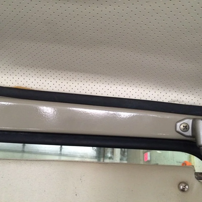

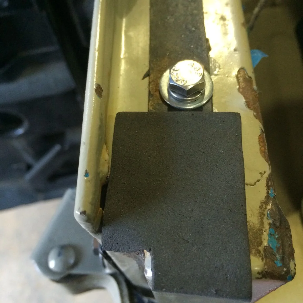

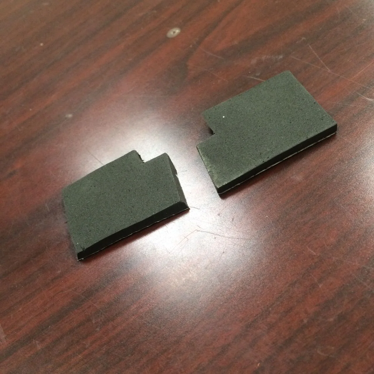

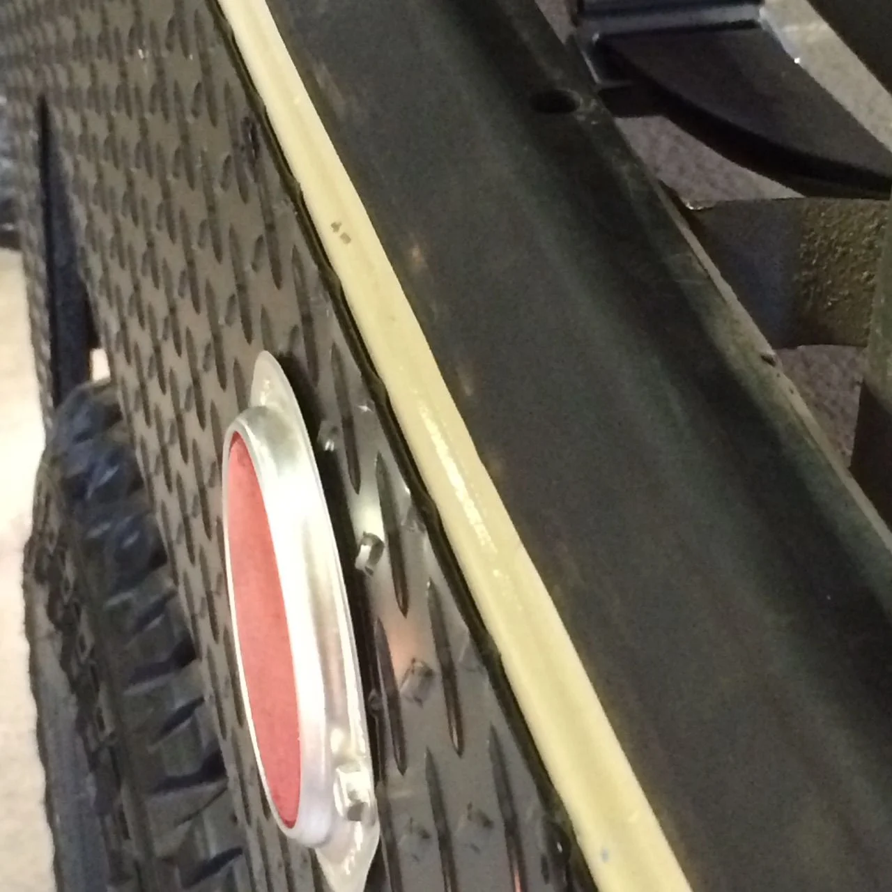

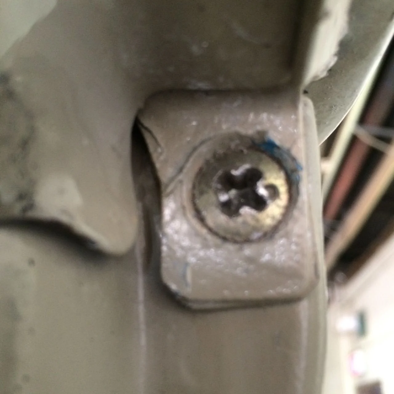

Started laying down some of the remaining gaskets today. "Homemade" effort fits like new. Used a small bead of PERMATEX to tie it in.
Body tub to hard top..
Again, used a dab of PERMATEX to hold the gasket in place. Used a field expedient clamp to hold everything in place while the P-TEX dried. Gaskets cleaned up very nice from last nights "Dawn" soak..A quick wipe with silicon spray and everything went down as designed...

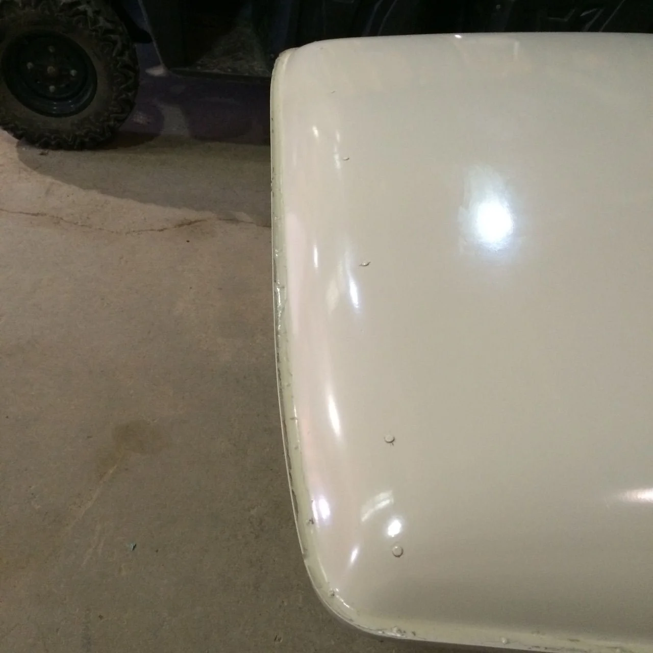

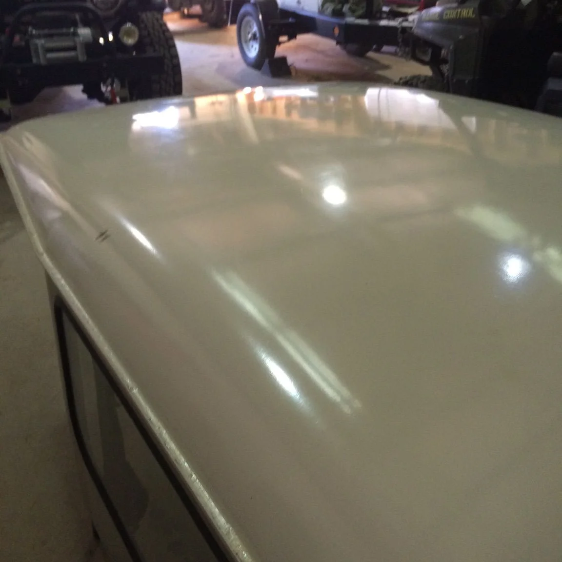

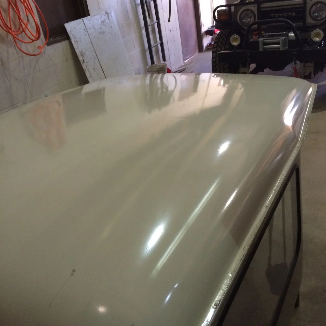

Hardtop sealer cured and looks good. Missed the edges yesterday due to the sealer curing. So I hit the edges and the full top one last time with a good coat of paste wax...

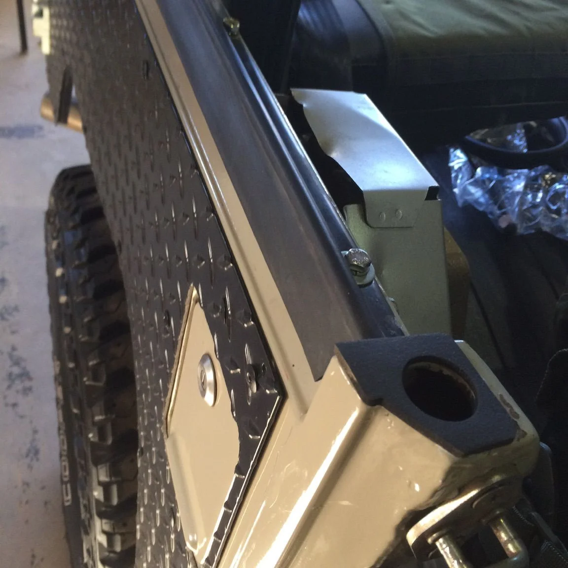

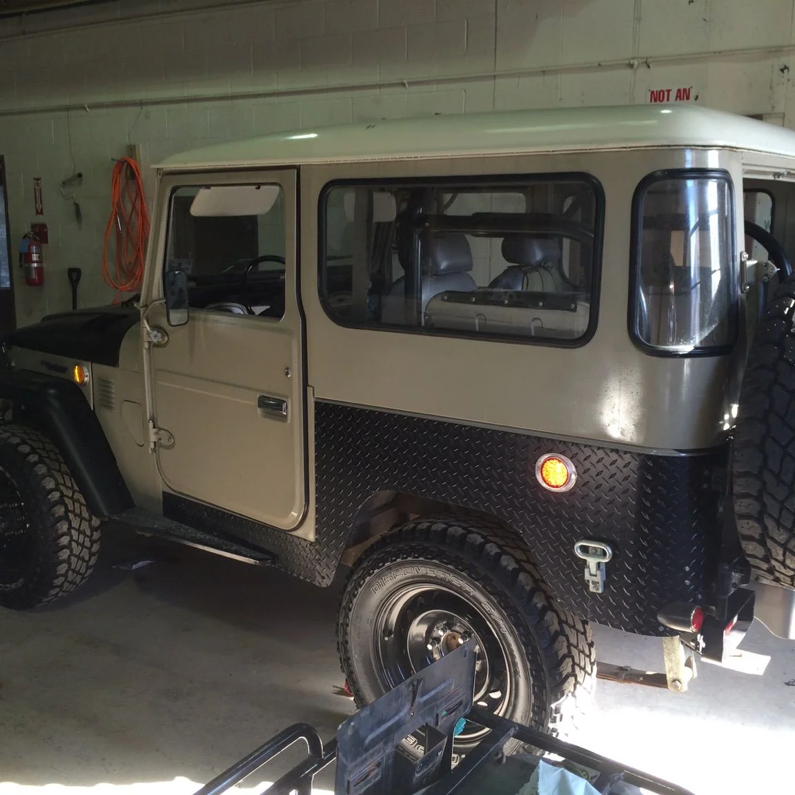

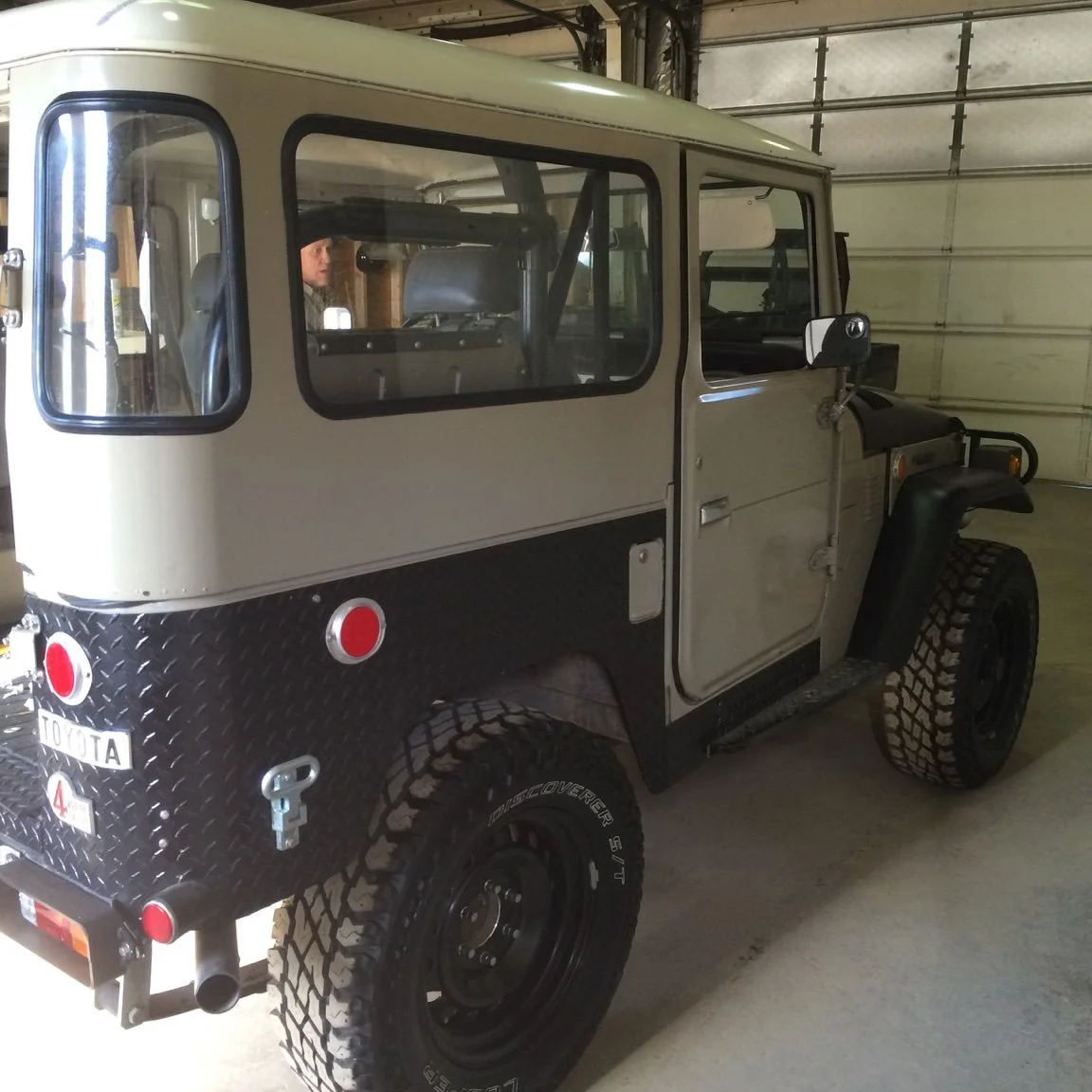

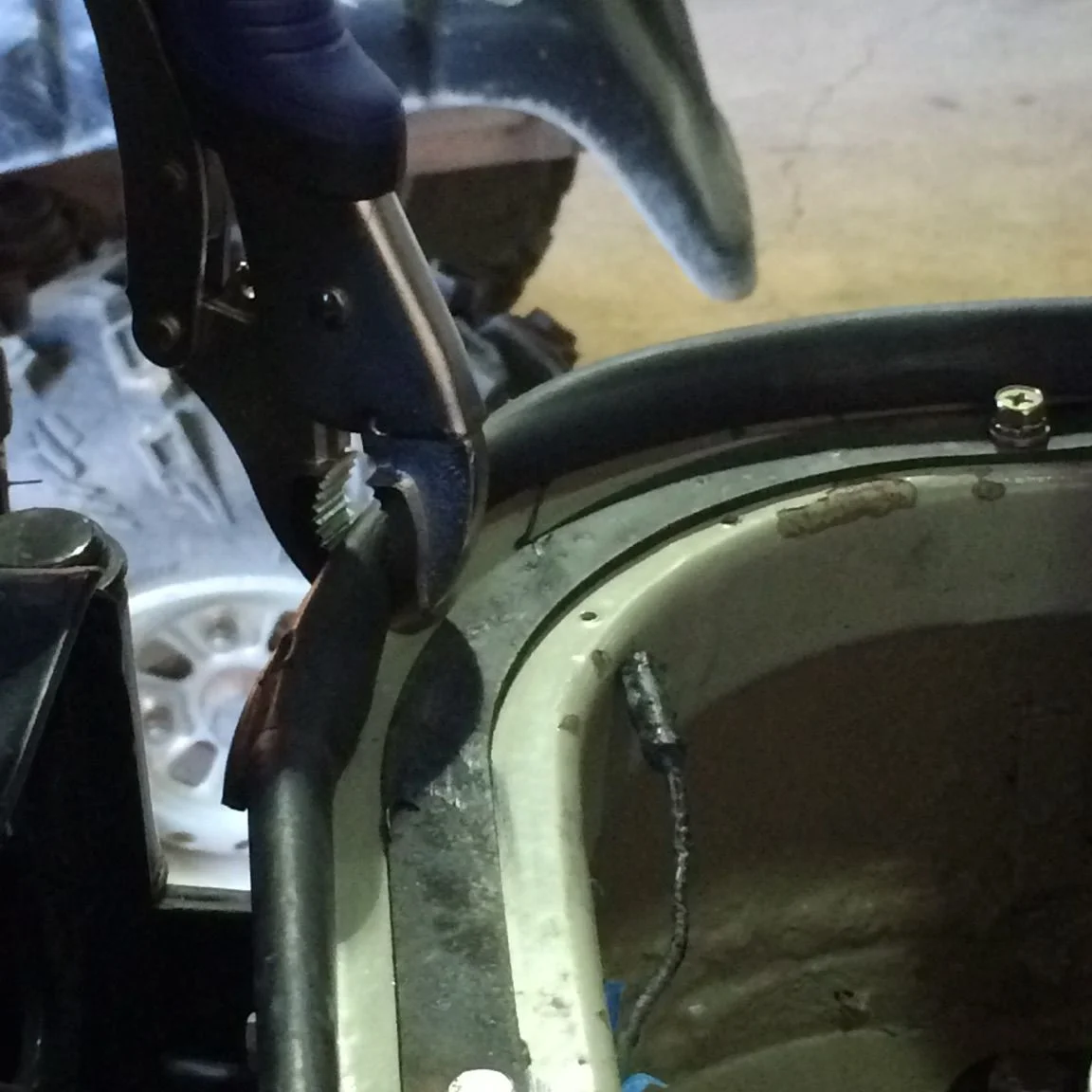

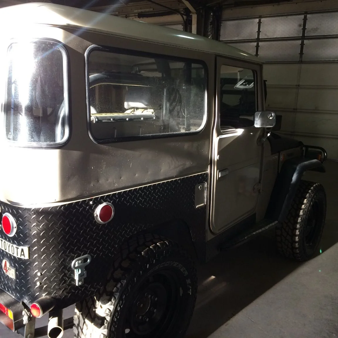

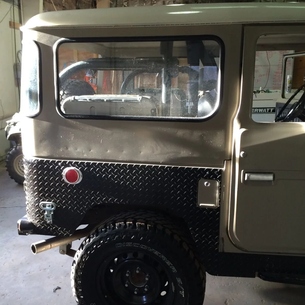

With the help of "Jeremiah, Yosemite, The MSG - AKA Delmar and Jim Bob", the top went on with a little gentle persuasion. Almost one year in the making. Gaskets held their ground and the mule took to the saddle with nary an issue..I did notice a couple of areas that will need some attention down the road..I'll post up some picks later. Pics show the top "unsecured"....

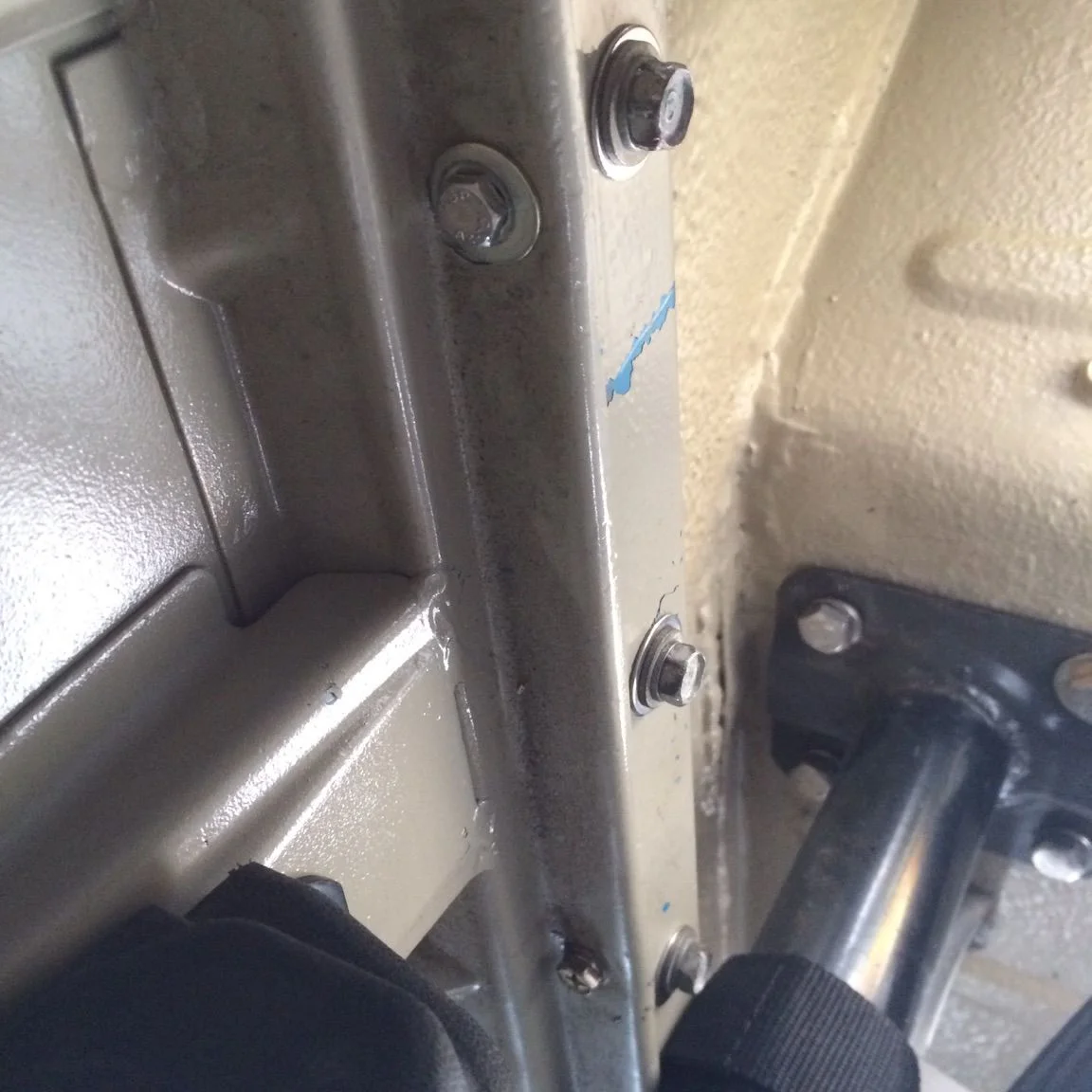

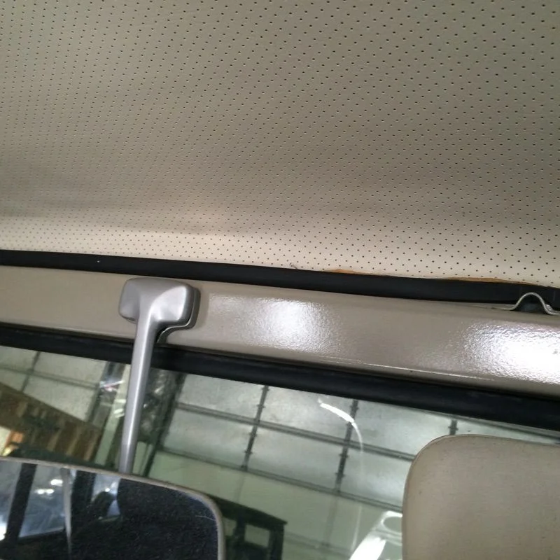

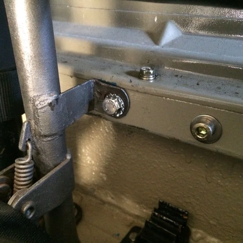

Couple pics of the interior fit. Everything checks out.

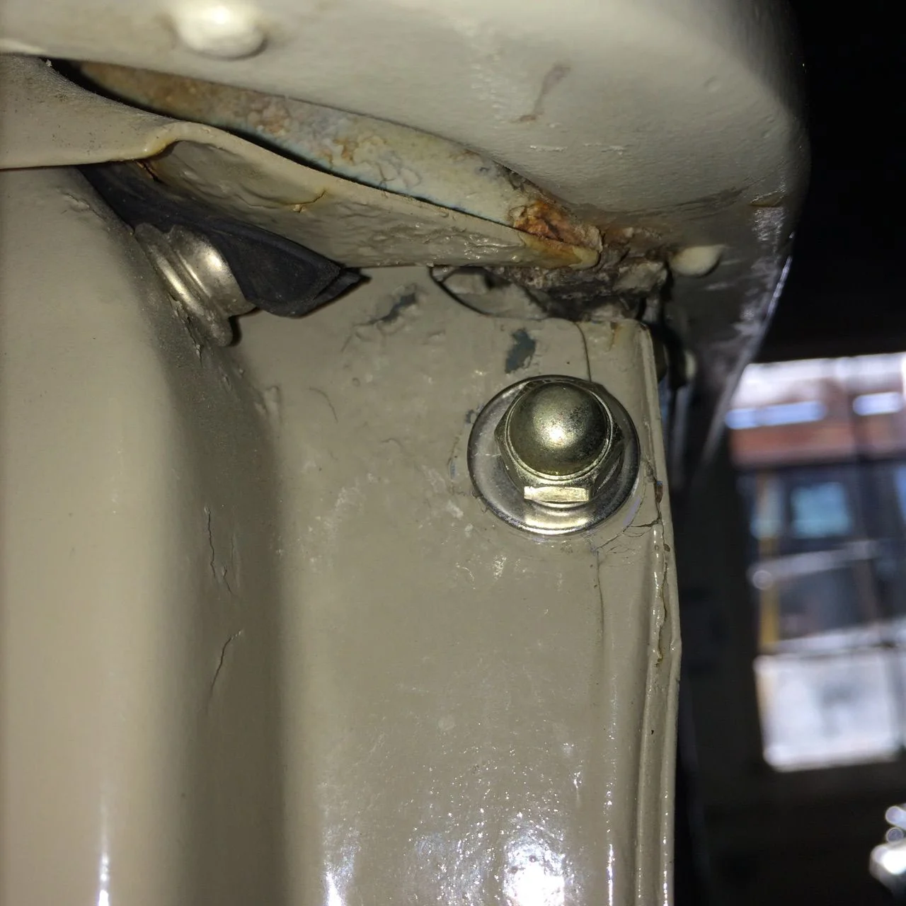

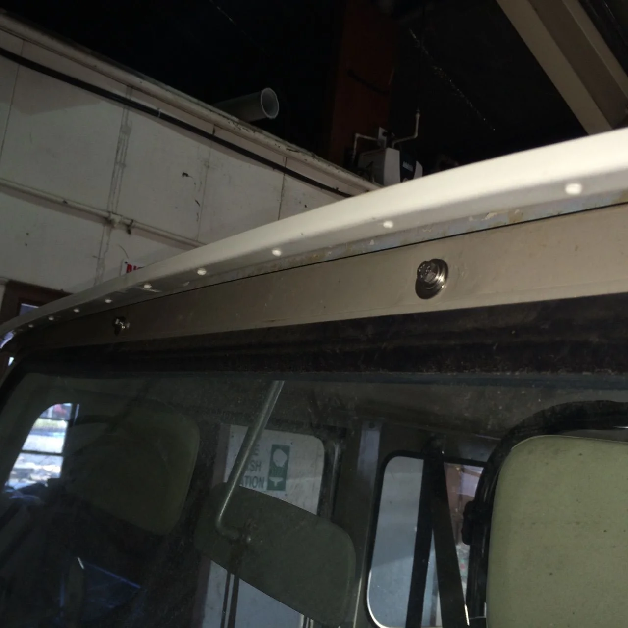

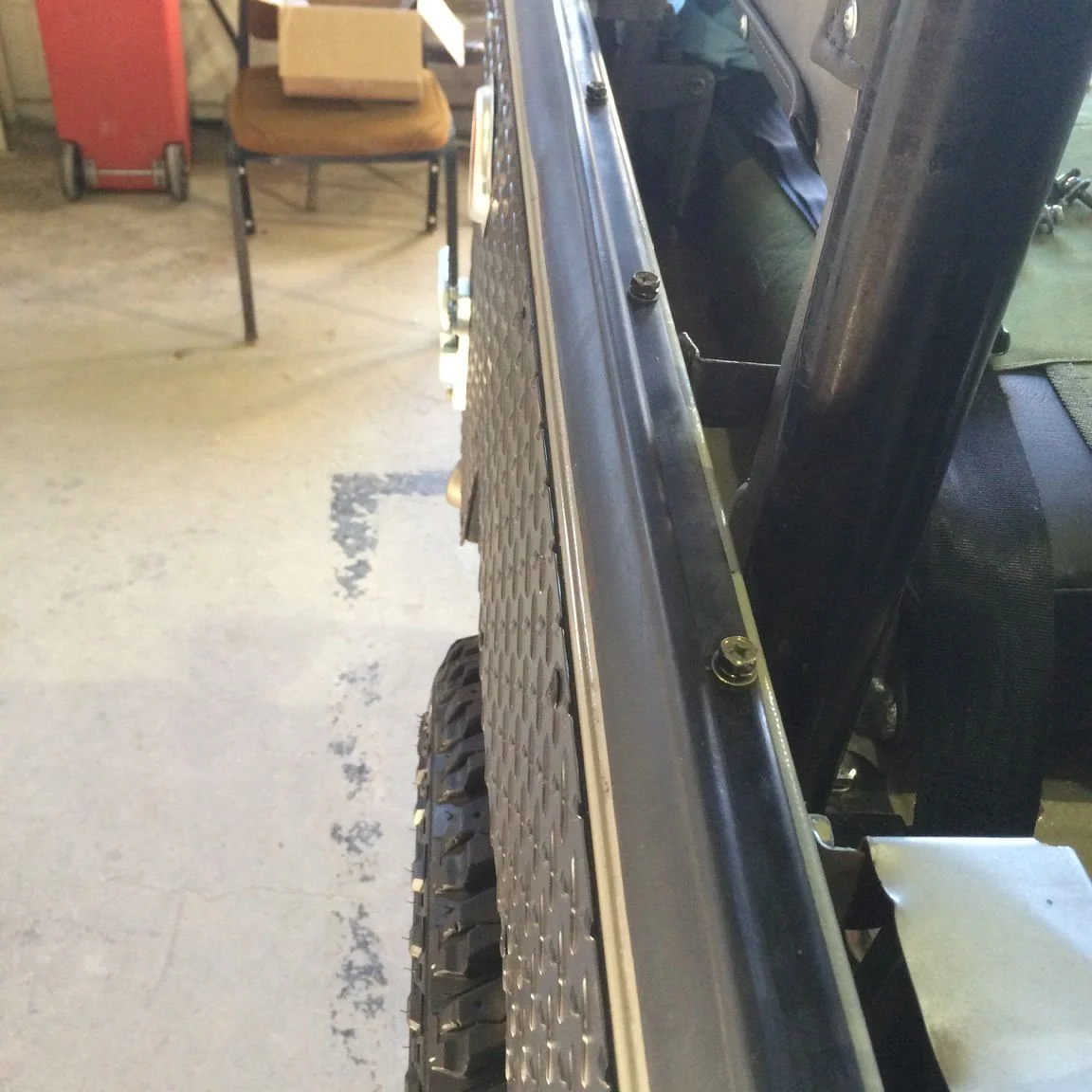

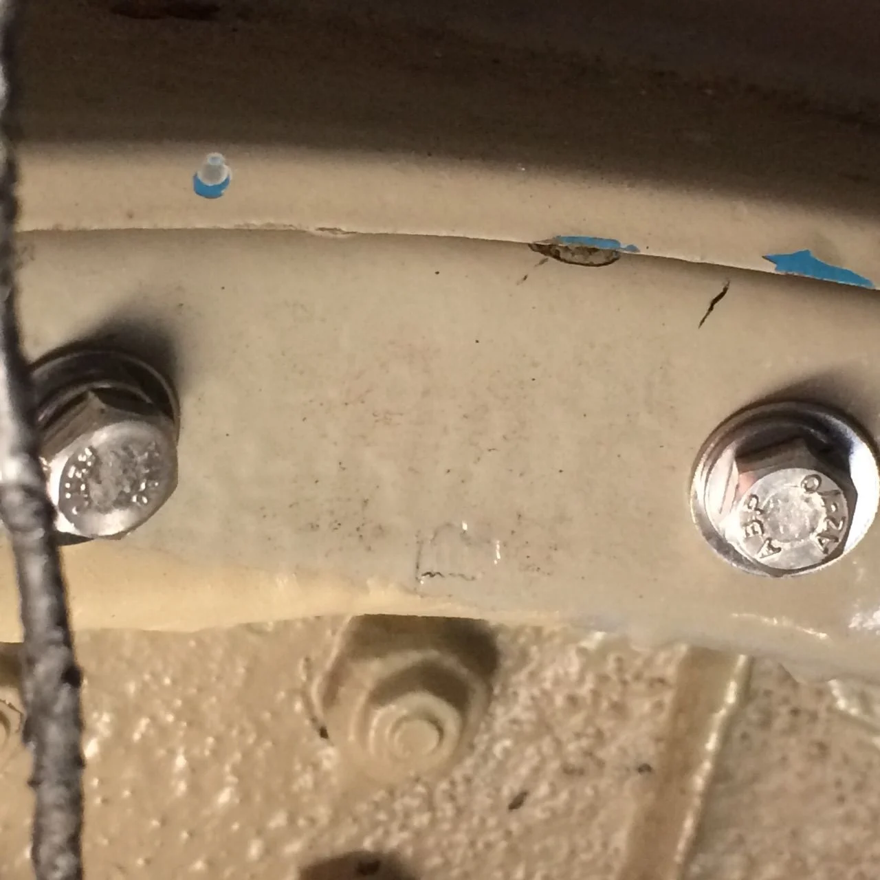

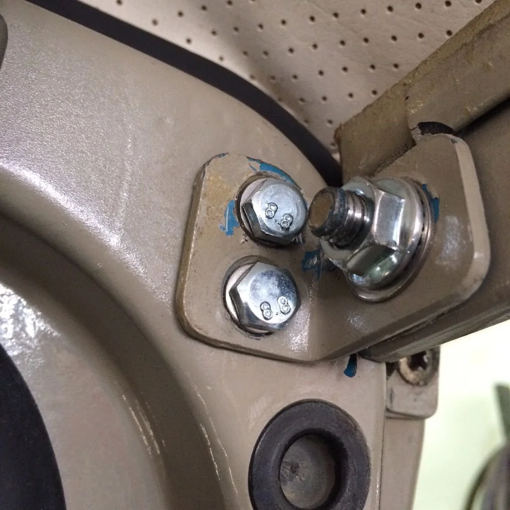

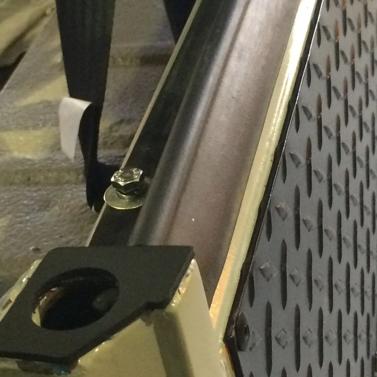

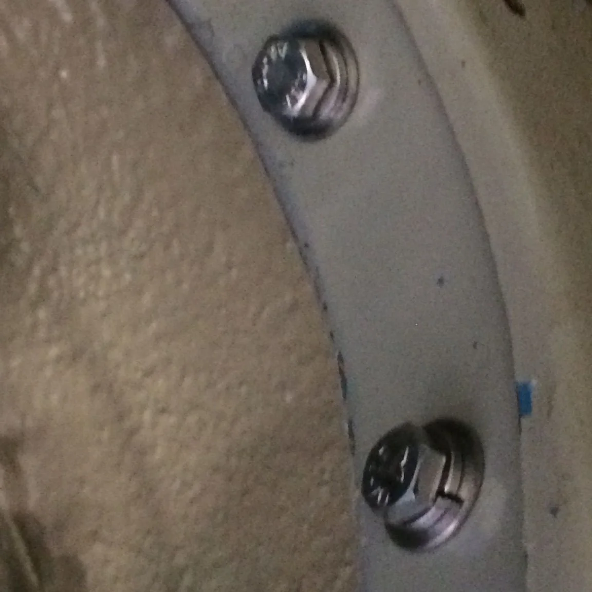

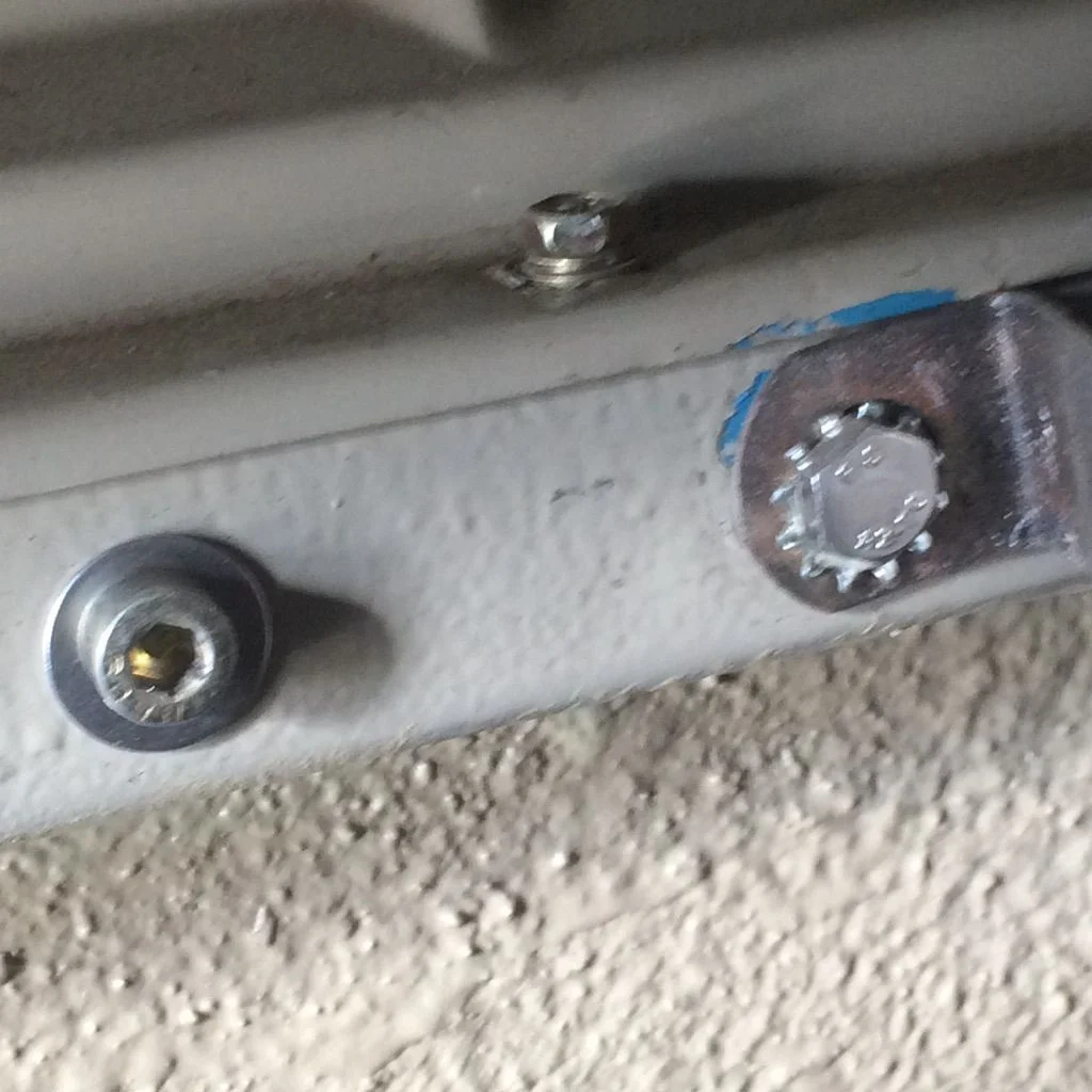

Few pics of the hardware used on the top..Some new, some OE, some of unknown origin.
Final phase of the hardtop button-up..the mule is back in the saddle again..Ain't that right Gene?

@dfclimber Which ones are you asking about? Front- top of the windshield, the brackets for the top corners (inside on the front upper left and right), bolts for each side. Also hardtop B-pillar set bolts and jump seats..
The M6 in the rear corner?
M6 in corners and the hex
After stepping back and giving this a think ,I reckoned I would answer your questions with "What I know" and "What I don't know" answers. In this particular conundrum, the "What I don't know" far out weighs the "what I know" category by a fer' piece.
What I know:
When I bought the mule awhile back, it came without the jump seats. The bolt kits come in packs of 8 or packs of 10 (10, I believe is for the double wide jump seat up to around 71 or 72) . When I purchased the jump seats now residing comfortably atop my wheel wells, I also ordered bolts accordingly, 8 instead of 10. That gets me through most of the "What I know" category.
What I don't know:
Envision the port side of the mule. Starting with the M6's just left of the rear hatch (stern). There is a matching set on the starboard side as well. There were two inside homemade footman type loops attached at these locations when the mule arrived. These are threaded (metric) and I am not quite sure if that is a factory thread or the "Mule Skinner" before me added them.
Along with the "footman loops" the PO had installed 4 I-bolts along the bottom edge of the hardtop. Two where the hex head bolts are now. These are also threaded metric.
The PO was an outdoors-man of sorts and kept a canine companion (I pulled enough hair out of the tub to knit socks for a Laplander) I surmise, and this is only speculation, the eye-bolts were used to keep a "cargo type net" in place. I found a couple broken plastic cargo anchors that lend some credence to the "Net theory".
Now there were/are three 12mm bolts along the port side that are threaded and appear to be factory 12mm bolts. The purpose of these bolts fall into the uncharted category as well.
Even more of what I don't know. I assume that my top is factory installed. I assume the PO may have made a mod er' two. If the top is of an earlier variety (year) I don't know which year.
A bit more of what I know. If it had a threaded hole "I plugged it" with the best of intentions. Hoping, as the years progressed, that these mysteries (and others) would be revealed to me....
I have answered as best I could and interjected as much truth into the matter as my Appalachian upbringing dictates. Simply stating "I don't know" would have somehow diminished the fact that the Ole' mule once "hunted, fished and enjoyed the wide open spaces out west. The scars, nicks, rust, and mystery items only lend intrigue into the origins of the PO's purpose and intent.
There are rumored to be men of renown and great wisdom residing within the "threads of MUD". Men of keen intellect and photogenic memories who by superior reasoning and highly evolved acuity, can quote "line and verse" from the FSM's each nut, bolt and errant screw location. I am hoping that one of these distinguished "rust warriors" will have an applicable answer.
Be as it may, concerning the mysteries of the "extra hard top bolts", I can only add more chin scratching introspective speculation........

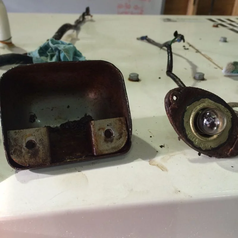

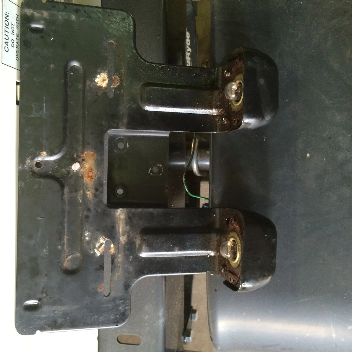

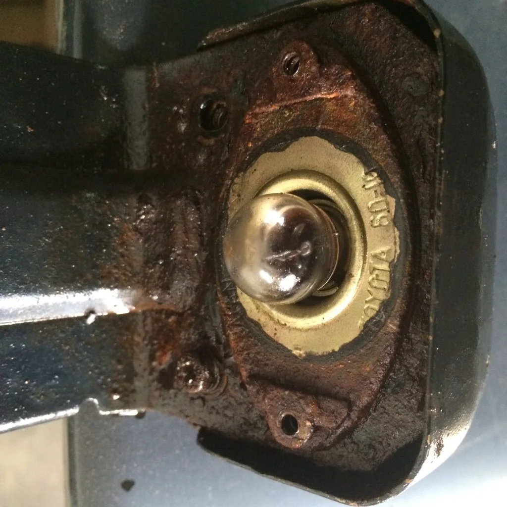

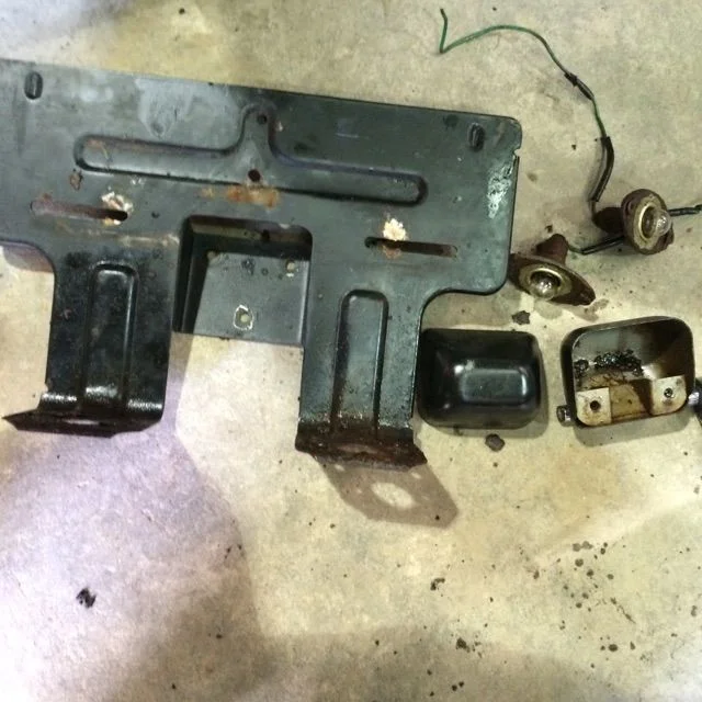

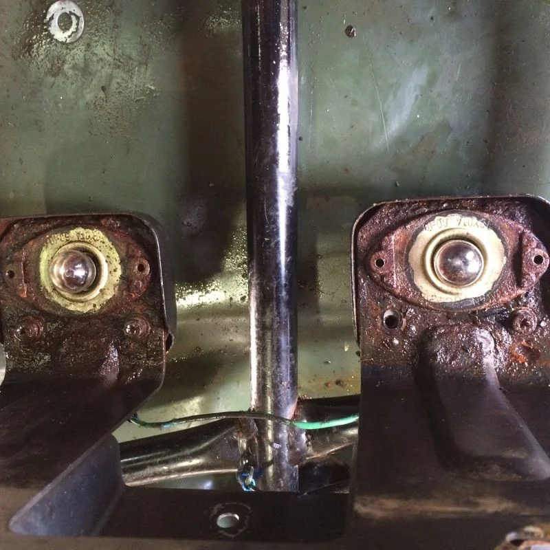

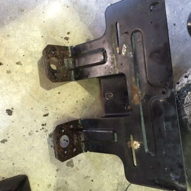

Phase I rear license plate bracket tear down. Not looking good so far. Two days of PB and gently coaxing the machine screws out.
Phase II. Good news bad news. Houston we have separation. Bad news the rusted and corroded screws gave up the spirit. I'll salvage what I can for spares....
Phase III. Final disassembly. Without regard to the effects of torque on rusted metal I dove in with a full frontal assault...
I'm in for new rear lamp assemblies.... Yet to media blast the bracket...I think I can save it..o_O

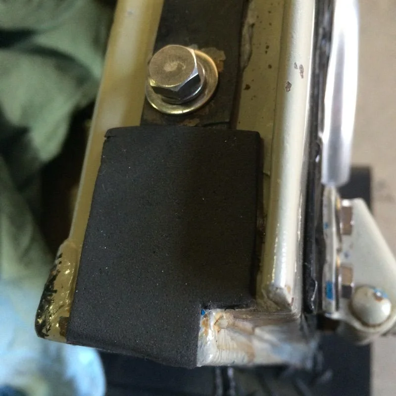

Did you used weatherstripping adhesive to "glue" your weatherstripping to the top of the tub? :hmm:
It seems the treads I have seen everyone seems to make sure its secured to tub. But anyway to my point, why not lay it out on the tub making sure it is good to go, then put adhesive on it so that is will stick to the bottom of the top? Clear as mud? My thoughts are when the top is off the weatherstripping is secured to the bottom of the top, and you never have to worry about it getting messed up or lost. (like those little corner mounts you and I both made). I plan on removing my top a lot which is why Im looking in to a Gobi too.
I used a few dabs of evenly spaced P-Tex gasket maker on the tub side. I Used it sparingly IOT keep from destroying the gaskets when I remove the top. PO had used this same approach. When I took the top off last year the gaskets were in great shape and I re-used them.
