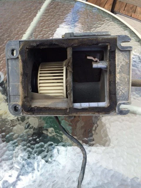

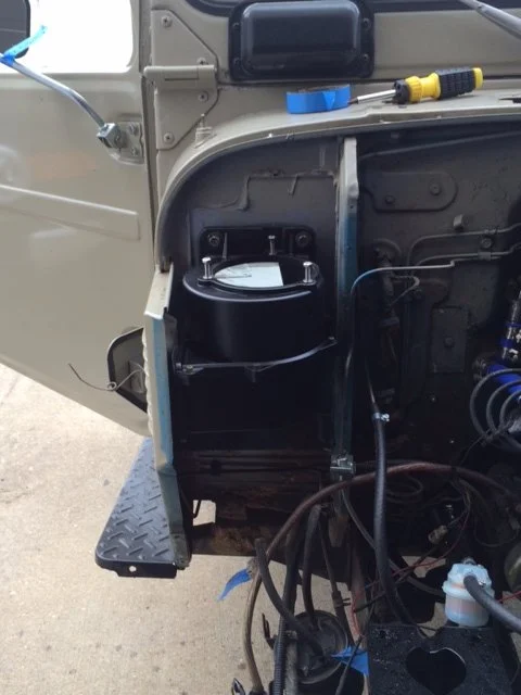

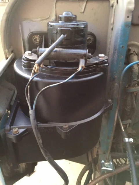

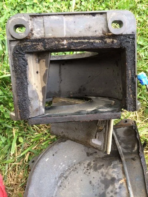

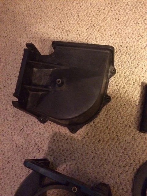

Removed the blower assembly last week. Thought I would post up some pics of the"pre-refurb"...Started the tear down process today.

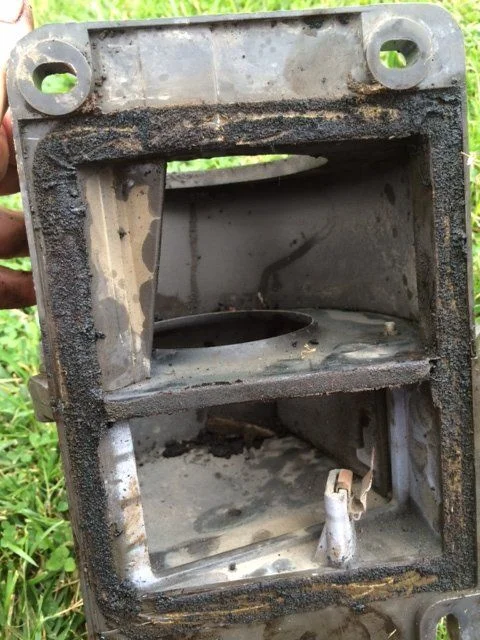

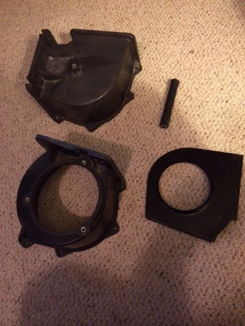

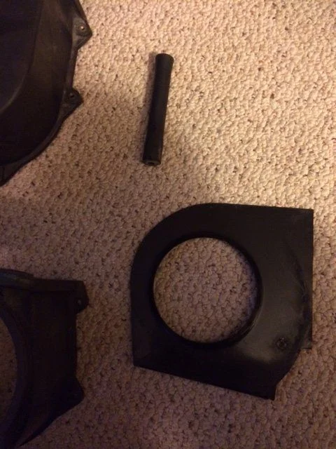

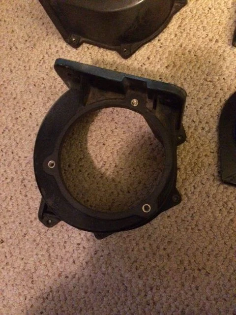

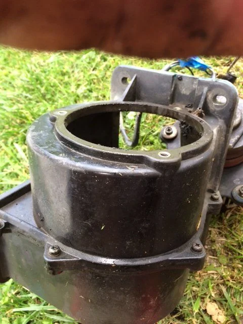

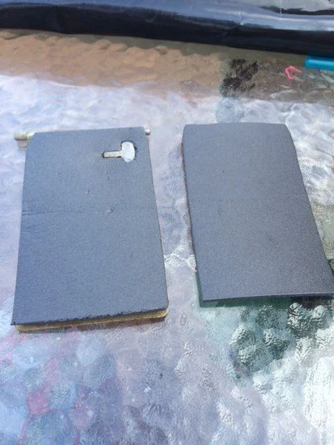

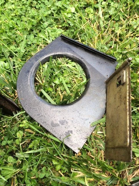

Starting the tear down. Going to need a good soaking. I'll use a little "Dawn" dish washing liquid to soak all the plastic pieces. Plan on using the same closed cell foam to refurb the gaskets...

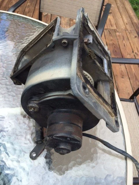

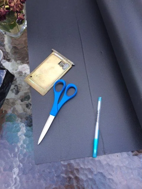

Easy re-foam process:banana: for the heater blower. More to follow later. Main housing/plastic parts are still soaking.
1st soak complete. I'll finish up this project on Friday.

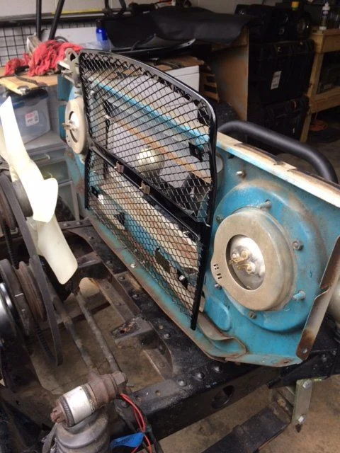

Finished re-foam ops on the blower. Test fit housing back on the mule after re-foam. Had way too much time today so I mounted the bib, grill and bezel (just because) Left everything loose IOT account for adjustments later. No word from the painter. Welding and painting skills would make Chunga a happy camper....
Note for the masses..Mount bib before mounting winch plate, unless you have the hands of a seven year old.

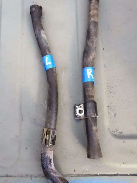

Stopped in at the garage this AM before heading back to the mountains..removed the old drain hoses. Not sure what I am going to do yet. New set or a new cap to delete the need for hoses...

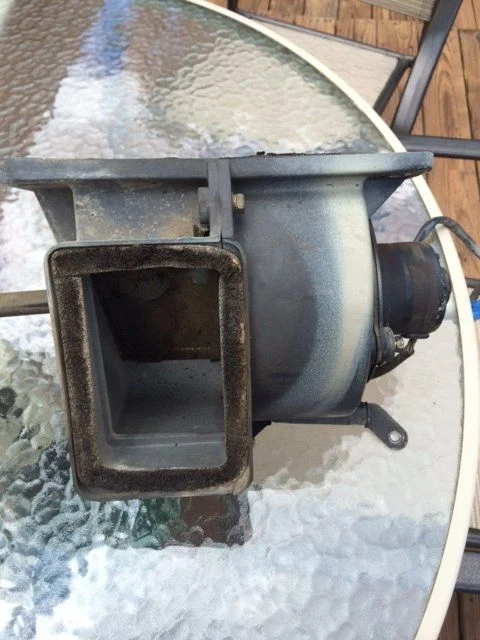

Cleaned,lubed and installed blower assembly.

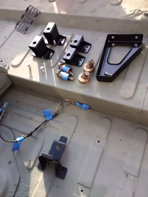

Cleaned the threads for seat mounts and jack mount. Using stainless hardware.
Might want to spend some time cleaning up the internals on that blower motor while it's off - brushes and bushings/bearings help a lot .
Good copy Sarge...Knocked it out this AM!!
