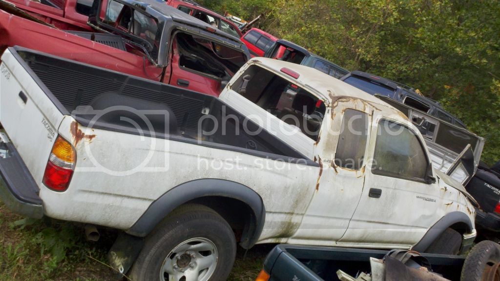

Here is the donor truck....

Sorry, for the delay and lack of information. The 74 fj40 I have is bare sitting on a good frame with no motor. The tranny is in unknown condition but the transfer case does have a twin stick setup with other signs leading me to believe someone wheeled it aggressively. The original wiring harness is gone and a painless kit is in place for a 350 but it is spliced severely rendering it junk.
Therefore, I purchased the taco for $3000 and I can fix it back to an truck but I thought it would be great for a donor to take the fj40 down to a extended cab, then remove the bedsides from the taco and replacing then with flat quarter panels or late 70's Toyota pickup bedsides to closely mimic the original fj45 sides.

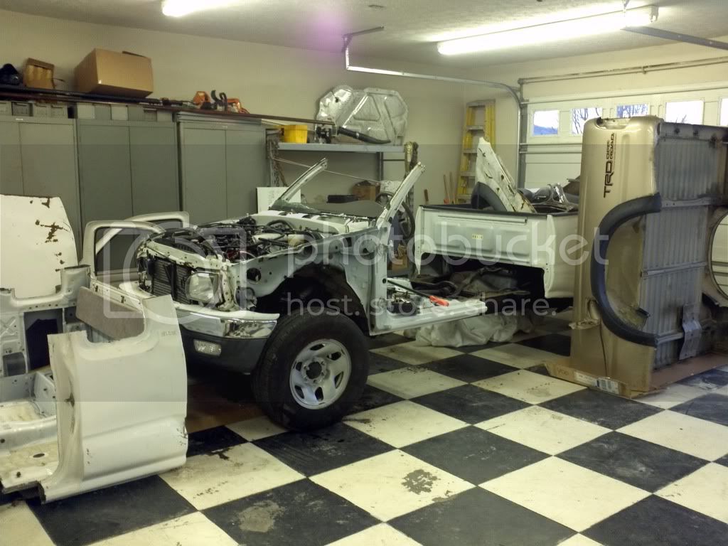

Plans for the 1974 FJ40 will be to remove the body of the 2000 Tundra leaving only the chassis and drivetrain (yes, the IFS will stay) and shorten the frame to desired length. The 74 FJ40 will receive a half top conversion and the body will be lengthend to what some call a "ute."
Here are pics of the 02 Taco and it's current transformation... lots of welding ahead!
