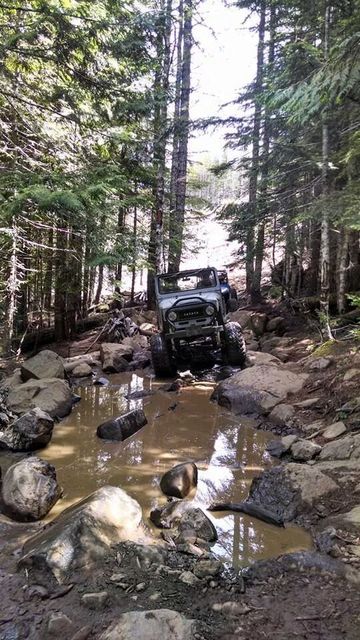

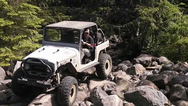

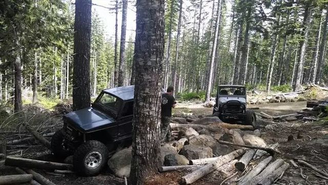

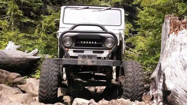

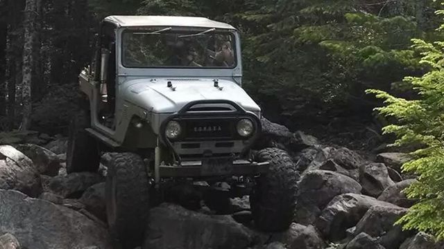

Sorry guys, no bad cell phone pics of the new parts… A friend asked me if I wanted to go wheeling on the 4th, so it was a mad rush to get everything together and ready to roll. I got the parts on the 2nd, test drove it on the 3rd, and loaded it on the trailer to go wheel! The good news is, the clutch is fixed! However, it has been so long since I have been able to wheel in any heat, I forgot about the power steering overheating. Half the day was spent strong-arming the steering wheel. It feels like the other half was trying to keep the front shackles from inverting… I guess I have a bit more work to do.
And some wheeling pics to keep everybody happy:
