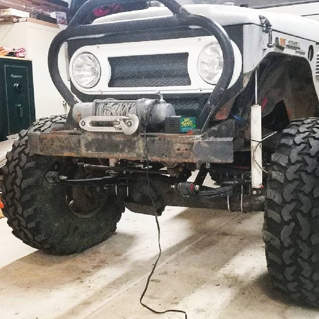

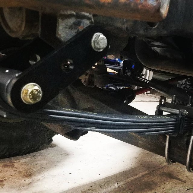

When I got the 40 back, one of the front leaf springs was severely bent. After a bunch of research and measuring, I figured out that the leaf springs were custom built by Alcan. They used the measurements of a stock front FJ40 leaf spring (20"/22.5" pin to eye), but designed it to be ran backwards to lengthen the wheelbase by 5". It was also set up with an OrbitEye on the fixed side. The reason it bent is the shackle would invert when wheeling hard...
I figured the best way to tackle the problem would be to run front leafs from a Hilux. I researched out what the stock spring rate of an FJ40 front spring was and figured that the heavy OME 2.5" spring pack would be about perfect. I also knew that I would have to change out my 4" front shackle to a 5" shackle to keep it from binding at full stuff. Furthermore, I knew that I had way too much castor beforehand, so I added 10* shims. Here is the end result:
