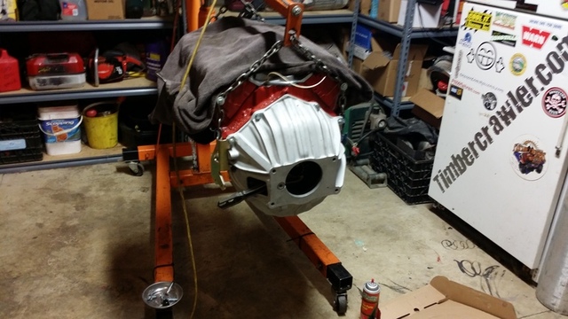

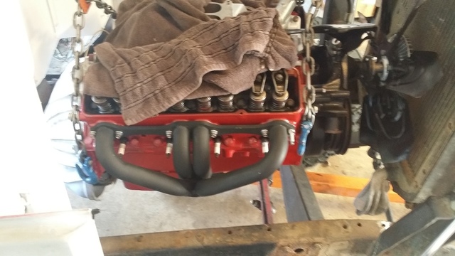

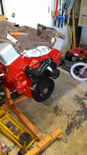

Well I got a little work done on the 40 last night! I decided it was time to get the engine off the stand for the first time in over a year...
Once it was hanging from the hoist, I was able to replace the flexplate with a new flywheel, install the clutch I got from dirtgypse, and cover it up with an aluminum bell housing my Dad found for me forever ago.
After a quick call to my neighbor to help, I was able to get the trans and cases bolted up. It actually went a lot smoother than I thought it would, but man that is a heavy combo!
Next I need to finish cutting off the original frame mounts, slide (lift... force... etc) everything between the rails and start building mounts.

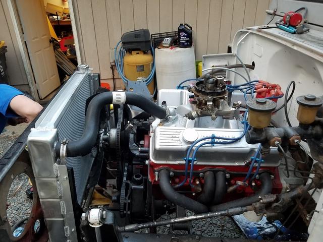

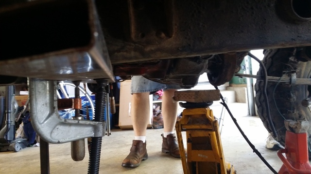

Well I know it doesn't look like much, but I got the frame prepped and finished up the few little things on the engine. That means she is ready to get located! I need to fill up the gas for my welder, grab some steel, order up the engine mounts, and set a work party!

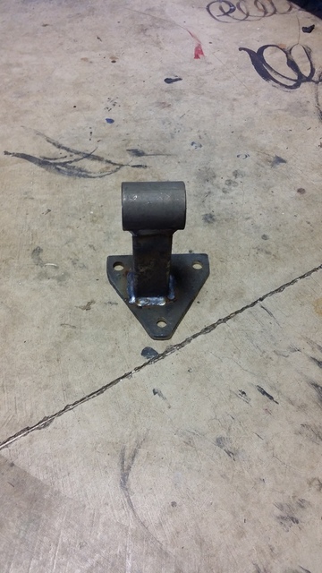

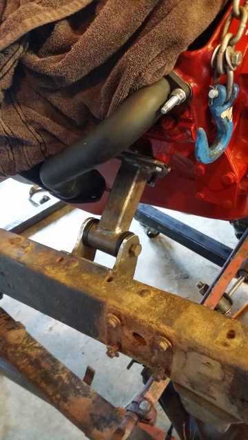

Last Saturday some great friends came out to help me locate this engine. I have never done anything like this before, so it was really nice to have some help! We started off the day by getting everything in between the frame and measured up. We were able to tuck the trans/t-cases pretty high (almost flat belly) and adjust everything for clearance and cooling. The only thing that doesn’t want to play nice is the steering. I will have to figure out what to do there. It may be as easy as running ram-horn manifolds or notching the frame a bit and running a pillow block. I’m not quite sure yet what I’m going to do on that front, but I have time to figure that out.
After that, we were able to build the motor mounts and get them all in. I still need to build the trans mount, but I know how I want to do it. That being said, the engine is actually in the 40 without assistance for the first time in over a year and a half! I am so excited!!! Now, onto the pics and a huge thank you to everyone that helped.

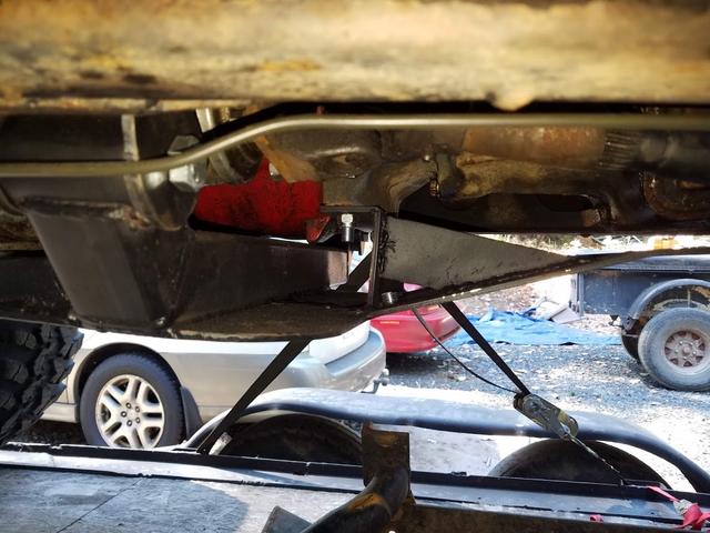

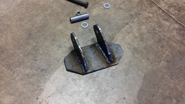

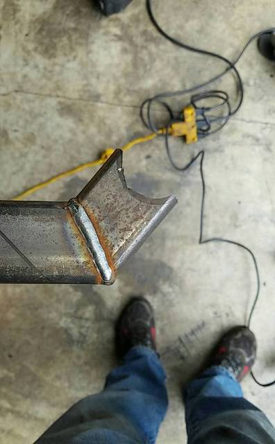

Well I got a little more work done on her. I was supposed to do yard work on Saturday, but the rain got me in the garage! I finished up the main portion of the trans crossmember. I just need to build the fish plates for the frame and cut tabs... I really wish I had a plasma!
My fancy welding table... Also known as the floor.
I'm okay with that!
Coping with an angle grinder... Fun....
Meh... I can fill that.
*closes one eye* Yeah, that looks square...
I think it came out okay!

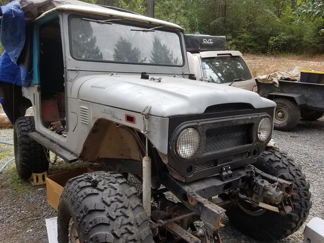

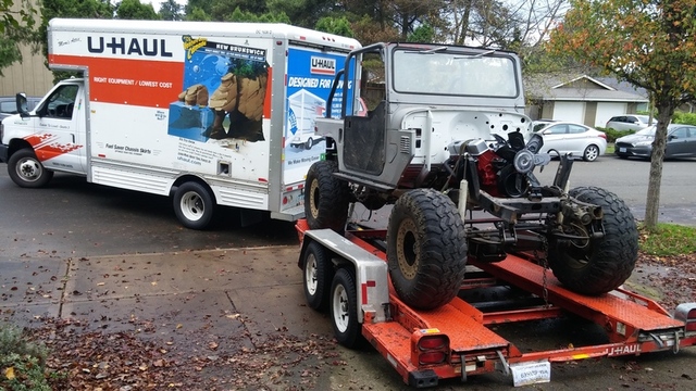

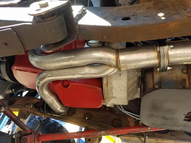

How about an update on this pile for the last 3 years... LOL!

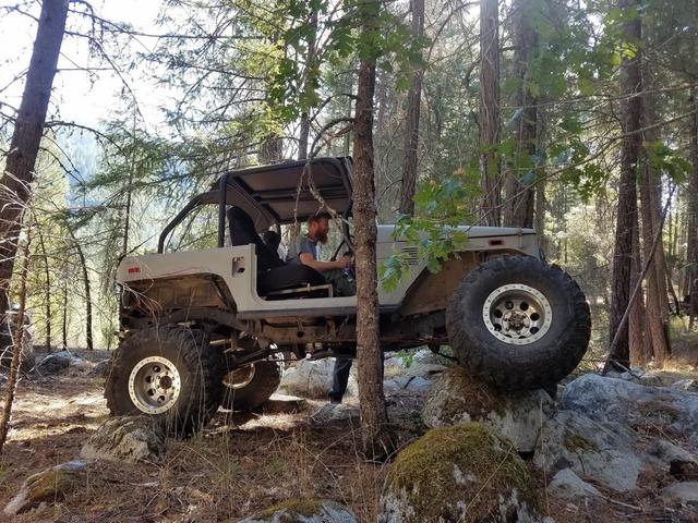

We left off with me selling this 40 to my buddy Travis (@knoll0351) for his wife. Over the course of those three years, Travis was able to finish pretty much all of the mechanical and electrical on her (the 40, not his wife...). I even got to wheel with him a few times and the ol 40 worked great! I will let the random pics tell the story:
