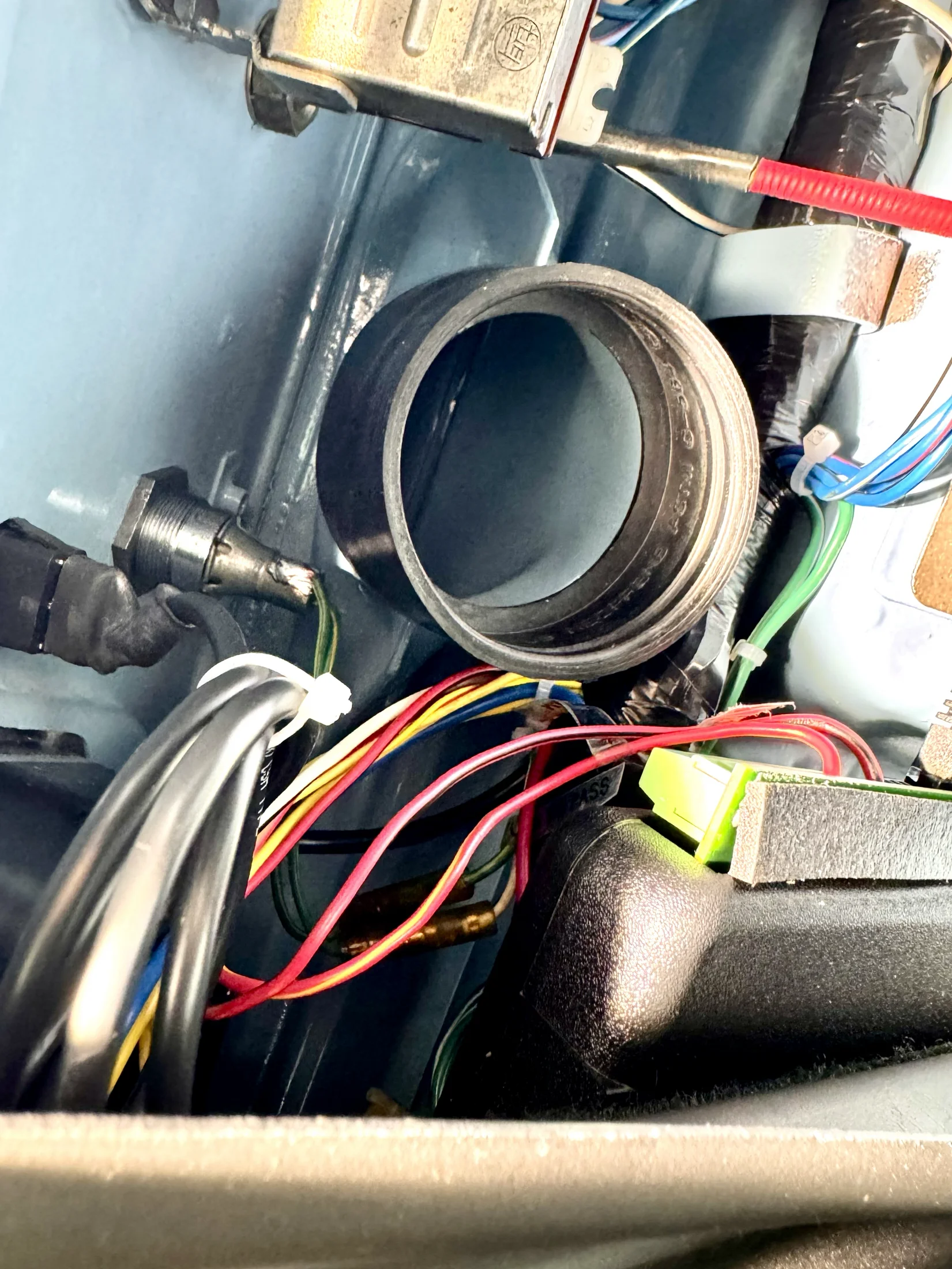

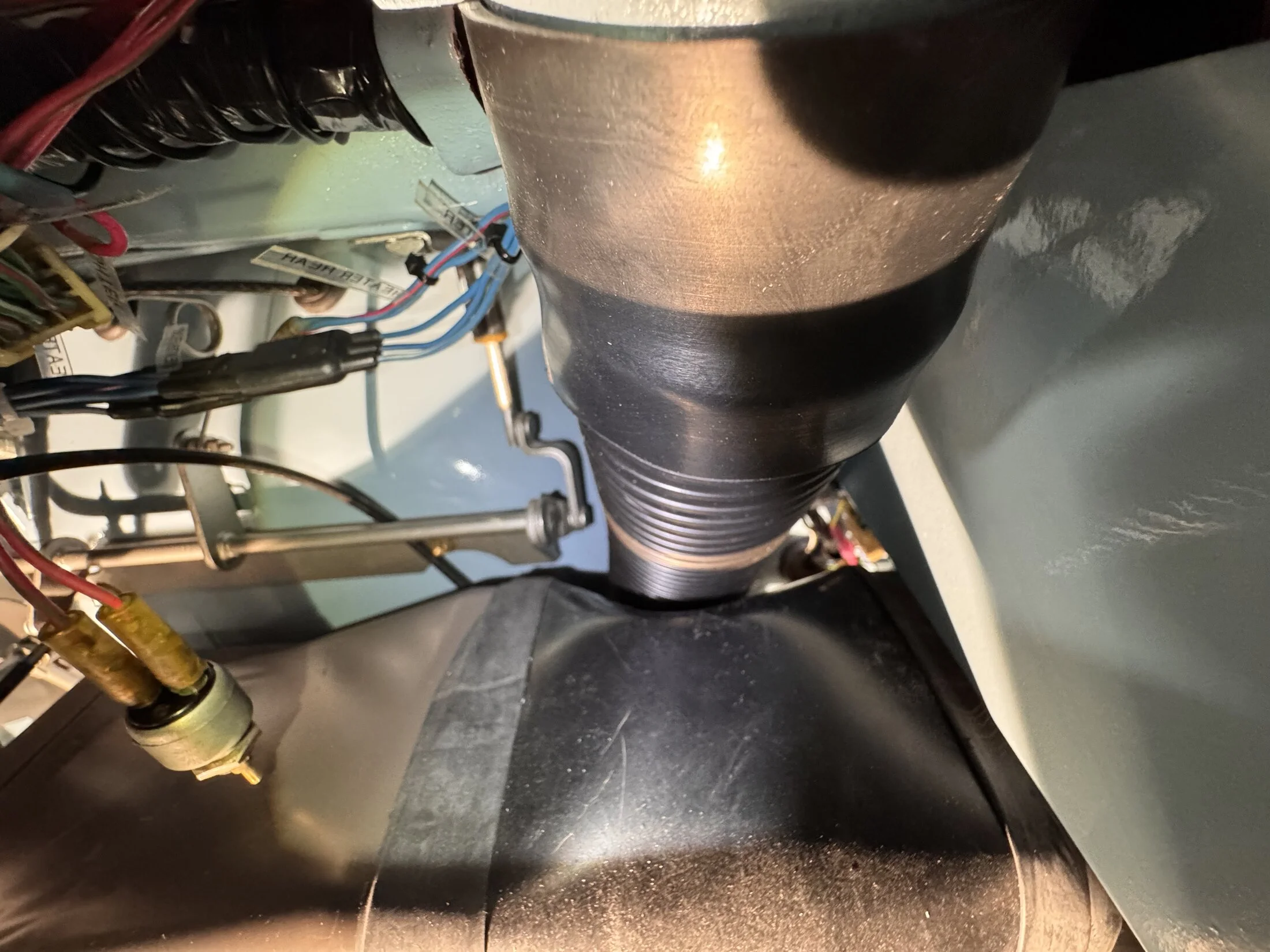

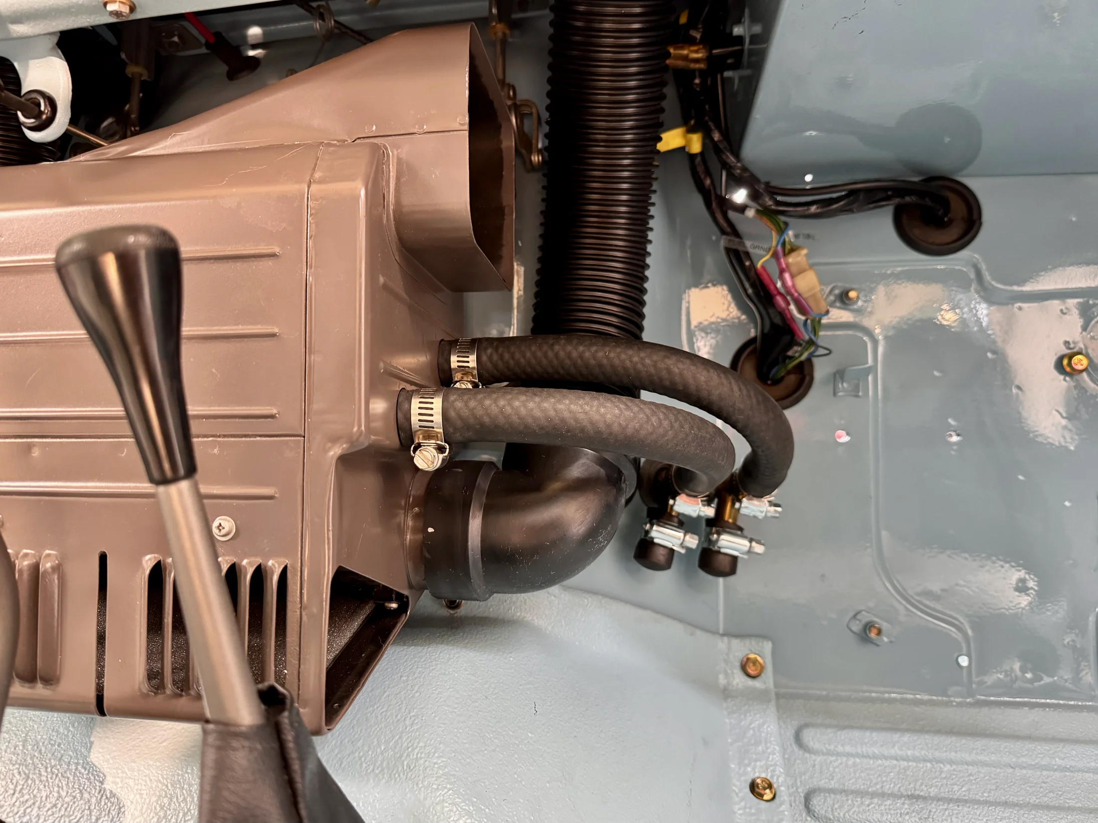

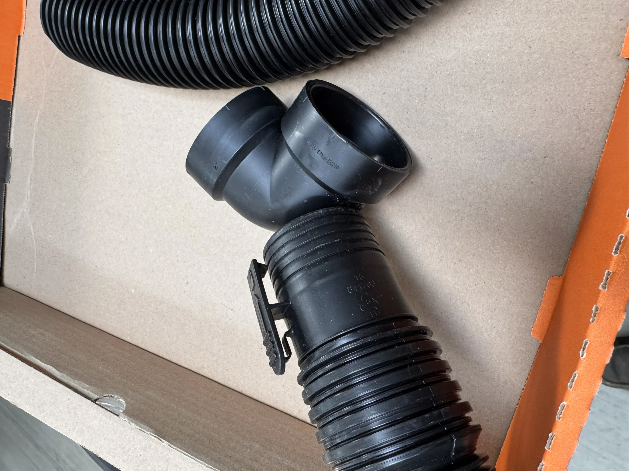

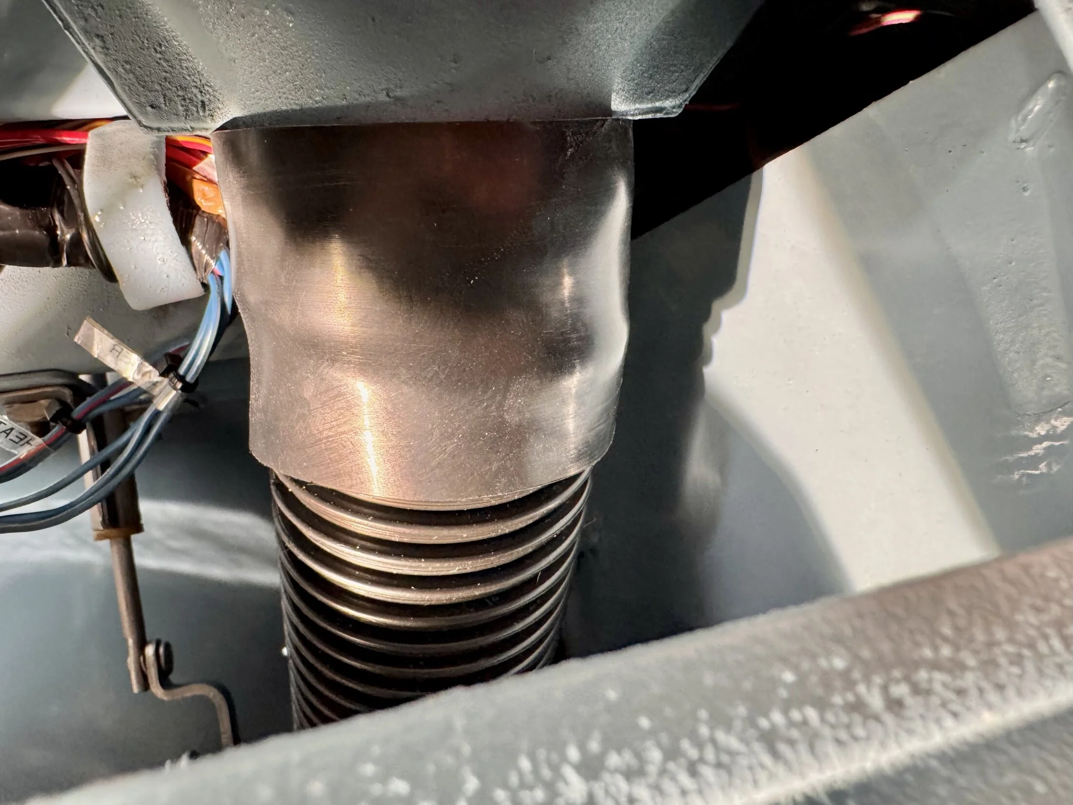

Wanted to share how my defrost duct hose project came out. Used 2-1/2" shop vac hose from the Depot and some 2" ABS elbows. The hose makes a nice snug fit in the elbows. I did have to heat up the outer ring of the elbow so that it would conform to the heater outlet. I just used a little butane torch and slowly went around the edge until it became a little malmble and then slide it on - one it cooled it was a perfect fit.

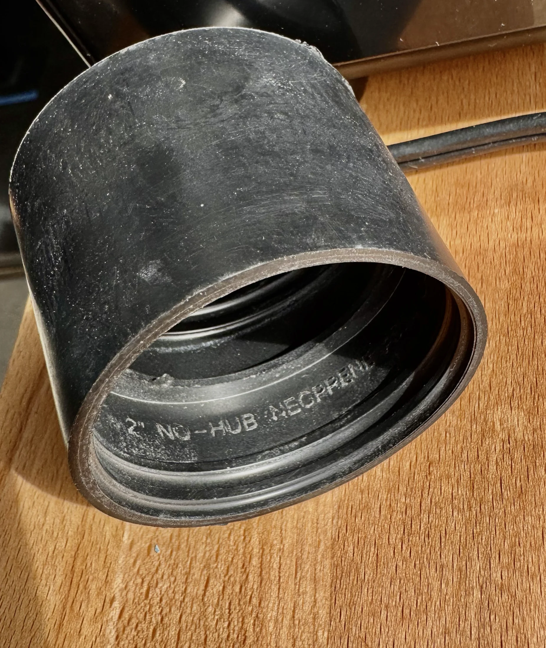

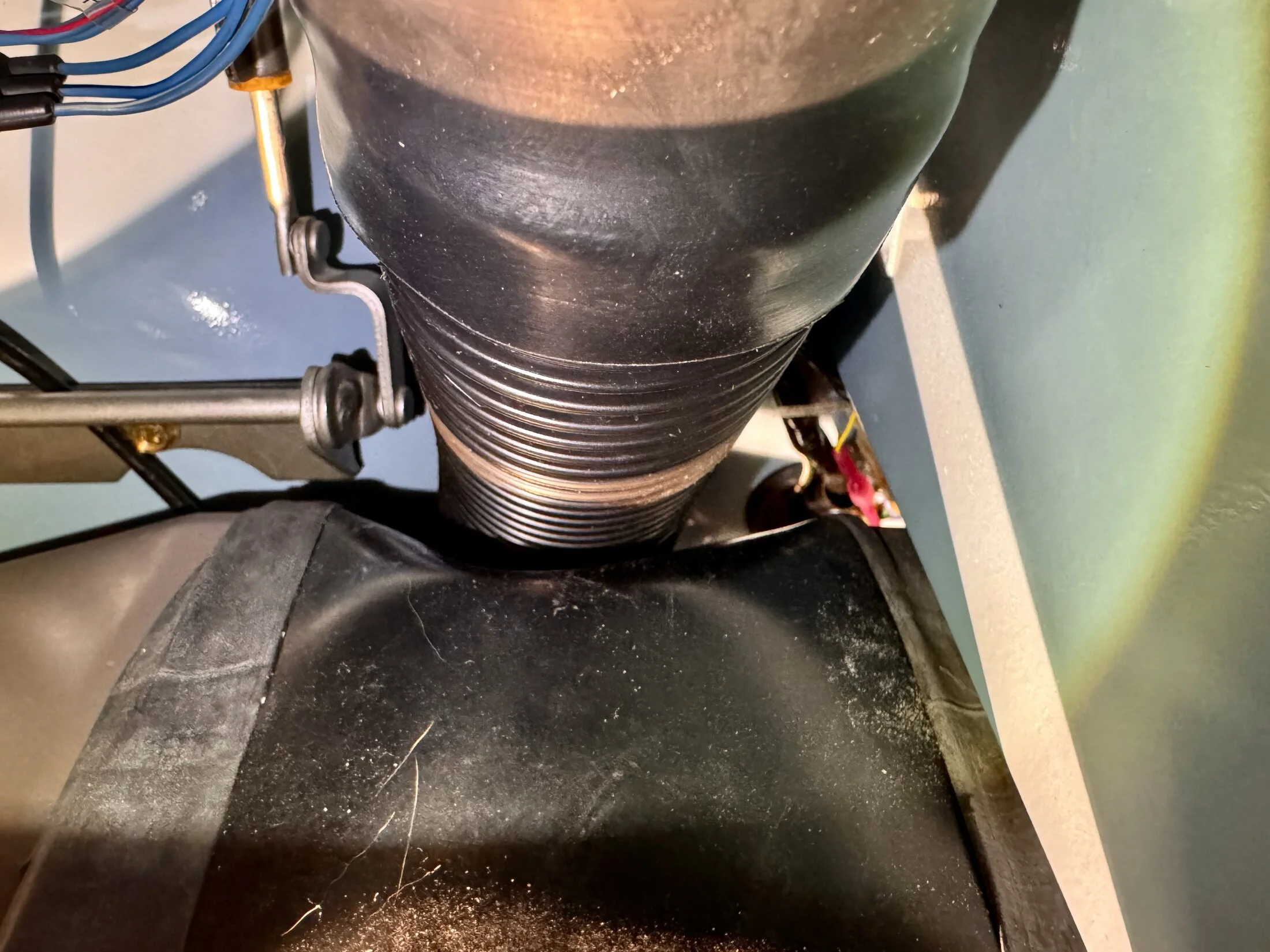

Originally, I was going to use the clip end of the hose to mate with the defroster inlet. the plastic end fits nice and snug inside the defrost inlet and the clip arm grabs the flanges. This worked great on the driver side but on the passenger side it was too long to make the turn around the heater ducting. I wanted them to match so I used a 2" neoprene shielded coupling (fernco proflex) with the shielding removed. This thing fits on there like it was made for it - the ridges hold it very securely and it as enough flex to allow good placement
