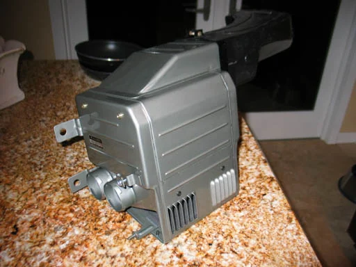

Heater: I sand blasted the case, and painted it with a batch of a dark silver I had the local autobody supply place mix up. The color came out pretty good, a touch lighter than I would have liked, but oh well. Used Shane's heater resto kit, and it worked great. A little trimming on the foam was all I needed. The mud price for the early ones is more than worth it too me for the yellow cad plated screws and the reproduction sticker. Its going to look great next to the Factory A/C unit I have.

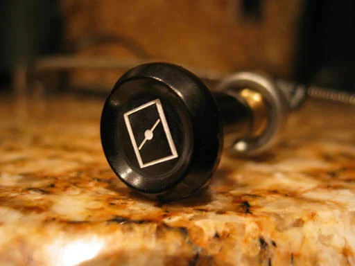

Choke cable.
I nearly pitched the choke cable since it looked so ratty in the dash. After a bit of work with a green scotch brite pad and a follow on assault with Brasso the black knob looks pretty damn good. the white was pretty easy to paint, just use the gloss white Testors model paint, liberally apply, and wipe out the excess with a thinner soaked rag. Dont go too crazy trying to get all the white off the non indented part until the paint in the recess dries some. You will have to re-apply a few times to build up enough white to fill the recess well. I cleaned up the trim ring and brass base with the scotch brite. Pull the inner cable and knob all the way out, clean, lube and re-insert. Works like new and looks pretty good for a 36 year old part.

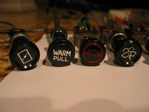

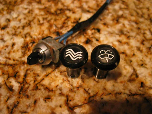

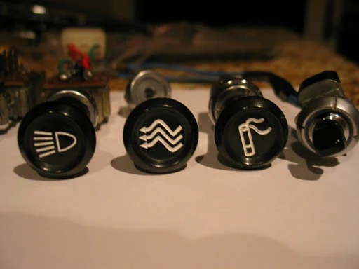

More pics
Here are some more knobs. Did the same thing as the choke cable above. The vent one was a pain since the groves are wider and the thinner soaked rag wipes the white paint out alot easier. Polished the tailgate switch knob same way by starting with the green scotch brite and finishing with brasso.

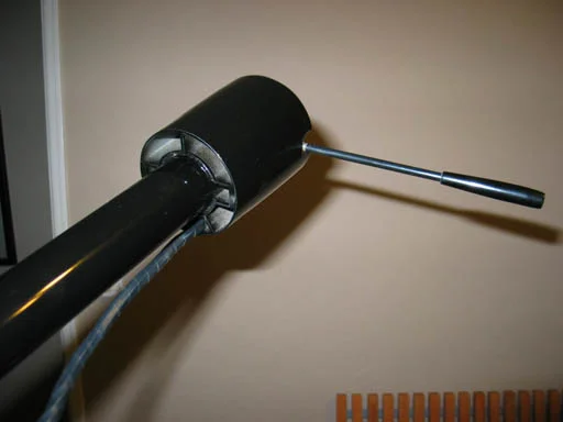

I got the column done(minus the steering wheel) and it came out great. I found that the lower bearing was trashed in the column I have. Well, that proved to be a pain, the toyota one is not acutally sealed, its just shielded. Since water can find its way in at the firewall opening, I wanted a sealed bearing, the style with a rubber seal. For the future, others who need the bearing, its 22mm x 50mm x 14mm, and you can order it through a motorcycle parts dealer, I think it was part number 416222 from the tucker rocky catalog. It turns out its a motorcycle wheel bearing, and while not a common size, you can get them, and they are the rubber seal style. Not sure if its the same for the later columns, but I am going to check in the next few days.

Also got the OEM early A/C unit cleaned up. the grille had taken a beating in a prior life, and needed some repair, that I accomplished with super glue and fiberglass mat, and I used JB weld to fill the gaps in the cracks. Touched up the gray JB weld with a black sharpie(sounds ghetto but actually looks pretty good unless you are right up close). tore it down, resealed the case, cleaned the evap and installed a new expansion valve.(kragen has them for about $30) Took the motor apart and was shocked to see that the thing has been used so little that the brushes had not even fully seated on the armature yet.

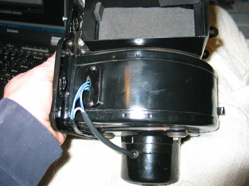

Anyway, got bored and worked on the heater blower. It was a mess, with broken bolts, non turning frozen motor, and of course the lack of low speed I discovered after getting the motor working again...
Sandblasted the case, painted with primer and semigloss black paint, and used leftover foam from Shanes heater rebuild kit to seal it up well. Had to spend way too much time getting the damn recirc door to move. I ended up drilling the spot welds in the pins and taking the thing apart, cleaning and reinstalling. Now theres a chance the fresh/recirc cable will be able to move the door.
Now I get to deal with the motor and low speed resistor. ended up pulling apart the motor, and it pulled the lower bearing out with the armature. Oops, time to find another motor. FSTmatt set me up with a good motor, so got after that. It had well worn and grooved armature commutator, but workable, and the brushes were good. Chuck the armature in the drill press and used a jewelers file to true up the grooves. following the file, I stripped W/D sandpaper into 1/4" strips and smoothed out the copper. it runs pretty true, and seems okay. I am SURE its not perfect and not the real way to do it, but after cleaning lubing and re-assembling the motor, it works amazingly well. dont forget to lube the bearings, AND the felt dealio's that surround the oillite bushings on either end. Dont be afraid of this job. If you have a soldering iron and digital camera you can easily pull it apart and get alot better heater performance. Use the camera to take a pic of the wiring inside the motor, since you will need to de-solder the connections to get the armature apart. De-soldering braid from Radio shack is well worth the investment. Toyota seemed to like solder, so getting the joints apart without will require quick and steady hands and a good chance of burning your fingers.
That left me with the damn lack of low speed resistor. the big black tube ceramic resistor on both setups I had were toast. Figured the load and age killed them, so I wanted a more modern option, IE not another ceramic tube style to eventually eat s*** again. Well, my GF Leah was feeling sick this AM, so I took the chance to get down to the junkyard. Came across an early toyota pickup(like a '73 or so-the ones with the similar side marker lights to our cruisers) and discovered it had interestingly enough, a two speed blower, and a more modern filament style low speed resistor, the ones that look like a giant light bulb filament, and are cooled by being placed in the air flow path created by the blower motor. Grabbed it and another out of another early pickup, and headed home(after finding an OEM toyota A/C underdash unit from the same Toyota pickup-which will be a rear A/C under the passenger seat.)
When I got back, I got right to modifying the wiring to work, and putting a hole in the heater blower housing to accomodate the new resistor. Be careful where you place it, it needs to be in the airflow, and you dont want the recirc door hitting it. I chose the lower chamber, near where the duct to the heater would mate. Dremel'ed a hole, drilled to holes for the sheetmetal screws, and soldered up the wiring to match. I will try to create a wiring diagram shortly, but its really simple, attach the wires in the same way you removed them from the ceramic tube resistor. Basically, the blue/black wire from the lplug attach to the same terminal that the motor blue wire attaches to. Blue and white from the plug attach to the other side of the filament.
got it all done, and tested it out with my power supply. Hi speed is amazing, I cant believe the heater blower motor can put out so much air. Not going to be a lack of heat in this thing. Lo speed is nice, a good break between Off and High.

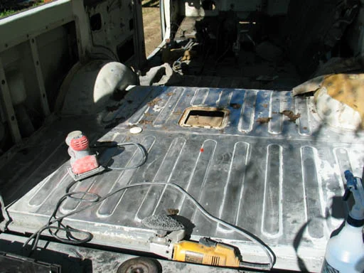

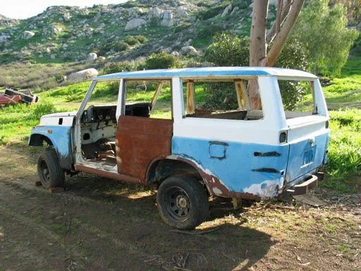

Here it is in all of its ugliness. It looked alot better before I stripped it of interior and front doors...
Anyway, floorboards are in the process of getting stripped down and zero-rust'ed. THe PO sprayed on (inside the truck) the floordoard what I think is that cheapo tar-ish rubber undercoating meant for under fenders, etc. It sucks to remove, but nothing like linex would stick to it, and it also tends to melt once it gets hot out...
Most of the rust is in the rear corners, and quarter panels. One hole in the floorboard by the front body mount like so many FJ55's have, but sound otherwise. Roof is in good shape, so thats a bonus for SoCal where so many seem to have succumbed to the rusty roof.

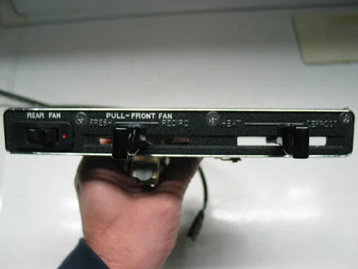

Nice!! How do you remove the window up/down knob from the plate? Does that trim piece unscrew? I couldn't figure it out last time I was out to the barn. I'm doing the same thing you are, but for different reasons. I'm in college right now, so doing the little stuff is really all I can do!!
