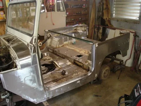

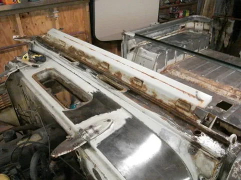

I've been wanting to get the tub braced up so I can start rust repair. I work from home the majority of the time, and it's a bit of a drive to town from here. I'm pretty lazy about going to pick up materials/supplies. When I do, I never seem to remember everything I need to get. Finally had a light bulb go off the other day. I've got tons of 7 ft. "T" posts that I use to stake tomatoes. Perfect! Got the first one tacked on at the door posts. Went ahead and removed the tool box too, to get that out of the way. Made it a lot easier to work under the dash.

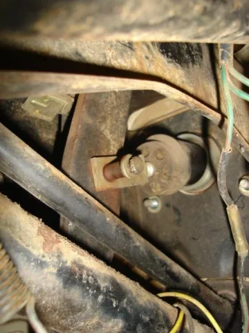

I've been hung up on a couple things trying to clear off the firewall/dash/cowl. I've been fighting with the pin connecting the brake pedal to the booster for a while. That was a good feeling when it finally gave way.

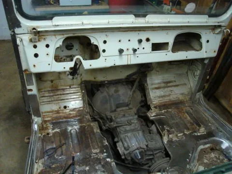

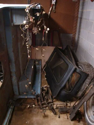

Finished taking out the pedal assembly/bucket, etc. and pulled the wiring harness through the firewall.

Finished labeling and pulling the wiring harness. I'm planning to clean it up and re-use it. Luckily, it hasn't been touched before. :)

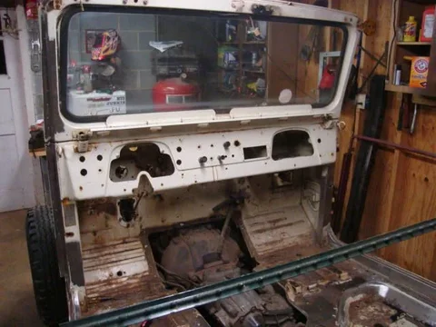

Pretty much got the dash clean.

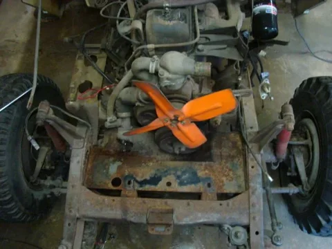

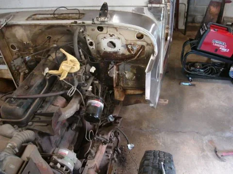

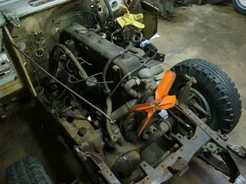

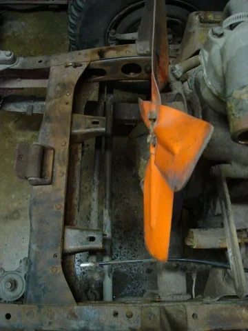

Moved on to clearing parts from the frame, and engine. Drained and pulled the radiator. Pulled splash guards, shocks, alternator, battery tray......I've been pleasantly surprised by how clean and easy the bolts are coming out in this area. I've been prepared for lots of broken bolts. I guess all the pb is paying off . :)

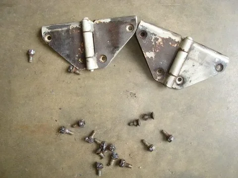

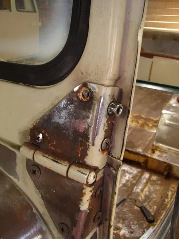

And here's something I've been putting off.....The windshield hinges. I've been spraying them since I bought this thing. I have a go at the bolts every so often, but have been frustrated to no end. Tried heat. Could only manage to break three loose no matter what I tried. So I decided to clean up the heads and weld nuts on. Winner.:clap: I can't tell you how glad I am to get those :censor: hinges off! :D

Nice job on the hinges. I'm gonna keep that method in mind for when I get to mine.

Thanks! The only thing that I would have done differently would be to use a smaller hex nut. The only weldable nuts that I had on hand were 13 mm. It didn't leave much room to get good bead contact on the bolt head, and not weld the bolt to the hinge. I had to be really careful not to "clean" the hinge itself around the bolt. Had a couple make a tiny bit of contact, that I had to cut with a hacksaw blade.
