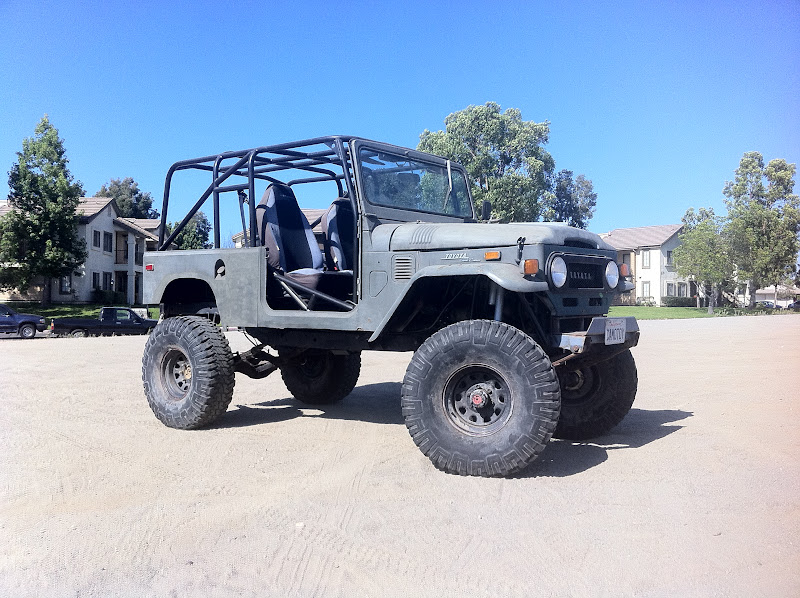

drove the fj around the block, feels good to get it out and driving around. :D still lots to do but nice to get it out.

still dealing with all the little stuff. but decided to drive it around the block a few times to see how it runs.
