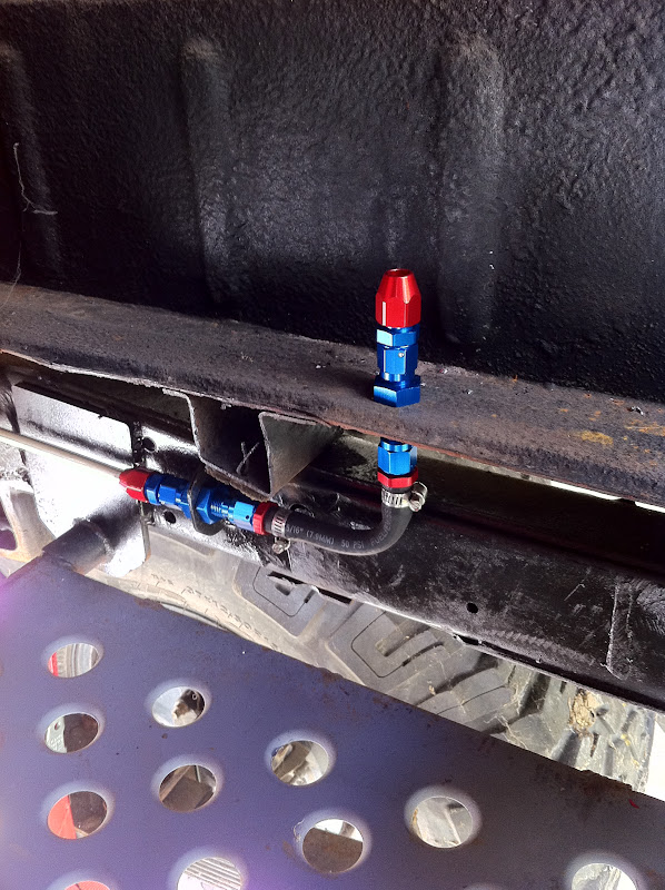

new lines from the cell to a bulkhead on the body.
an a pic from the body to the frame. from there its ran above the frame to the front of the truck. has a rubber line from the body to the frame for some room to flex.
