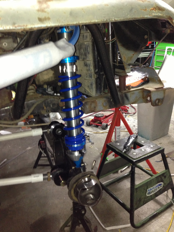

put the shock in place and man nothing is right :doh:
shock is to close to the lower panhard mount, and touches.
the upper shock mount is now to low (was measured with a non coilover and the new shock is a few inches longer even though its still a 14" travel shock
i need to finish the front axle so i can put tires on it and see where the upper limit is then redo the shock mounts and probably the whole front tube work :doh:
FFFFFFFUUUUUUUUUU
i just dont know what to do anymore :laughing:
so looking at this pic that is max up travel. the upper link hits the motor mount and the panhard bar hits the frame (already notched) and almost the crank pulley.
and this is almost where ride height would be. maybe an inch down. so one inch up uptravel and i don't think that's enough. kinda seems stupid to have 6" of fender there and not even be able to get the tire to come close during stuff.
anybody have any ideas?
oh well this was just painful.
cut the front off and started over. the shock hoops were 4-5 inches to short to work with the new coilovers and the way they were built it was going to be a bitch to make fit. so off with the frame to redo it all again lol.
