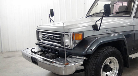

I actually drove this FZJ75 last year. I really like these trucks but this specific example was beat and they were asking $50K... I would have paid $20K haha but that's how the market goes. I actually know the prop house that ended up buying it and put a DShK on the back

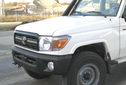

Here for the falcon stripes. These fetch higher prices here in the GCC just because of a decal. weird looking grill.

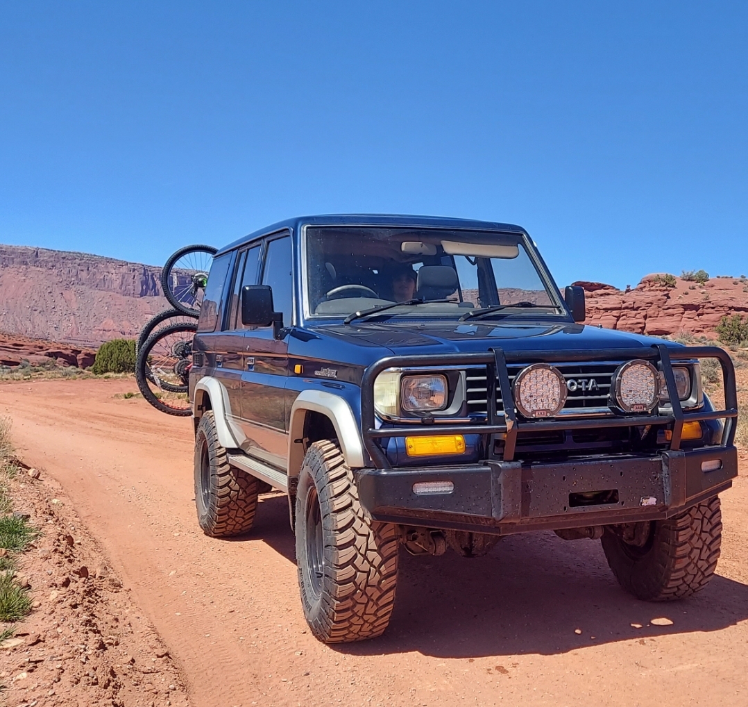

HZJ76 would awesome, I'm excited to see what imports look like in the next 5 years. I wanted a 70 series wagon so I have room for kids and am enjoying the KZJ78 I acquired for under $20k in 2021. The Pickups look sweet but I understand they are tight. I'm drawn to these rigs more than most new SUV's at least for how I want to use them. I just ordered a few hundred dollars worth of trim parts, snorkel, mudflaps, etc. from UAE for a fender/paint refresh that are currently in production and applicable to pretty much all 70 series wagon models. Many mechanical parts on the KZJ's are compatible with 90's 4 runners and FJ Cruisers, I have even had my ECU rebuilt by a USA rebuilder. Aftermarket accessories for 70 series wagons are widely compatible as well. The VDJ76 still being produced helps with a lot of parts availability for most 70 series wagons. I am quite pleased with the power and efficiency of the 1KZ-TE engine that was widely used in many vehicles and markets so parts aren't exactly difficult to come by. There are some known weak points and mods to help them run cooler with fewer issues. I would be hosed if I needed replacement body panels. While not as robust as the 1HZ engine, I think the KZJ's are still a great option depending on what you want to use the vehicle for. I personally find this thing a blast to daily drive and offroad. The coil suspension front/rear is a smooth ride. In short, if you want the price tag to be <$25k go for a KZJ78, if you got to have the 1HZ and prefer leaf springs over coil suspension for extreme duty 70 series and are good with purchase price of >$40k that would be the way to go. Here we are at Onion Creek in Moab. 3 kids, 4 bikes and gear for a quick weekend of fun.
HZJ76 would be great all around, I'm excited to see what imports look like in the next 5 years. I wanted a 70 series wagon so I have room for kids and am enjoying the KZJ78 I acquired for under $20k in 2021. The Pickups look sweet but I understand they are tight. I'm drawn to these rigs more than most new SUV's at least for how I want to use them. I just ordered a few hundred dollars worth of trim parts, snorkel, mudflaps, etc. from UAE for a fender/paint refresh that are currently in production and applicable to pretty much all 70 series wagon models. Many mechanical parts on the KZJ's are compatible with 90's 4 runners and FJ Cruisers, I have even had my ECU rebuilt by a USA rebuilder. Aftermarket accessories for 70 series wagons are widely compatible as well. The VDJ76 still being produced helps with a lot of parts availability for most 70 series wagons. I am quite pleased with the power and efficiency of the 1KZ-TE engine that was widely used in many vehicles and markets so parts aren't exactly difficult to come by. There are some known weak points and mods to help them run cooler with fewer issues. I would be hosed if I needed replacement body panels. While not as robust as the 1HZ engine, I think the KZJ's are still a great option depending on what you want to use the vehicle for. I personally find this thing a blast to daily drive and offroad. In short, if you want the price tag to be <$25k go for a KZJ78, if you got to have the 1HZ and prefer leaf springs over coil suspension for extreme duty 70 series and are good with purchase price of >$40k that would be the way to go. Here we are at Onion Creek in Moab. 4 kids, 5 bikes and gear for a quick weekend of fun.
