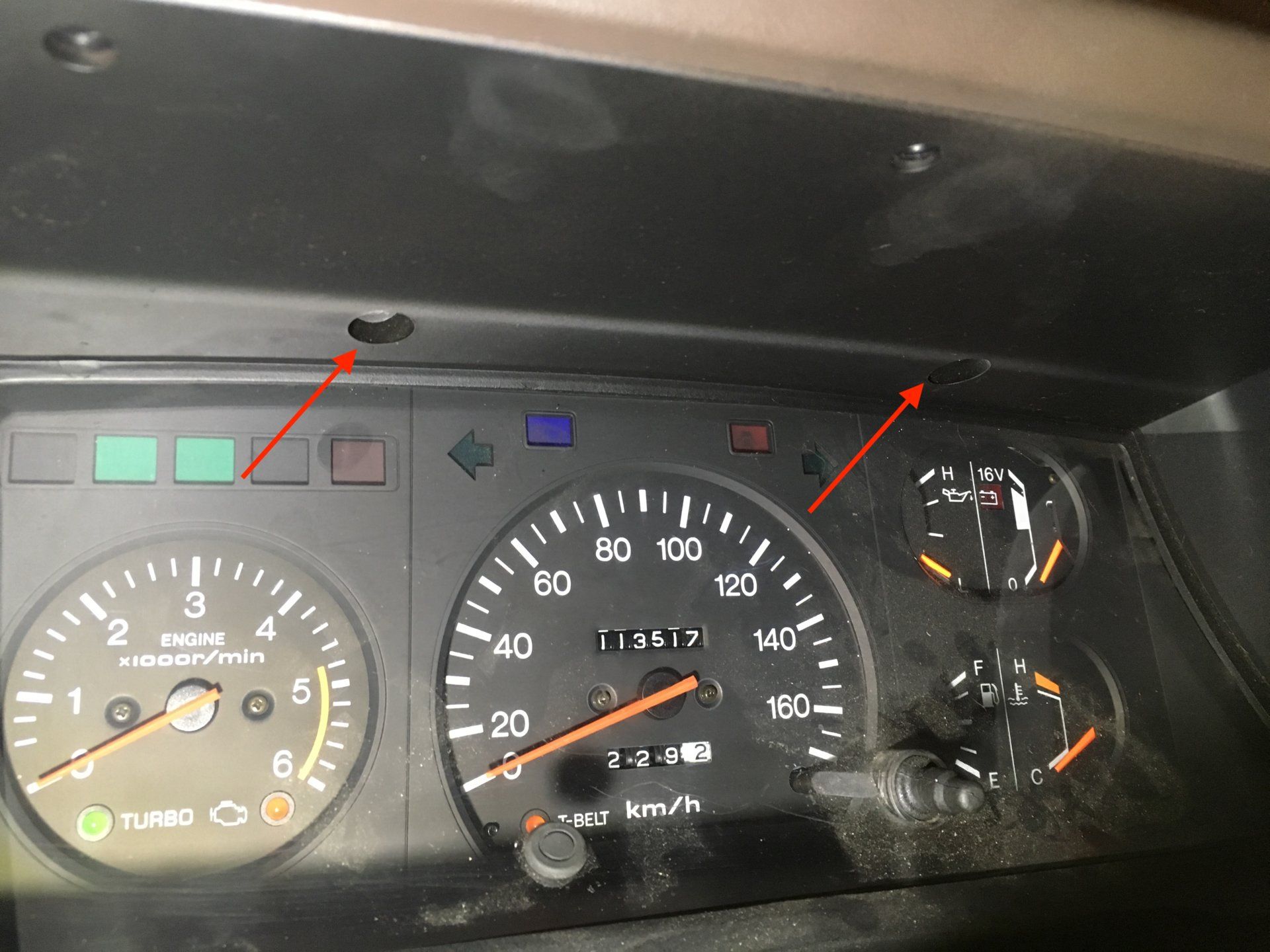

To remove the gauge cluster take out the six screws that hold on the plastic housing.
There are two plastic tabs at the top of the surround that hold it into the metal dash; it takes some wiggling to get them free without breaking them.

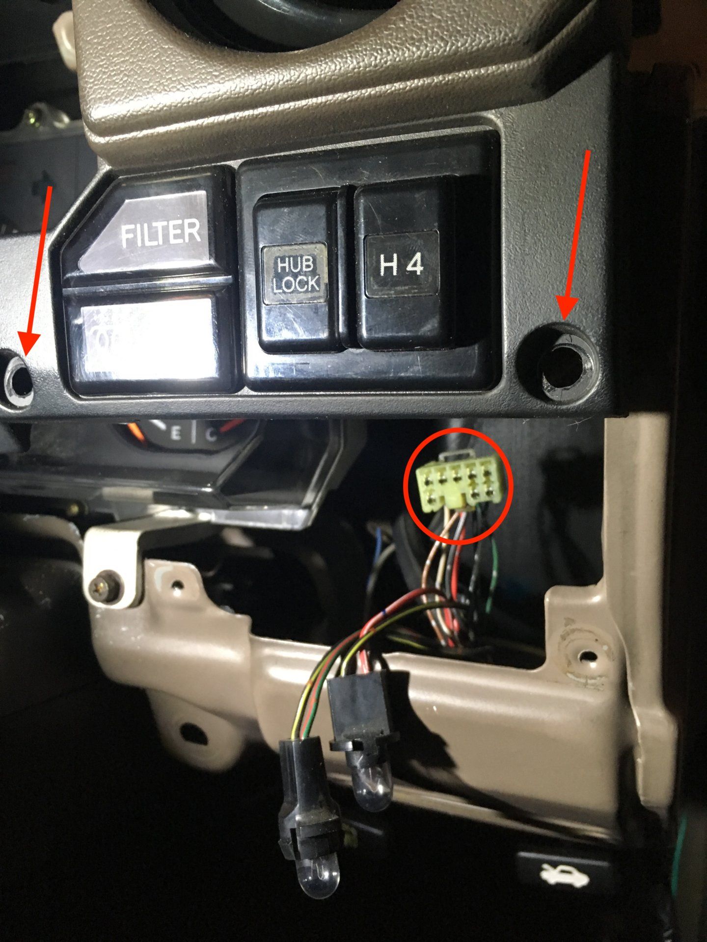

Then there are the plugs for the 4WD and mirror switches and the lights for the filter, PWR and glow lights.

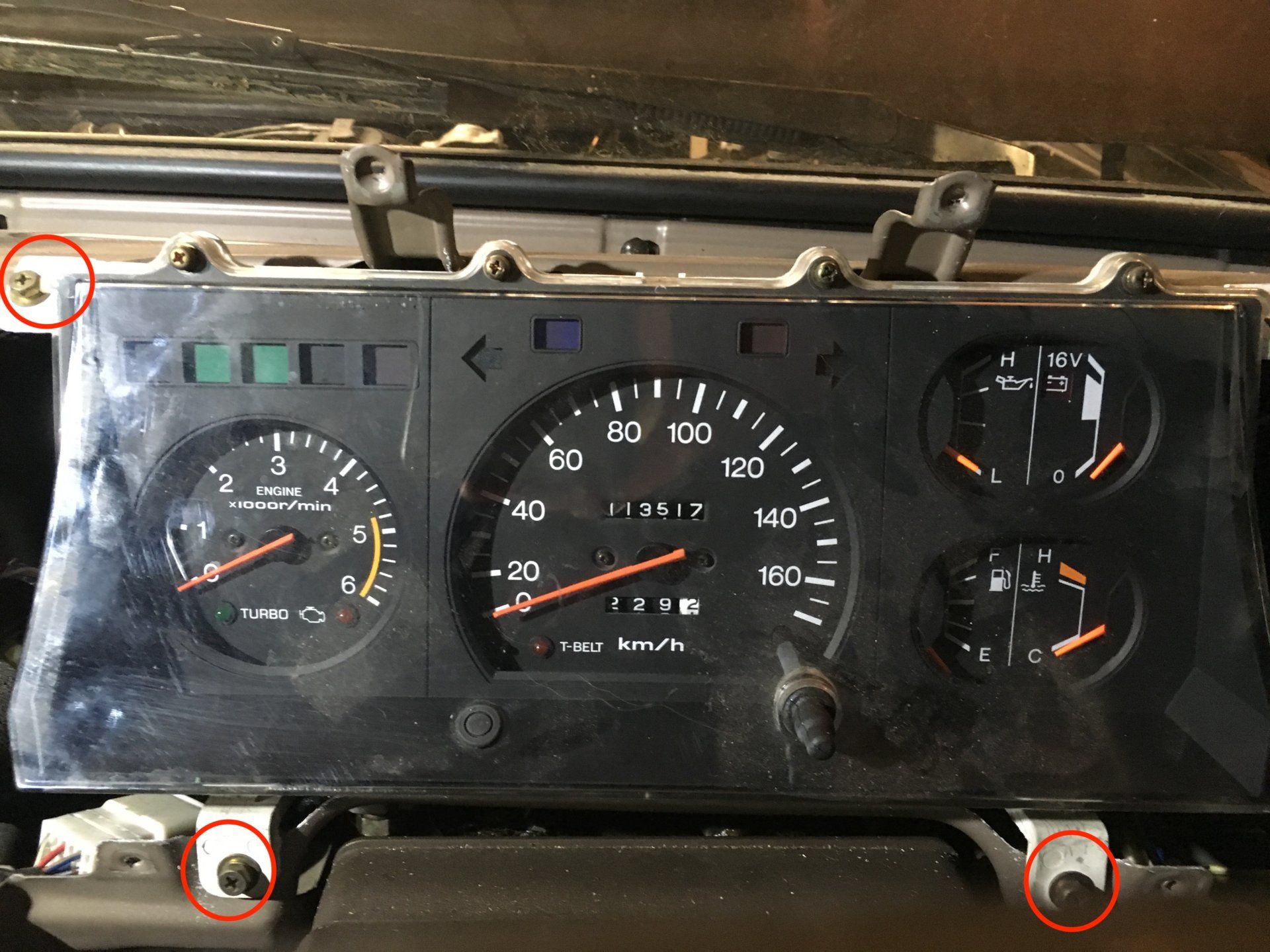

There are four screws that hold the gauge cluster in; only three are in the photo.

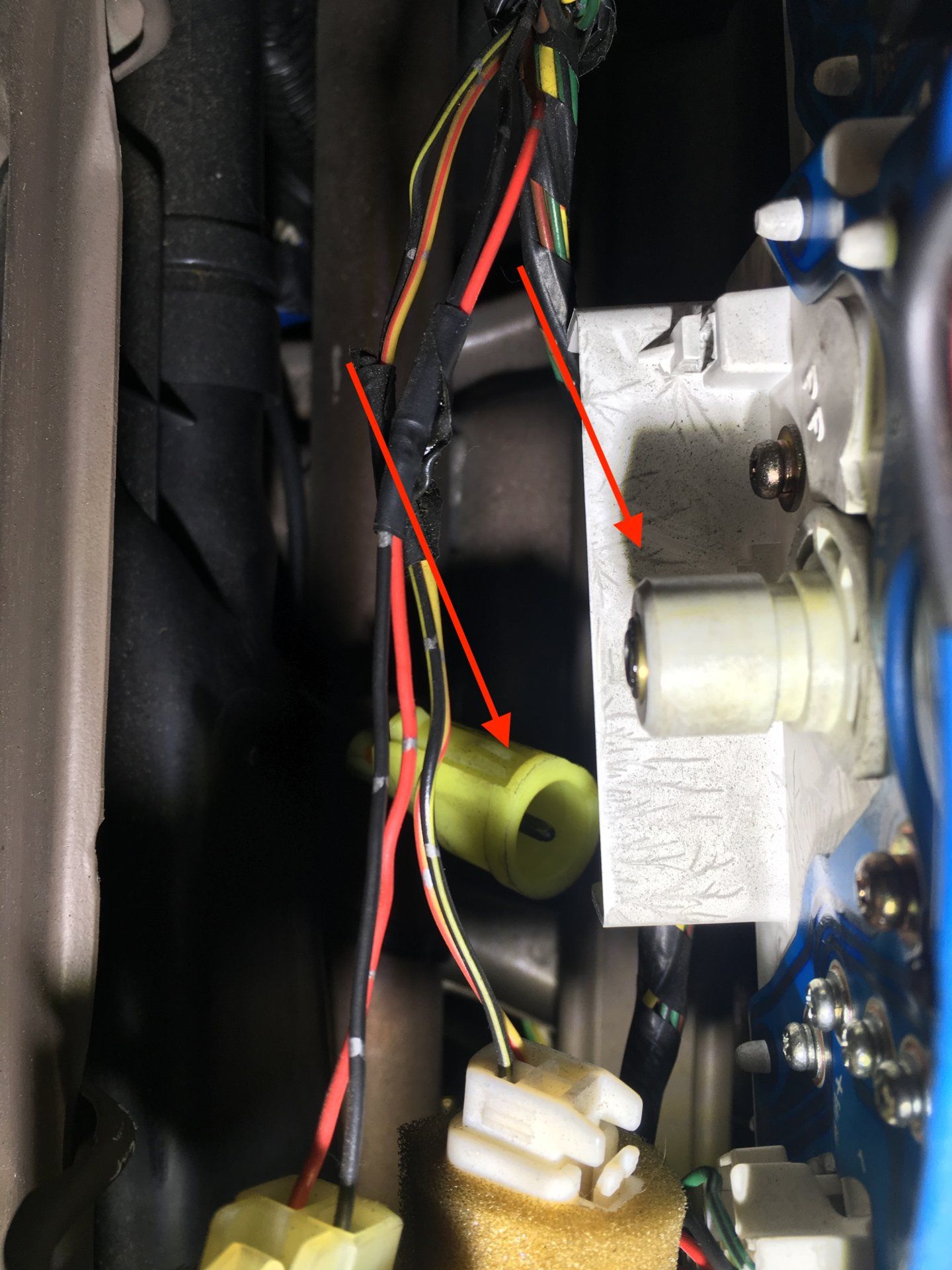

Once these are removed you will need to unhook the speedometer cable; this requires undoing it from a bracket in the footwell to get enough slack to pull the gauge cluster out a couple of inches. Once that is done you will be able to reach behind and detach the cable from the cluster. There is a single squeeze tab on the end of the cable.
After that it is just a matter of unplugging all of the electrical connections on the back of the cluster.

I couldn't get a decent photo of it, but the speedometer cable comes up along the inside of the transmission tunnel and then across to the brake pedal brace before heading up to the cluster. There is a little metal tab on the forward part of the transmission tunnel and a plastic clip on the brake pedal brace, if you unhook it from those it should give you enough room to slip your hand behind the cluster to unhook the connection there.

Here is a pic of how it looks from the top. I did exactly what you did to disconnect the cluster from the cable when I replaced my whole speedometer cable with a new one. Not a fun job.
