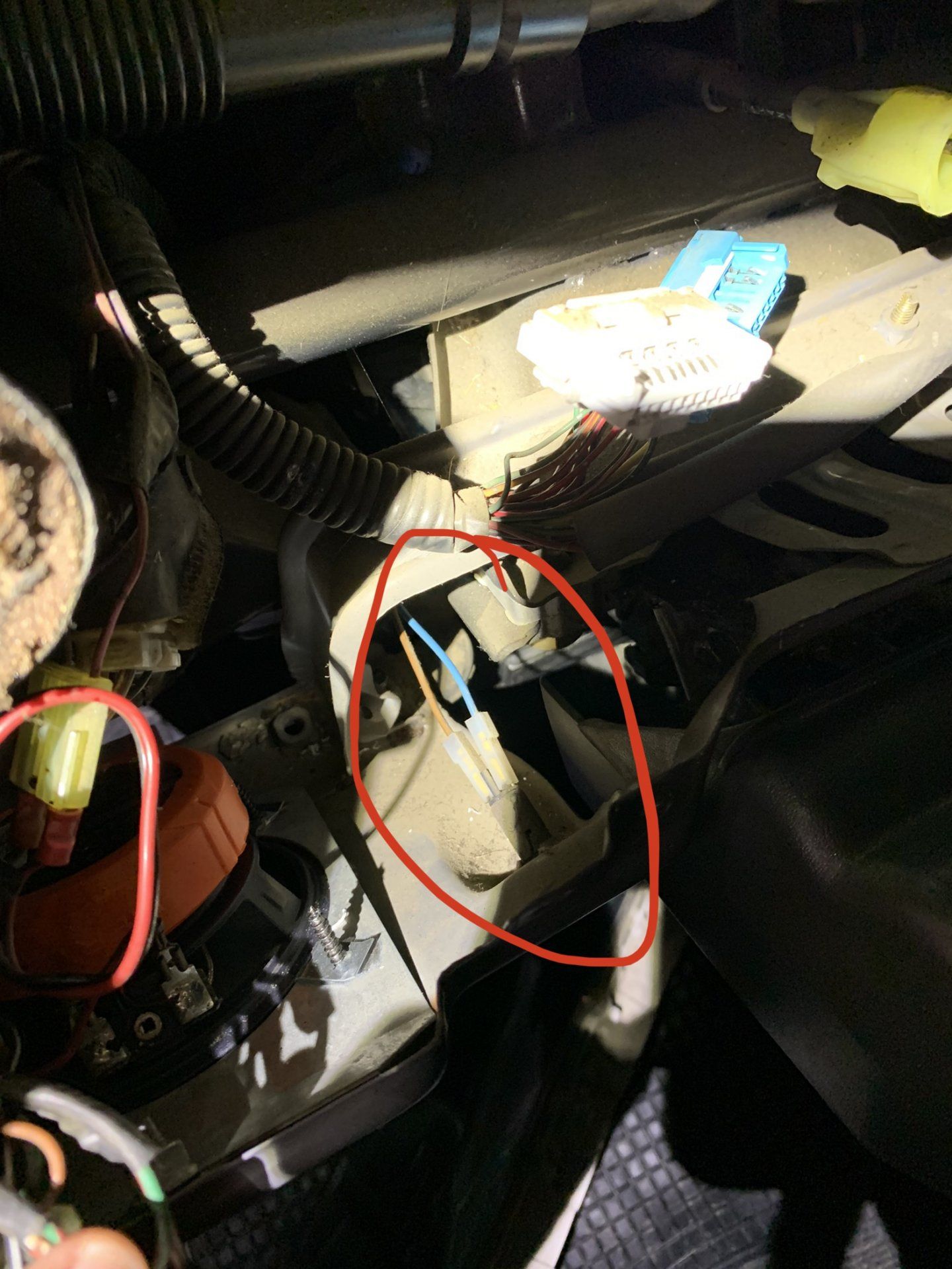

1. Knows somebody maybe what is the green knob under the dash with blue and brown wires?
2. Some ideas about the white socket?
(3. I've got some oil leaks on the engine. Am I allowed to start a new diskussion/thread under the forums here on ih8mud about it?)
Glad it worked out for you! To attempt to answer your other questions:
1. I have never seen a button like that one, it looks like an aftermarket item. Is the symbol on it perhaps a tow ball? If you can trace the wires and find out where they go it might shed light on what it was for.
2. Not sure about the white plug, but it is possible that it isn't used on your vehicle's particular specification. I don't see anything quite like it in the Europe/General market wiring manual, but the shape of it makes me think it is a harness connector; if it does plug into something it should be fairly obvious since it is a large plug.

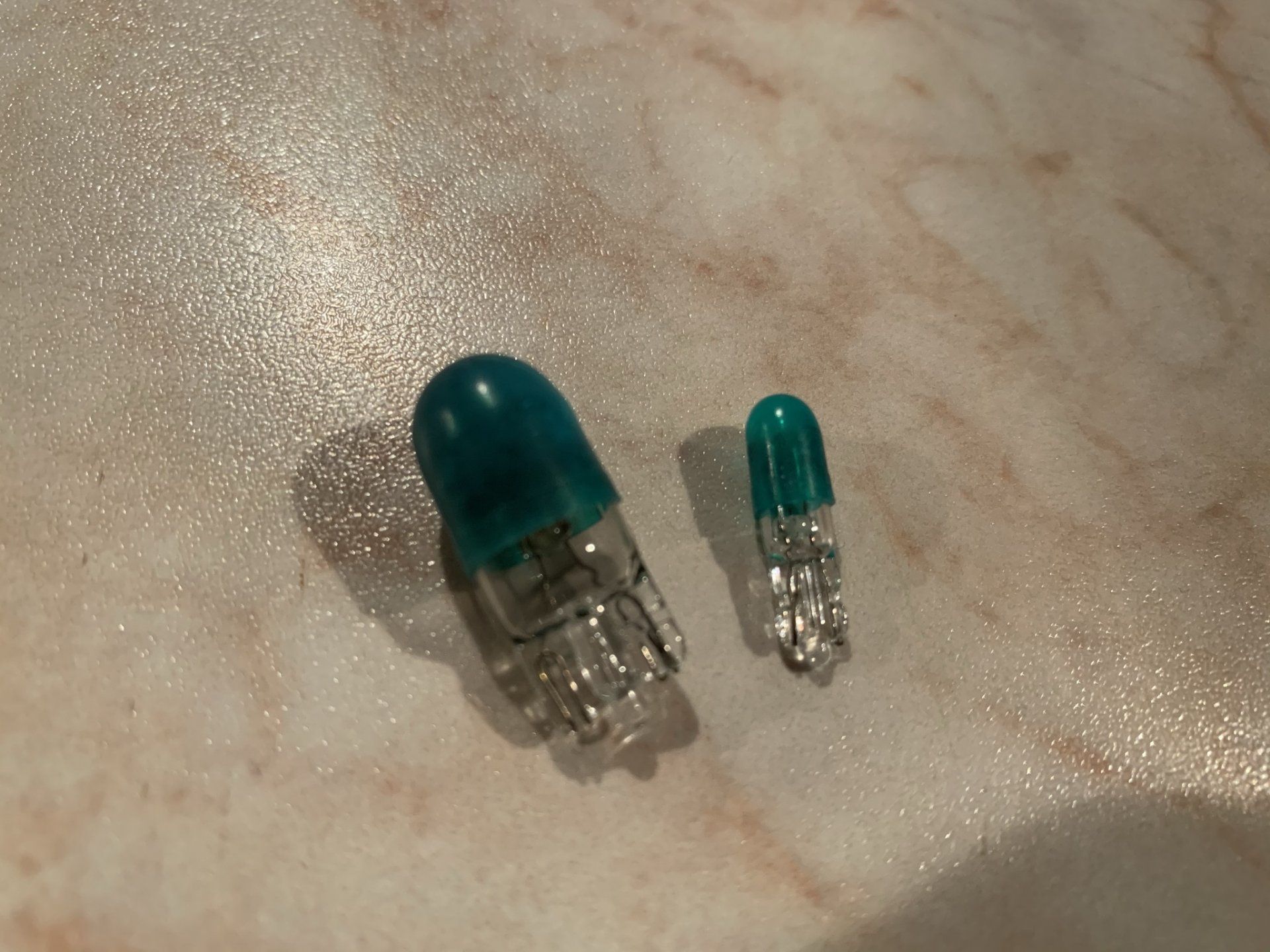

As I mentioned I changed all the bulbs. Have got somebody maybe any idea where can I buy this kind of silicon caps for them?

The green cap is available from Toyota. I remember seeing the part number on this forum.
These caps go out with a little persuasion. You may want to take it out, clean it and reuse it.
Or you might replace it with a green LED.

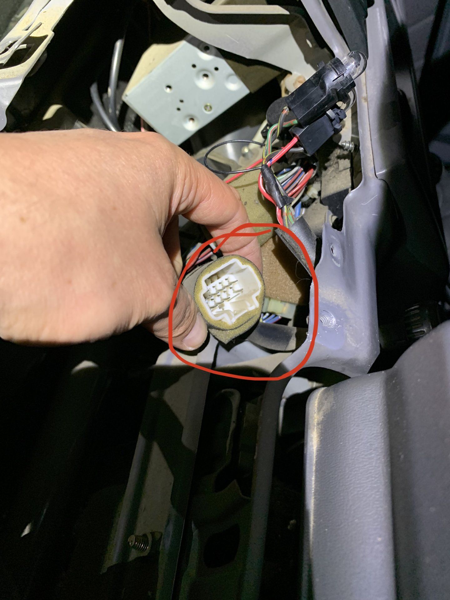

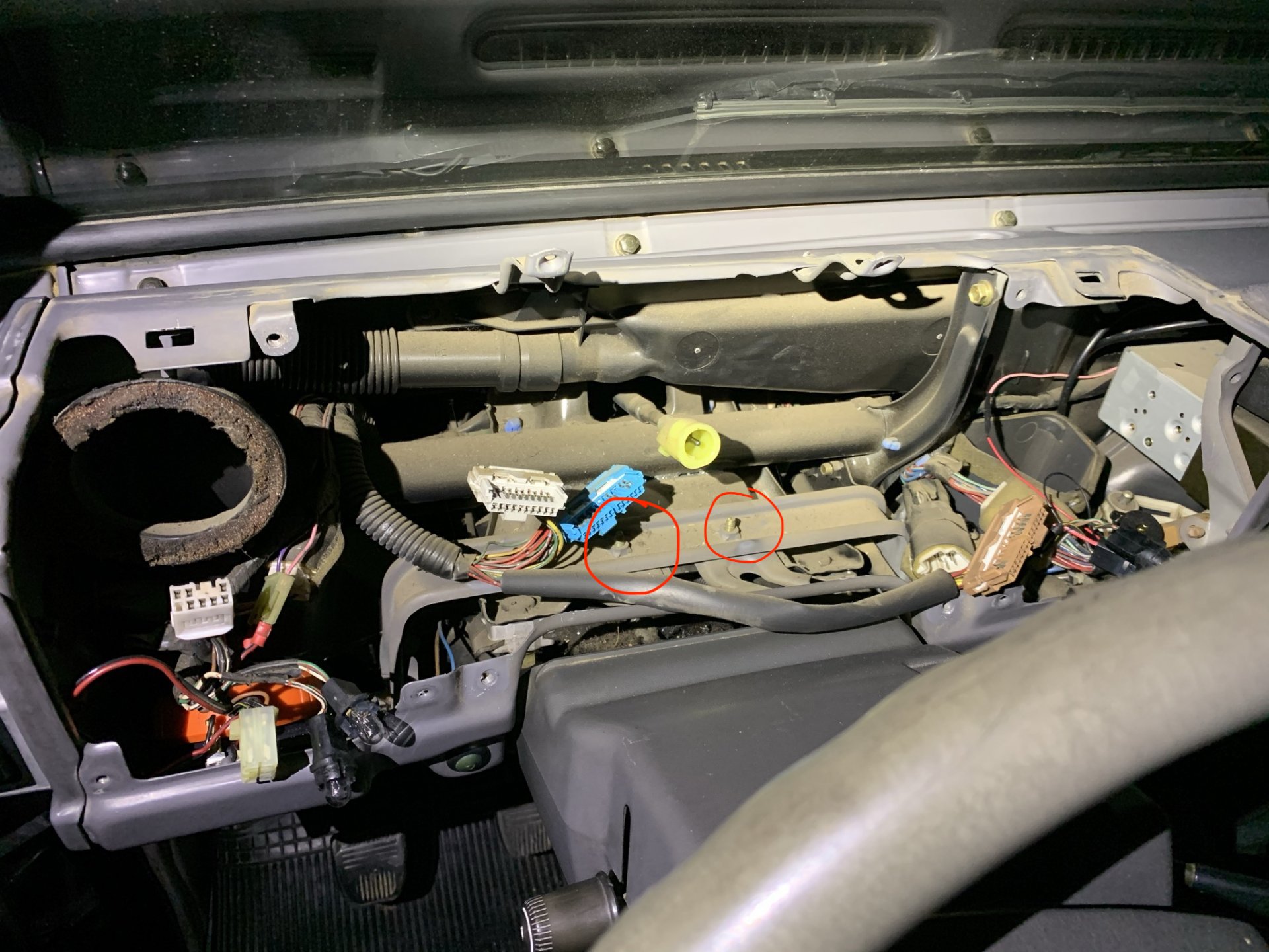

Hey guys, I’m currently doing this job as well. I basically removed everything but I’m having trouble on disconnecting the connector of the diff lock. Someone has any idea or have done it? There is no space on the back of the connector so it’s really hard to access to it and I don’t understand if the black face here is supposed to go out somehow? Thanks for any help!
Hey guys, I’m currently doing this job as well. I basically removed everything but I’m having trouble on disconnecting the connector of the diff lock. Someone has any idea or have done it? There is no space on the back of the connector so it’s really hard to access to it and I don’t understand if the black face here is supposed to go out somehow? Thanks for any help! View attachment 4216631View attachment 4216630
So I managed to do it. The trick is pushing these two tabs of the whole assay. It’s tricky because there is no room. With a screwdriver push from the side meanwhile push forward the whole assay. One tab of the time.
