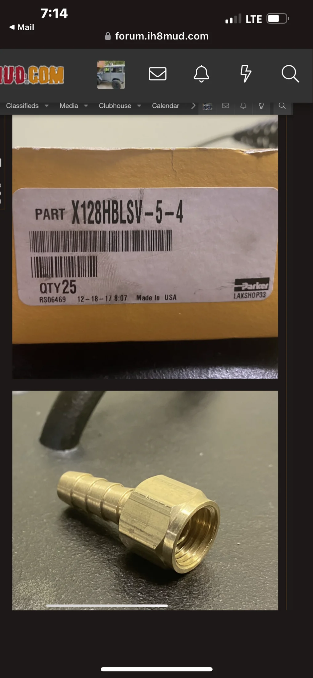

Well thats all good info for a stock 68 tank but the tank in op's last pic is not ? The Parker fitting number is good to have, thank you.
Can anyone confirm if that Parker fitting # will fit a stock, underseat, fj40 tank ? and I guess whatever tank is in that last pic.
I purchased this replica tank from CCOT ( sorry don’t remember part number)
The Parker fitting fit perfectly. CCOT also sells a non acorn design.
my tank sits inside my 68. The tank I believe is from the 70’s I purchased from CCOT.
The CCOT fuel connector fits multiple year models as listed below. The two differences from the Parker is: The Parker is an acorn type and it has a 5/16 barb. The CCOT is one piece and 1/4 inch barb I believe used in OEM applications. Both Parker and CCOT will fit OEM tank.
I hope this helps

Sorry I don’t know if the Parker fitting will work on earlier model tanks. The Parker will fit on 68-72 models.
I would definitely call Cool Cruisers of Texas
They are very knowledgeable about earlier models. I assume the threads are the same size, but I don’t want to tell you something I’m not sure about.
The Parker has a 5/8 barb and I’m running a 3/8 fuel line…. It’s been running great for the Chevy 350👍

The early tank is also 13x1.5. I know because I buggered one and had to buy a die.
