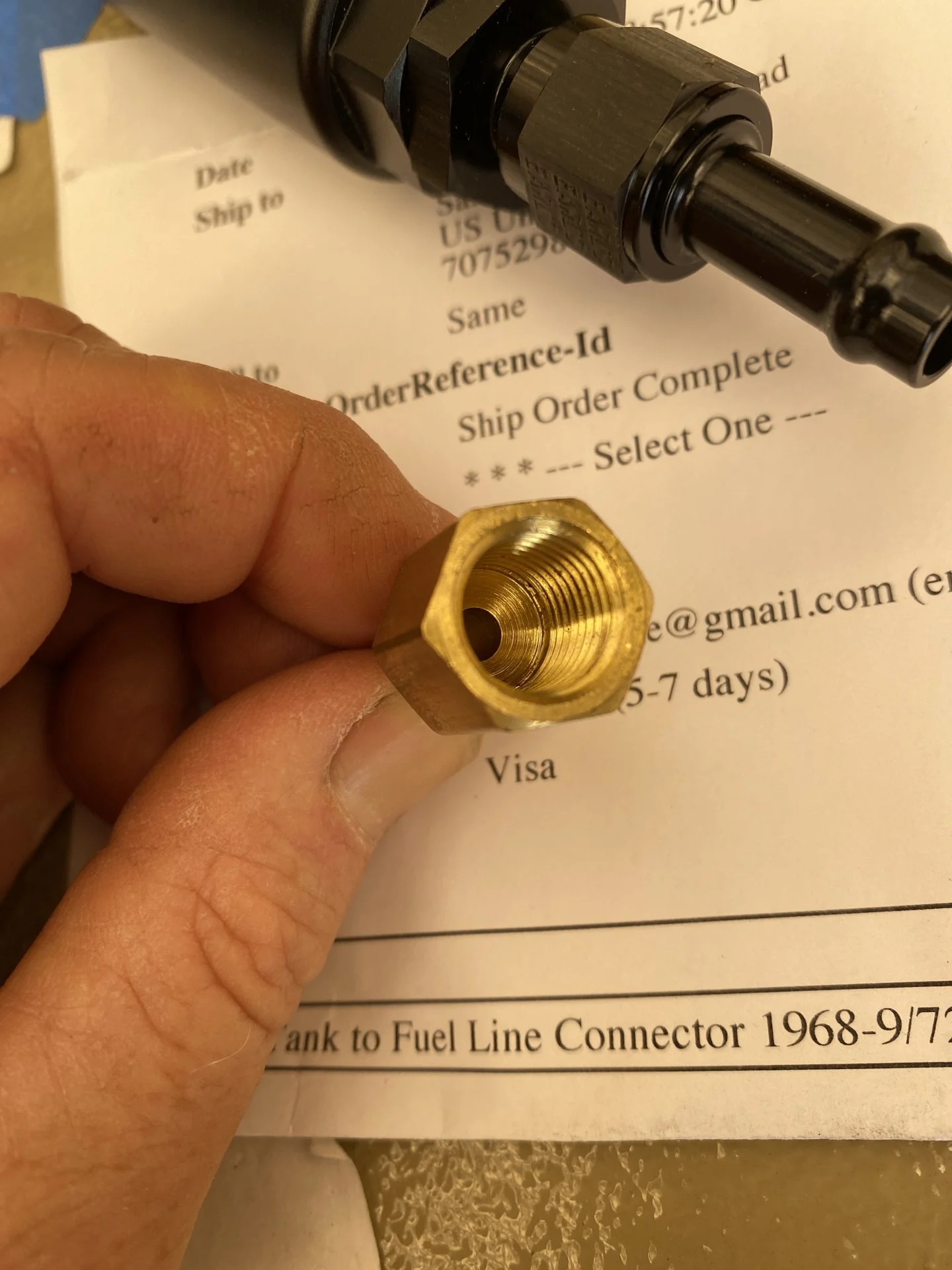

My 68 restoration came with a 283 conversion already installed. I put in a 350 with an EFI requiring a 3/8 fuel line. I’m in need of a fuel line connector with a 3/8 barb. CCOT sells the 1/4 barb and does not offer a 3/8.
What size is the thread for the connector ??? 12mm 1.25 pitch?? CCOT says it’s 12mm but they don’t know the pitch.
I found 12mm 1.25 on line but they don’t fit???? I’m at a loss

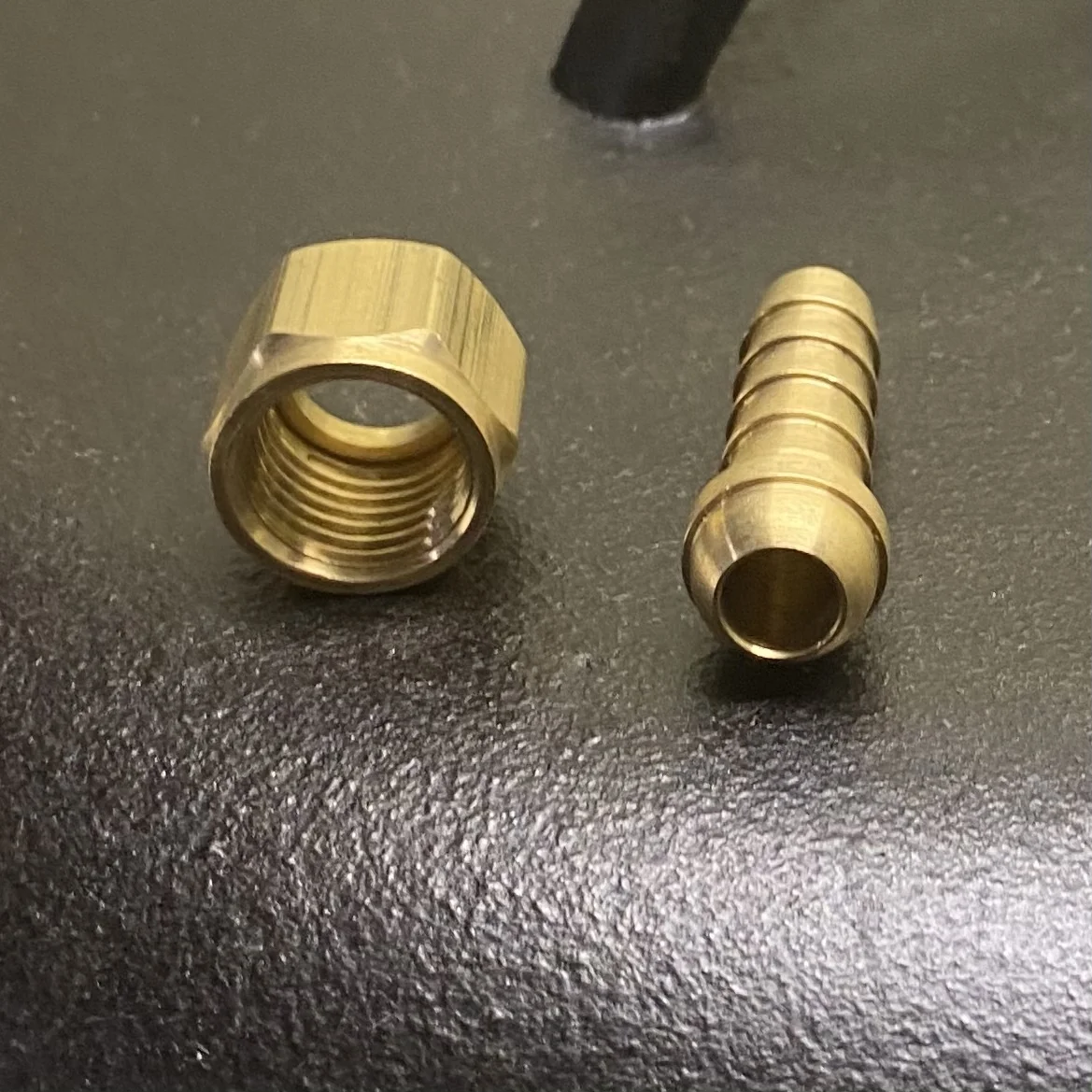

Threads on the tank are M13x1.5
OEM Parts are
Nut - 90402-13041
Olive - 96395-71400
Barb - Unsure if available.
Ive welded up the nut to make a block-off plug when installing an in-tank setup.

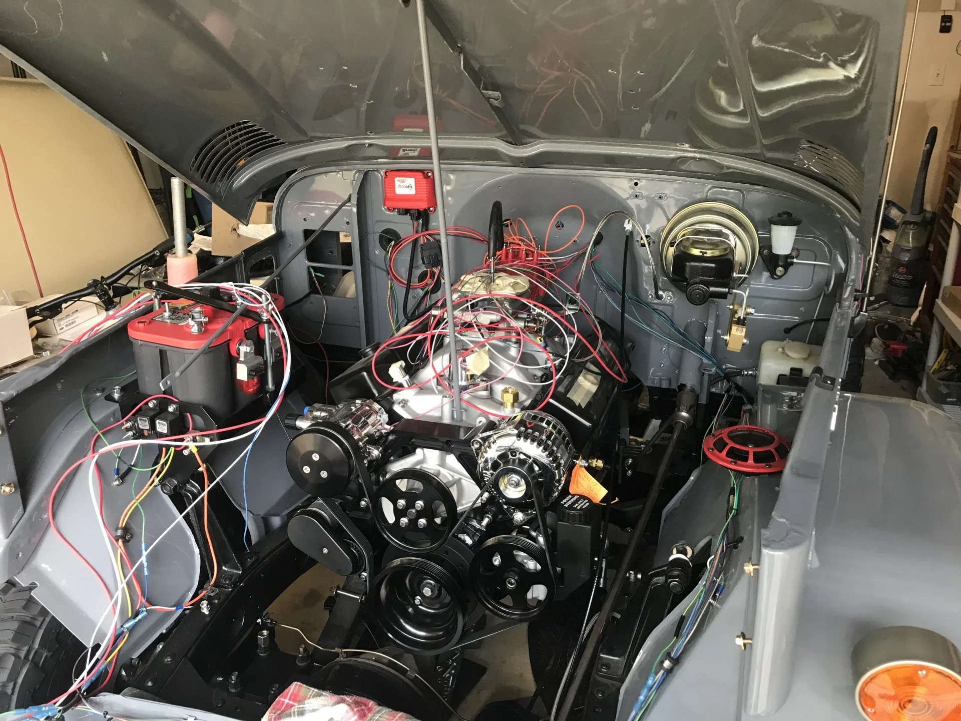

Thanks for all the info, My 3/8 line is holding fine so far…… I’ll let you know how it goes when I get it started this year….fingers crossed 👍
Just wanted to follow up on this. Any leaks? Anyone have a new solution? Not seeing much in terms of thread type online lining up with the metric threads posted here, so just wanted to check in on it before ordering. Thanks!
I haven’t cranked it yet, but getting close. The 3/8 hose on the barb is a little loose but north bad. The clamp works well and holds good.
Just ran plug wires today.
sorry I don’t have any info yet?
