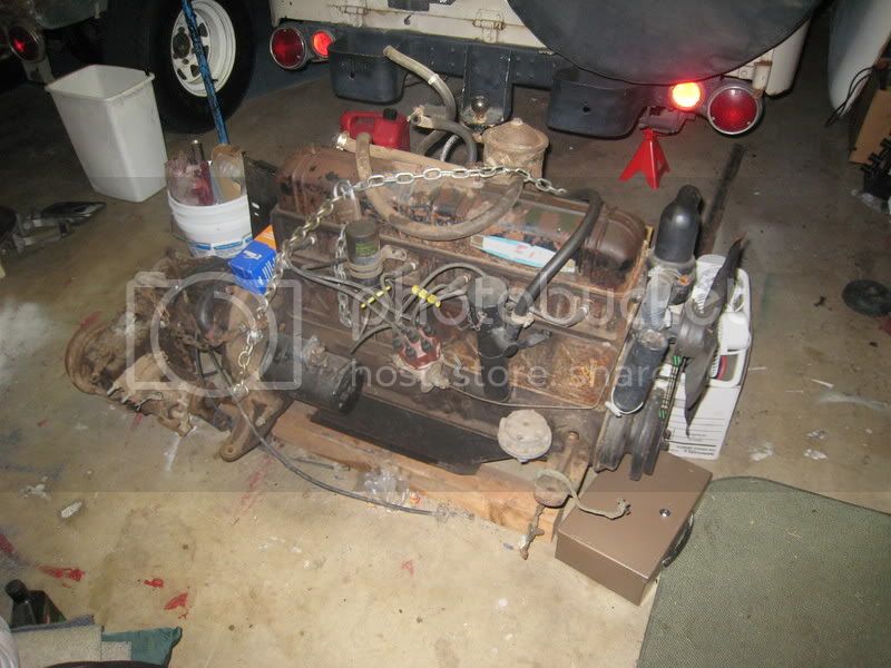

known 64' drivetrain that I'm selling for two hondo and pick up only.
I'm located in Fontana, ca. 92336.
I lost my original intent and it is only taking up space in my garage and I would rather see it put to use. I'm now shifting my focus on McSpanky FJ55.

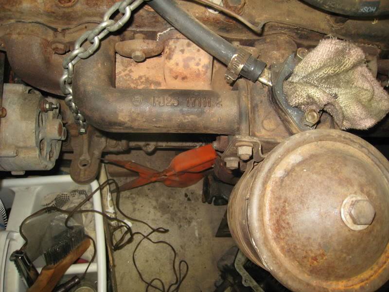

Hey just noticed that the intake sayes fj25

Don't get too excited Art, This is 1964 drivetrain, Toyota used the siamese intake and exhaust from the 25's till 1965. Tail lights in photo are not 25's. PTO in photo for a 40 on the ground. Good luck, John

Here's question for you John. Did Toyota use the early style vacuum shifter like this one has after the mid 63 transmission change? I've only seen these on the early style three speed transmissions. Of course I haven't seen that many mid sixties tranmission/tranfers. Seems I remember that the later style vacuum shifter will work in place the earlier style if it goes bad. I've never tried it myself.

Pardion: I've been amazed on how people can/have dissected the images post here on mud, I don't think I would have ever noticed the PTO drive just sitting there. I sure now it is in my garage but didn't notice in the picture. And yes, your right, there are two 71 40's in my garage and the pto is for the tan one.
John
If it has the four bolt configuration to mount it to the front output housing, it will interchange. It's been a LONG time since I went digging thru the fiche for that info, but IIRC, the early shifter was used until 65.
