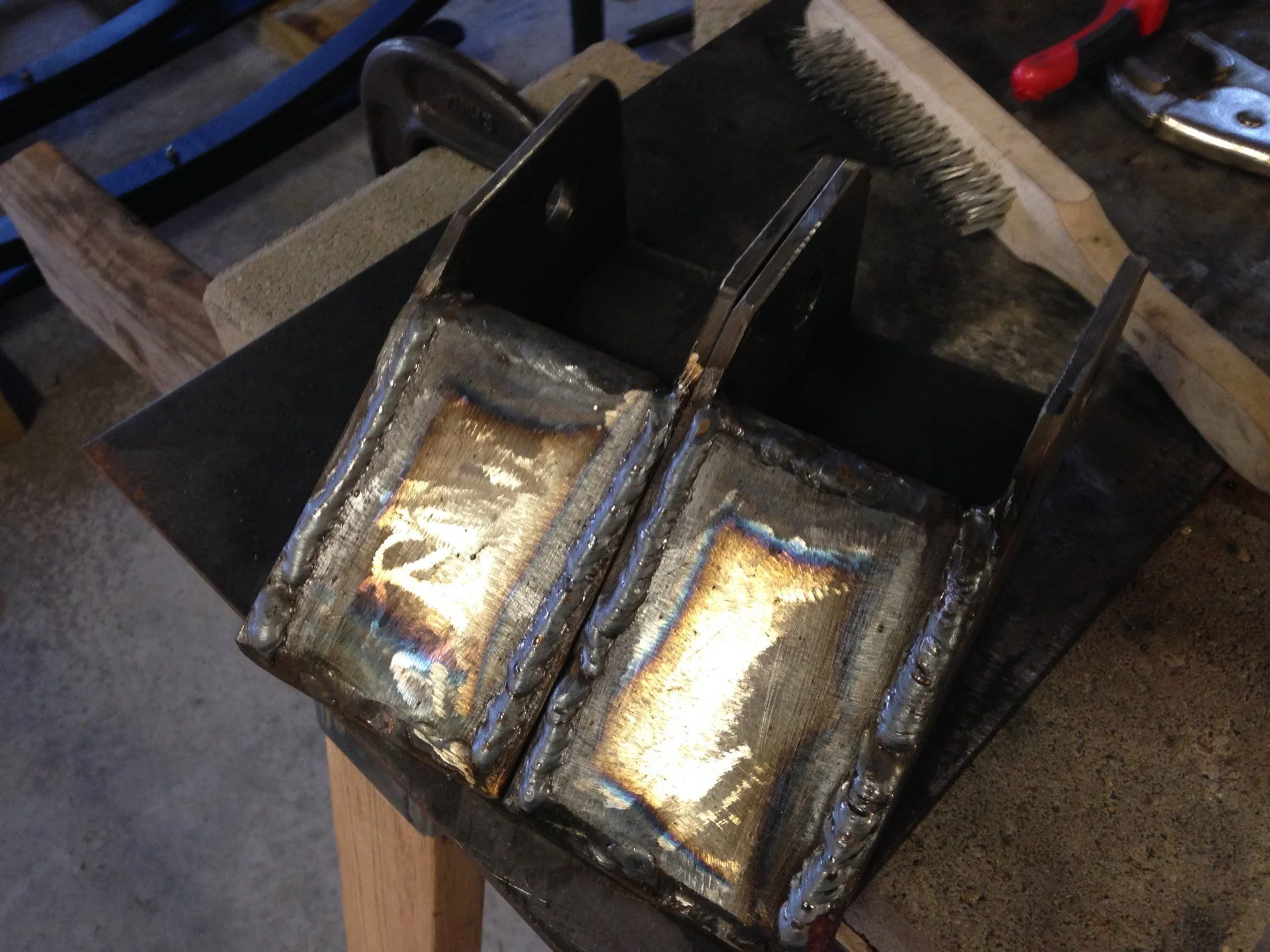

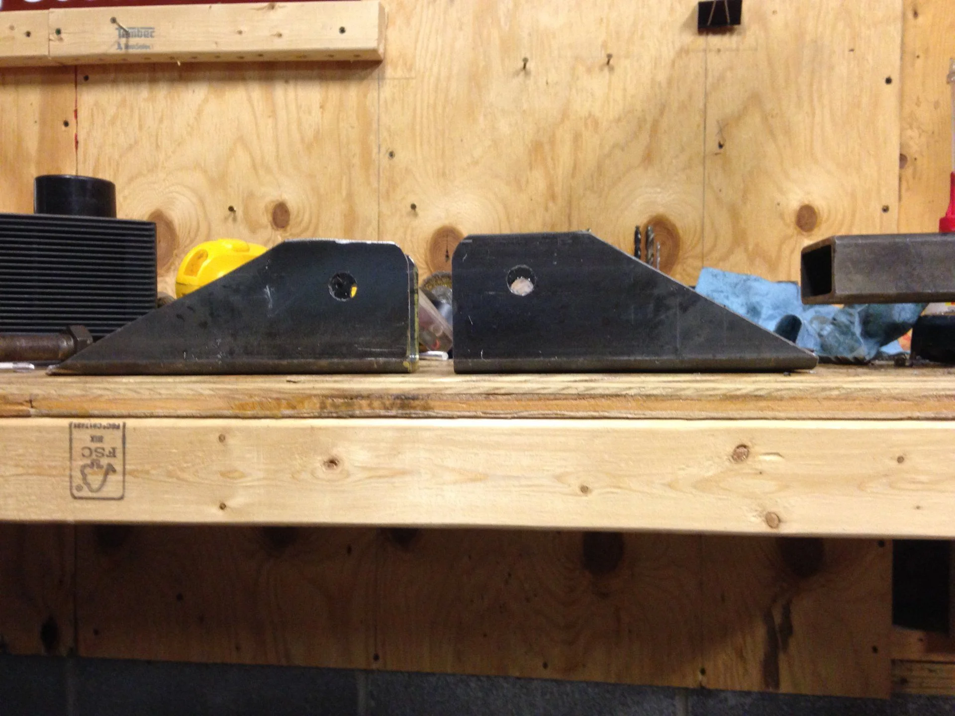

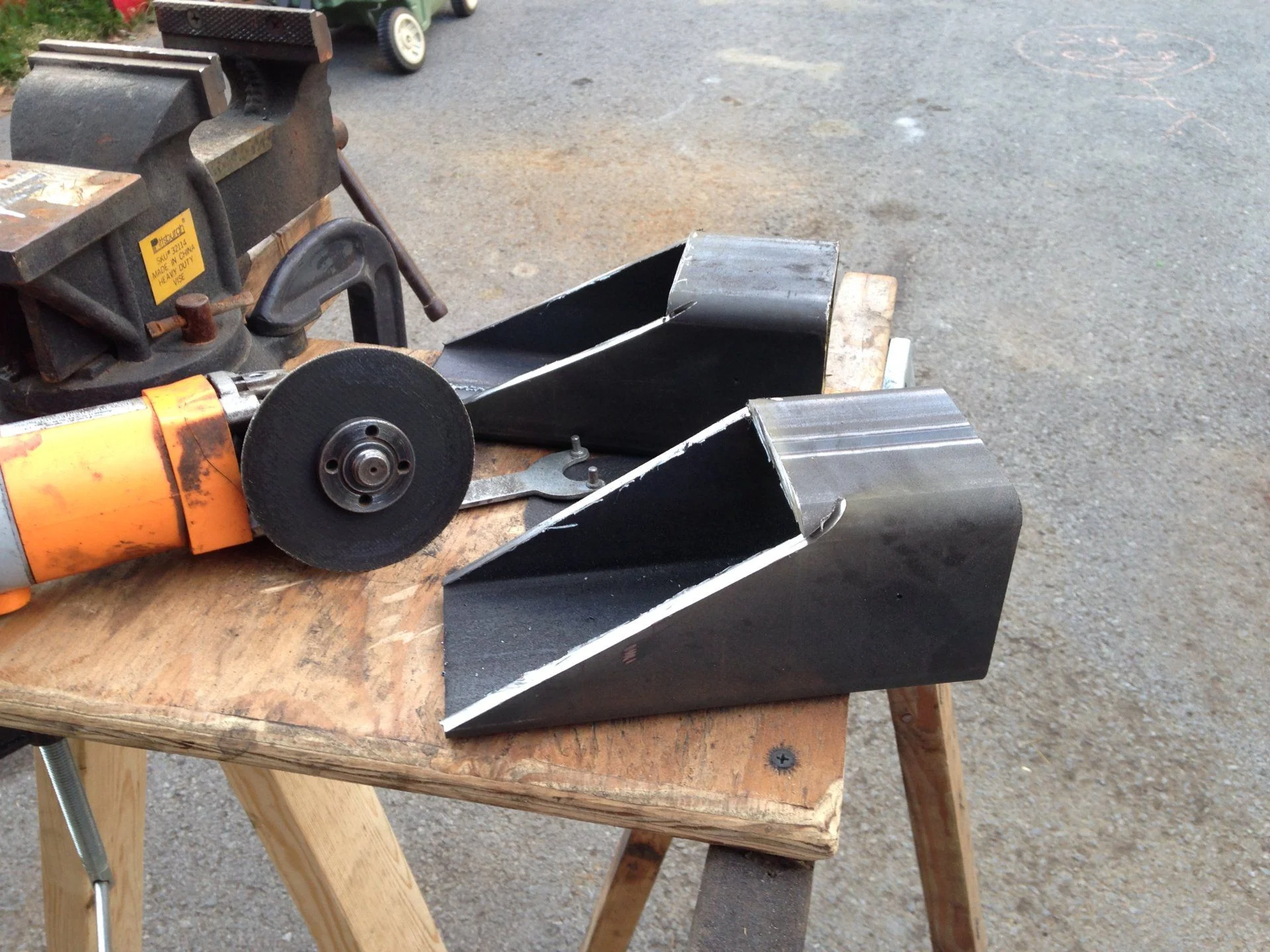

Made my own hangers with an angle grinder and cut off wheel then cleaned with bench grinder. For the time it took would have been cheaper to buy but what fun is that:)

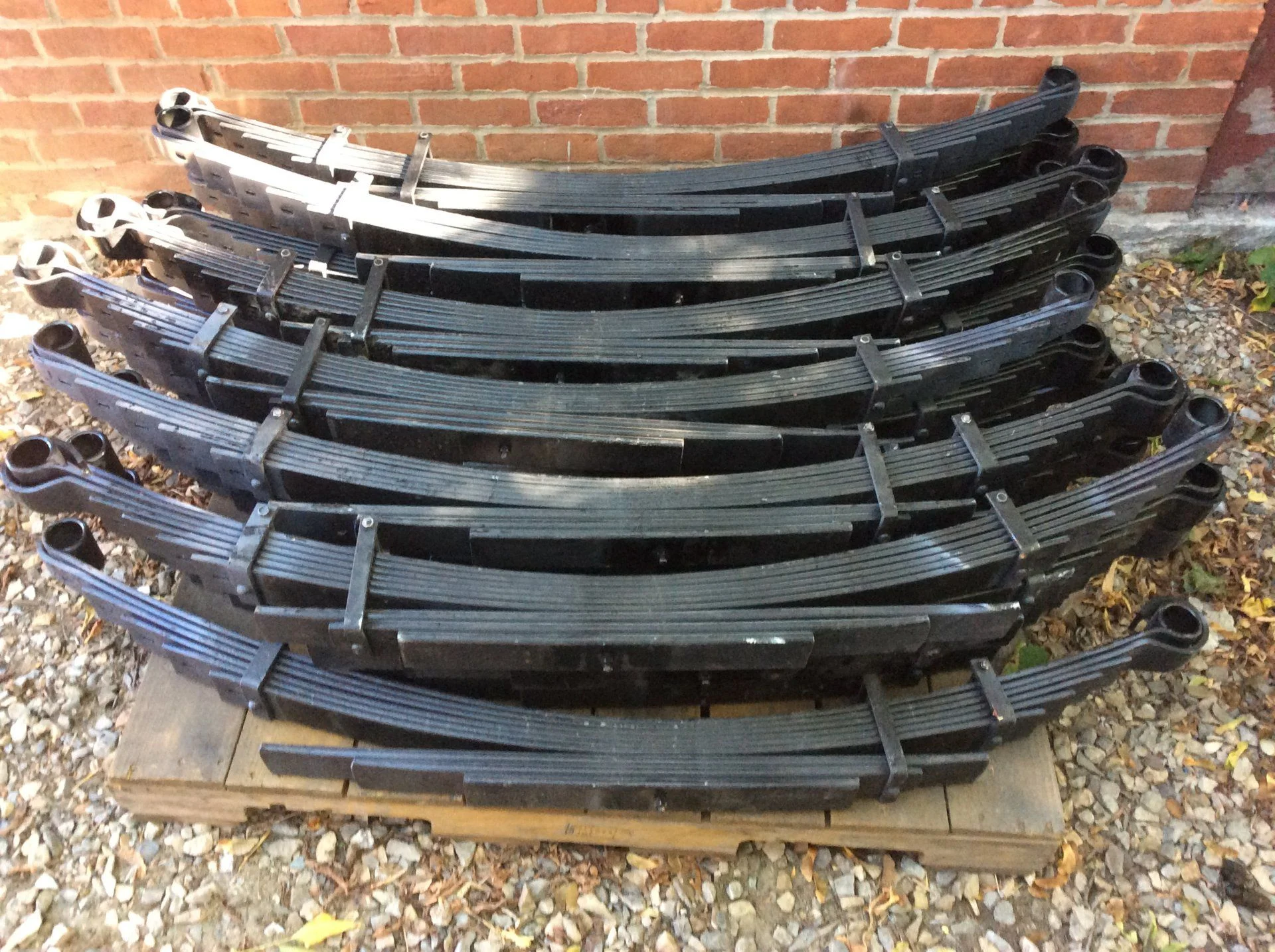

I have a ton of shiney new take off 59.5" VDJ79 Land Cruiser springs. While a little shorter, they might work well for these swaps. They have a Berlin eye with military wrap, 6 main leaf pack with 3 overloads... you could build just about anything out these. $100 a pop + the ride.
