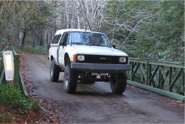

I ran OME fronts and 63's on the rear using a WFO mounting kit (with my own spring "plates") under my '84 Xcab known as "Patch". 33-10.50's & 4.88's. Bils 5100's with 255/70 valving up front and remote res 7100's with 275/78 valving at the rear. The rears started out with the std for leaf spring Bils valving of 255/70 and the damping wasn't right for the GM springs. Made my own shock mounts to push the shocks as far over close to the tires as was reasonably possible. I kept the longest 4 of the GM leafs, and ran the over-loads from a Mazda installed upside-down to prevent kinking the springs on the perches. Note the marks that the U-Bolts have rubbed into the bump-stop.
That combo of springs & shocks worked great for chasing desert racers, "overlanding", and crawling. The desert racing vets that I know were always kind of amazed at how well that leaf spring truck worked at speed.
The thing about the 63's that few realize, and it is visible in the pic above, is that they have a spacer between each leaf at the center pin and a plastic slider at each leaf tip. Note that there is a full length air gap between each pair of leaves in that spring. That significantly reduces the internal friction in the spring and produces a much nicer, more supple ride. That lack of friction also reduces the spring's own "self-damping", which is why the rear shock valving needed to be stiffened up slightly. I will venture that leaf springs that do not have these spacers and tip sliders are actually the stupid springs. The OME's under the rear of my 4rnnr have these spacers, but only because I made and installed them!

FWIW I ran the OME front springs in the OE hangers and the 63's in a WFO mount kit. With a 'glass shell on the bed the truck sat almost level without any camping gear or similar loading. I welded the rear shackle hangers onto the frame butted up against the rear of the OE hangers. The WFO front spring hangers were set such that the shackle angle was about 4:15-4:30 at normal loading. To do this the OE rear spring front hangers will need to be removed. I left the RS inner front hanger in place due to the parking brake cable attaching to it. A BFH 'moved' it out of the way of the spring.
thanks. Did you use the 5" shackle that comes with the WFO kit? how bad did the rear sag once you started adding typical camping weight ,etc? i typically have some tools and other crap back there at all times. i suppose i could leave the chevy overload if needed?
I used the WFO shackle. It did sag some, but it curiously didn't sag very much with a week's worth of trans Nevada on dirt gear in the bed. As I recall the GM over-load is a monster. Whatever O/L that I used, I put them in deliberately upside down so that they curve away from the spring, not towards it. Whole point of the O/L's was for the working leaves to lay down onto it gradually and not kink over the sharp edge of the spring perch. This lay-out does take them into a reversed arch (best way to kill a leaf spring is to do this, the further reversed you go, the more damage you do). This also keeps the rising spring rate progression much lower and more gradual. Patch rarely "bucked".

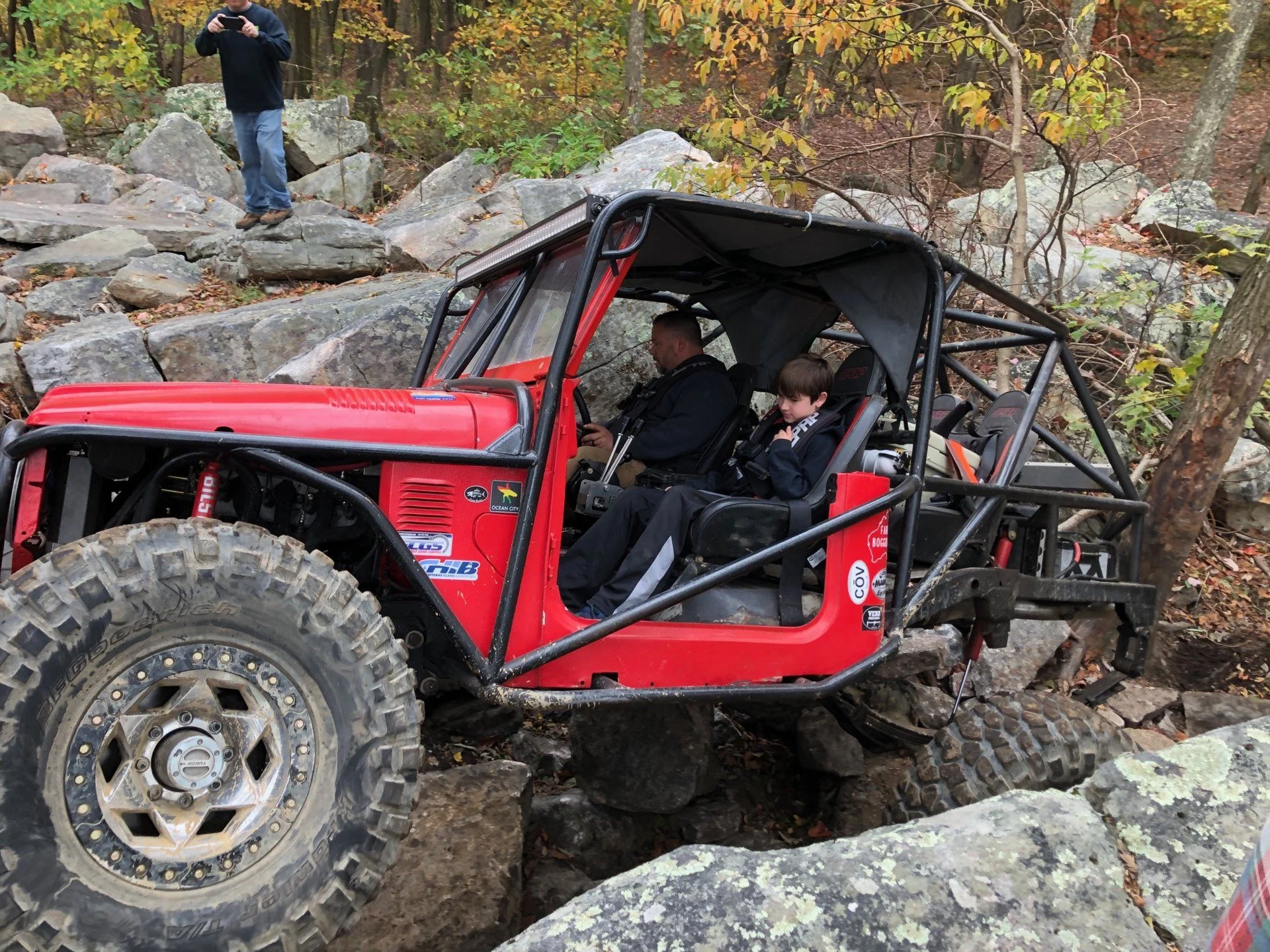

My experience with 63s:
The good - Great flex, support a decent load, cheap and easy to find for initial purchase and cheap replacement. New bushings are reasonbly priced and readily available from multiple places like Summit Racing. I think I have less than $200 in two sets of 63s, new bushings, and hardware. After 10 years of wheeling, I recently replaced one tortured set of 63s with a low mileage set that paid around $50 for.
The bad - They're long as hell and depending on how you set them up in your truck, the shackle ends can be rock anchors. The shackle ends of mine are exposed, hang kind of low, and get beat to hell.
Worth mentioning - A traction bar is a must with 63s otherwise axle wrap and hop will be bad. Factor that cost and labor into consideration when making your decision.
Worth mentioning - A traction bar is a must with 63s otherwise axle wrap and hop will be bad. Factor that cost and labor into consideration when making your decision. View attachment 2222530
Great advice right here. I forgot to mention that my 1980 Crawler had a custom ladder bar attached to the axle to help with that.
In 12+ years of using them under Patch I never found that I needed any sort of traction bar. No doubler, 4.88's, and only a rebuilt 22R with a very mild cam. Maybe with more gearing or HP, or both something would have been necessary. Early-on I speculated that I might need/want to add some urethane bump-stops to the fronts of the O/L's or to add some "limit straps" to the rear of the O/L's like the OE O/L leaf has, but that never proved to be needed.
