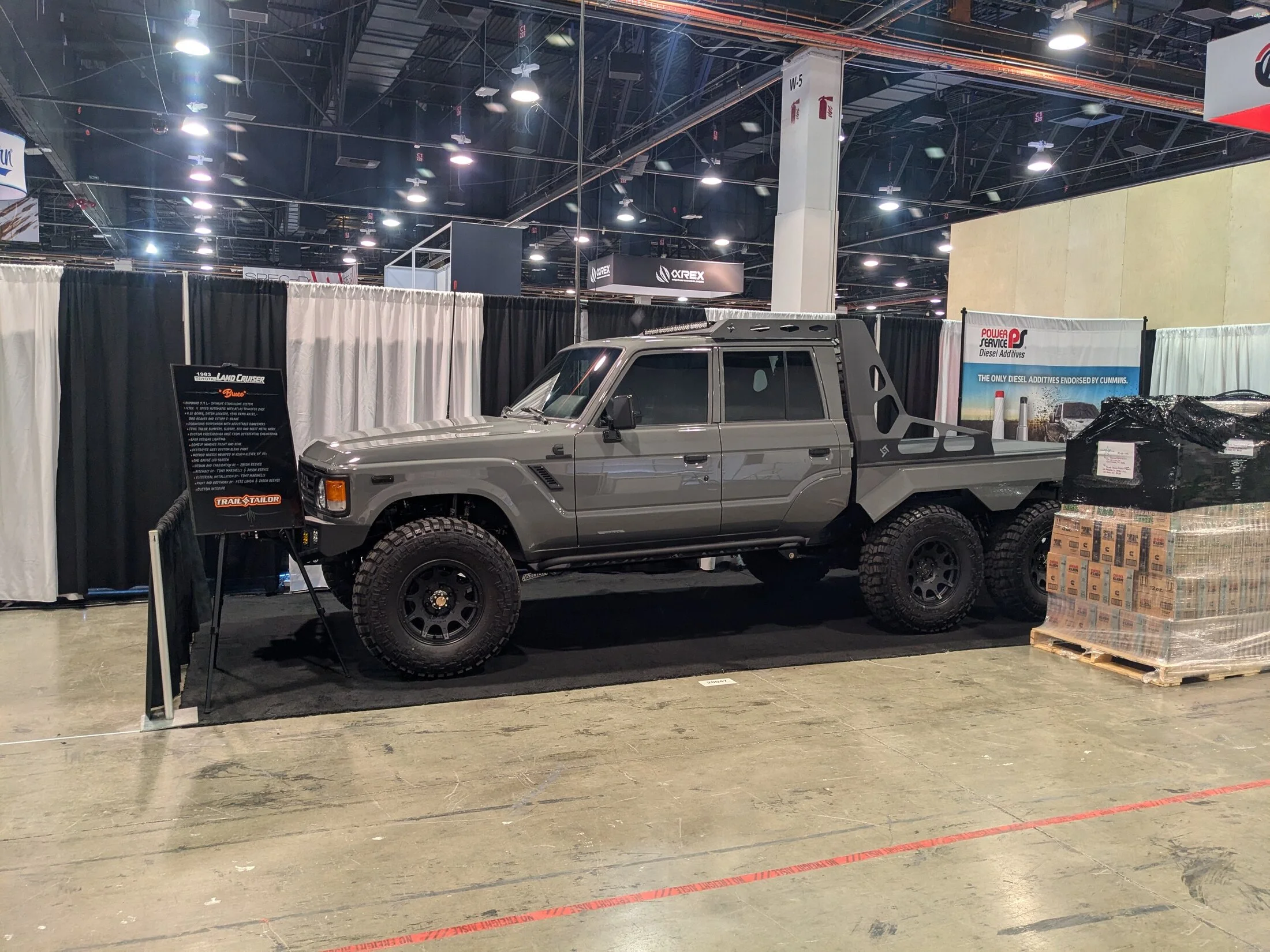

60FZJ-UTE 6 X 6 CUMMINS 24V 5.9L CRUISER

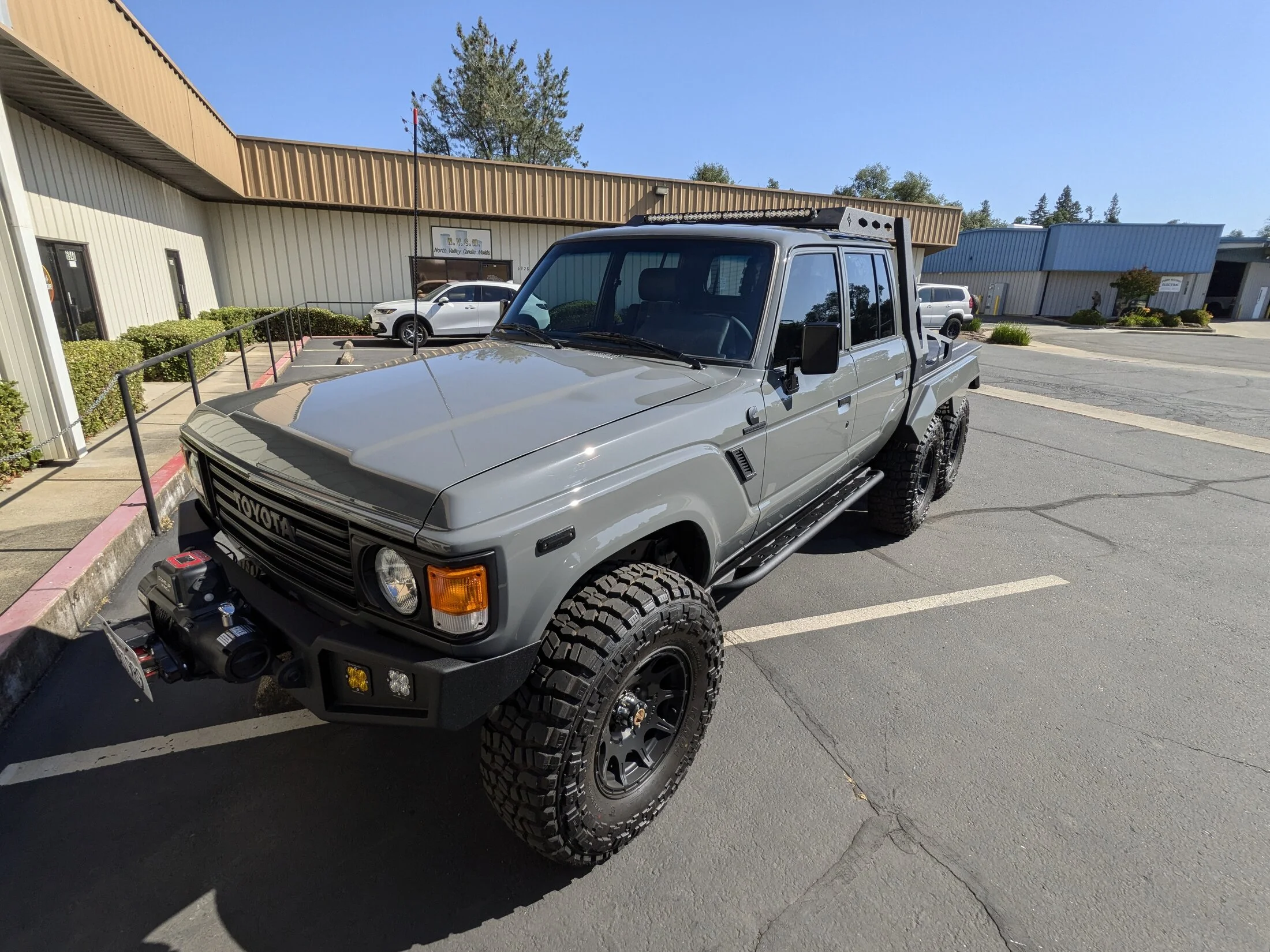

I love the juxtapositon of the giant dash screen and still having crank windows.

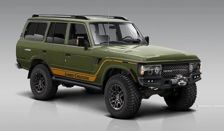

Any reason the front winch was not more 'integrated'.....it just sticks out weird and breaks up that beautiful front bumper
and it needs more front lift? looks a bit too front raked?....of course everything is over the top awesome....but curious
Didn't want the winch to be integrated, completely against the design idea and look I was going for and that @Box Rocket imagined years ago. I took a concept to reality with a few modifications to meet dimensions and depths required.
Lift.. Got to remember this has less than a mile on the VT coil suspension (x 4 vs x 2) and it will settle in the rear; approx. 1-1.25" per experience over 2-4000 miles.
PLUS I still have plans to add a 1800-2500# removable rear canopy to the rear if I don't sell it.
Built for END purpose and use, not immediate stance that with be reversed raked in less than 4000 miles... I see this too many times, people want a certain look/stance and its great until it isn't and it looks SHAT and a very inexperienced build ethic/practice to follow.

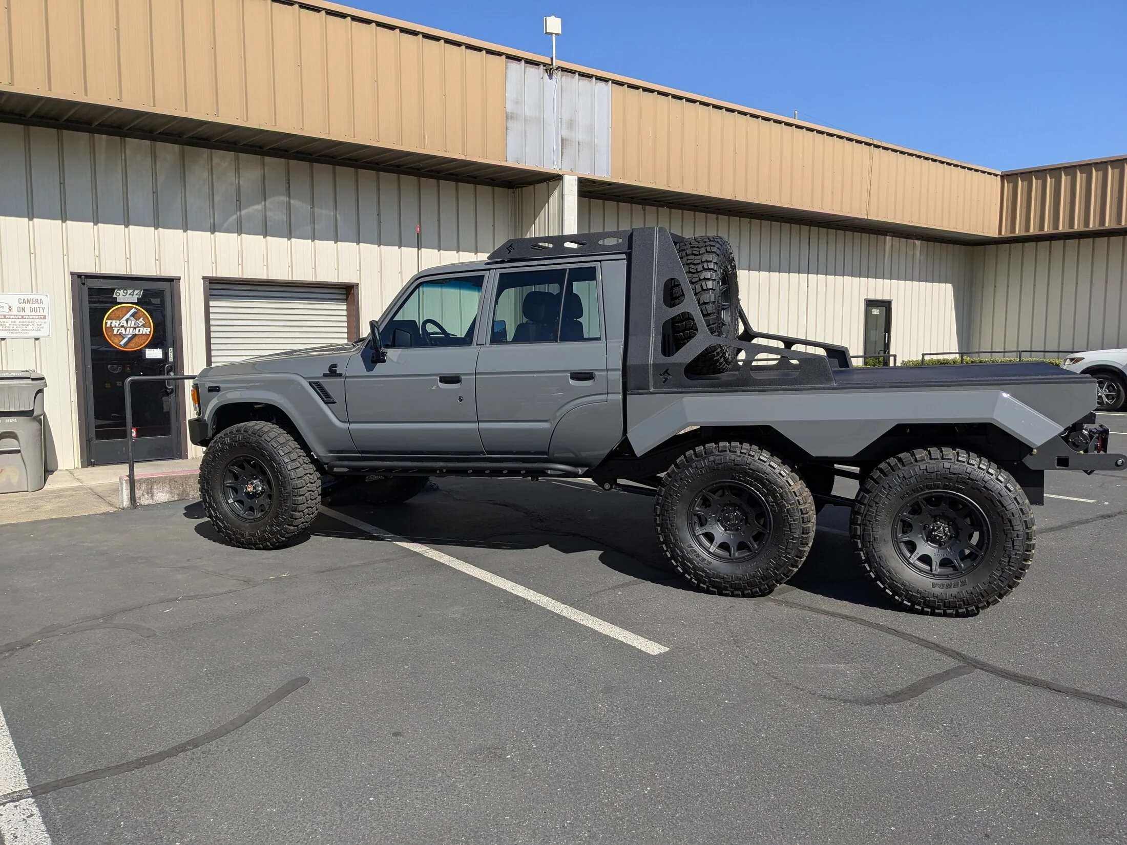

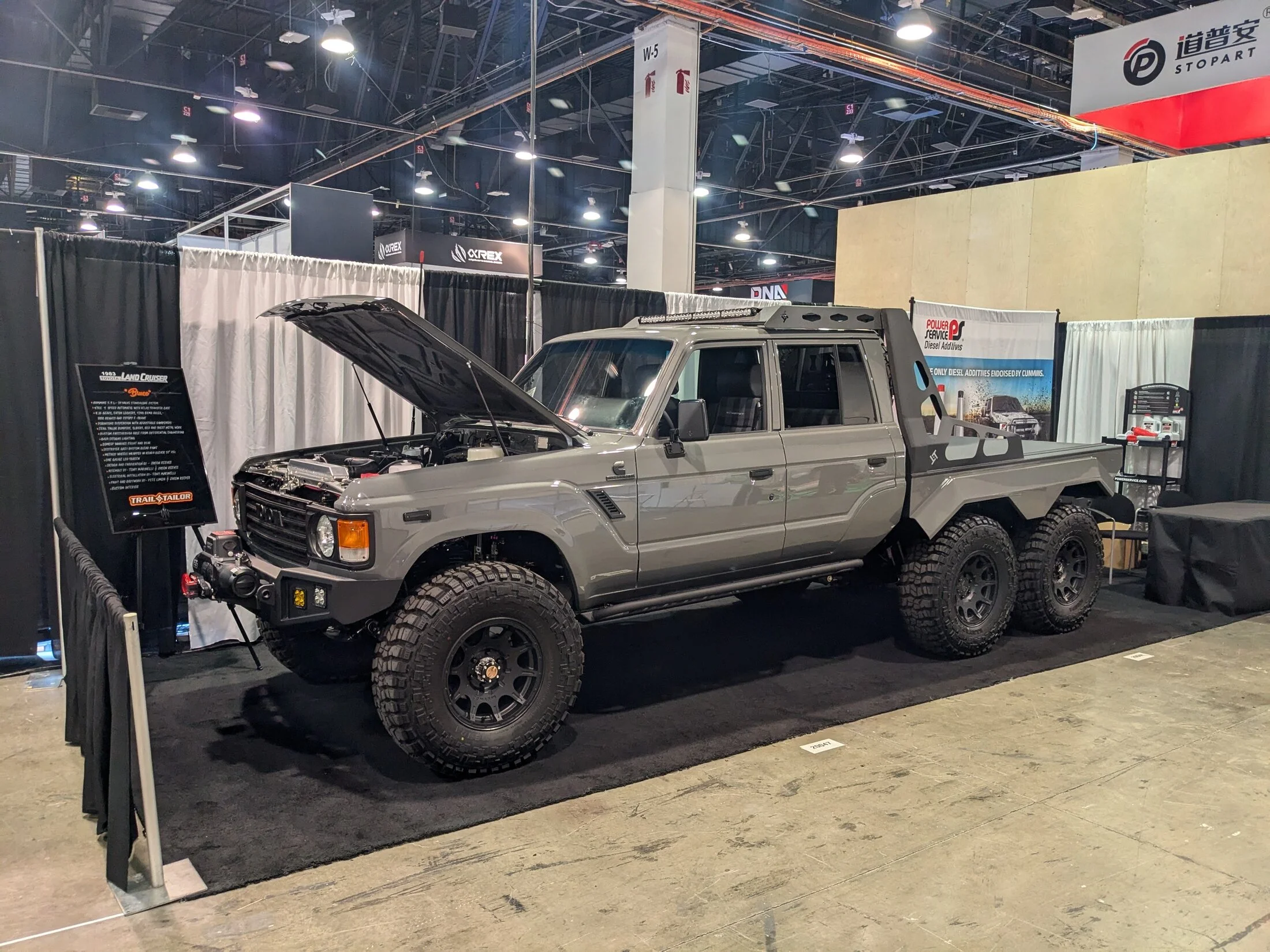

We are loaded back up and headed back today. The wait to load was over 4 hours last night after the show closed. SO........................ We fired it up and drove it a few miles north of the LVCC to meet the transport. SUCH a blast to drive this beast. Not to mention a head tuner. People love the smoke rolling out of the headache rack stacks.
Power is insane! It needs some shift point adjustment, but its close. Need to soften the rear suspension to absorb the power a little better as well.
From the calculations and power band specs we should be about 550HP and 1450 ft# torque. Even verified it with a Cummins tech/rep at the show. Tony thinks we can get it to pull the front wheel/s.... I don't know if I even want to attempt that. Put it in drive and the front end raises up 2- 3" at idle... HA!

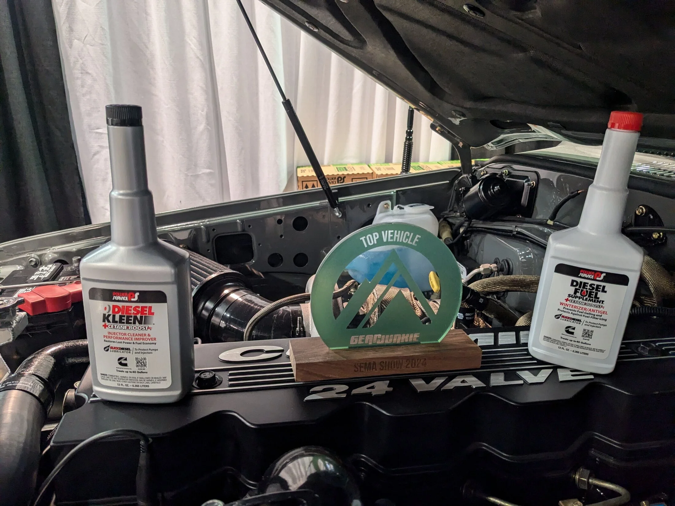

We received a BEST IN SHOW - TOP VEHICLE award by GEARJUNKIE 1 of 5 out of over 1400 vehicles this year! The other 4 were EarthRoamer, Proffitt's, Toyota 4R TRD Surf Concept and KIA EV Concept. A true honor to be lumped in with those four.
Article here:

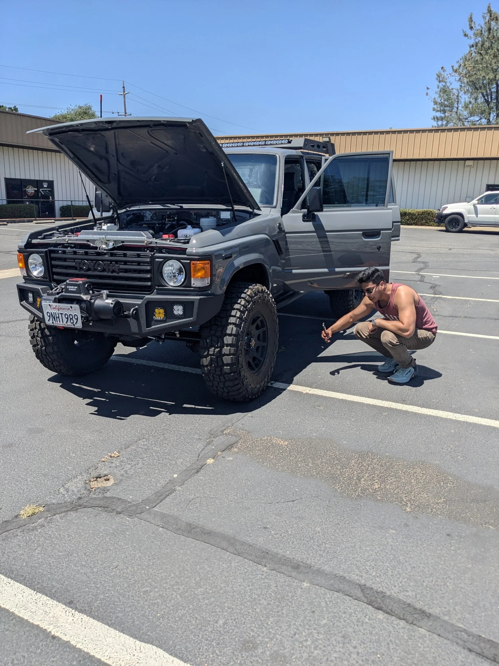

Turned the Quadzilla up a bit more today. Drove it about 25 miles to look at the parameters and data link/map the drive. It needs a bit more low end fueling tune. Its lugging at idle while in gear at a complete stop. I attribute this to the 150HP injectors , upgraded VP and larger turbo (62/68/12) at stock idle parameters that need adjusted. 100-250 more rpm and it purrs.
Hitting 37-40# of boost under proper fueling/throttle. Fuel pressure 17-20psi and EGTs up to 977F, op temp up to 204F, trans temp up to 216F (several hard launches and grades today).
I'm close on this tune. Once I get it dialed and documented I'll move on to the next.

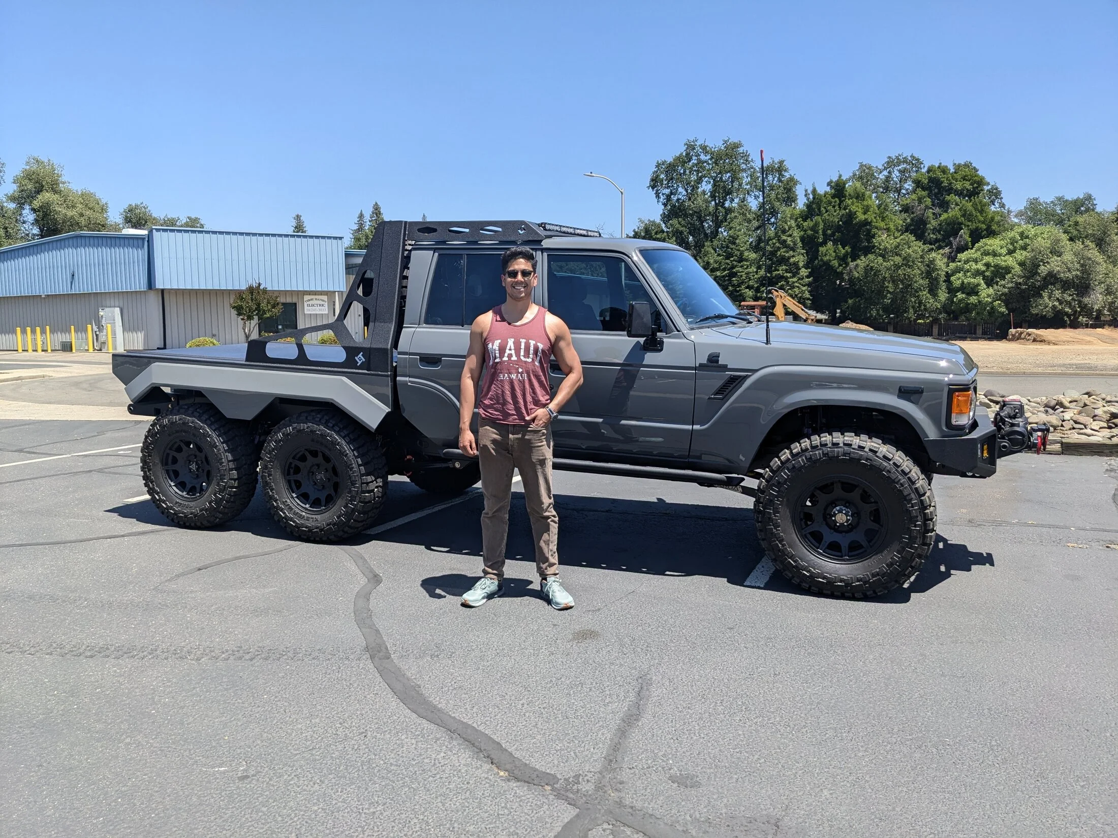

Been talking for several weeks with an interested party. He flew in from Dubai for business and then came up today to see the rig and pick up parts he had ordered to take back with him.
We have negotiated a purchase price of 550,000.00 USD for the rig. More details once everything is finalized.
This build has been a worldly adventure to say the least.
