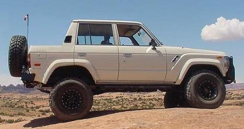

Two of my all time favorite 60 choppers...
Keep at it man..

When i saw the first one a month ago i loved so much that i have on my screen saver ,
I just secured a 1983 Bj60 and will be chopping it and making it like the first picture it is crazy as i never ever thaught of owning a toyota
