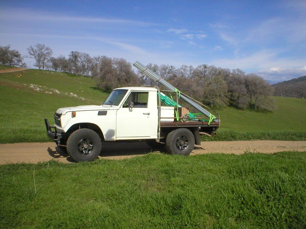

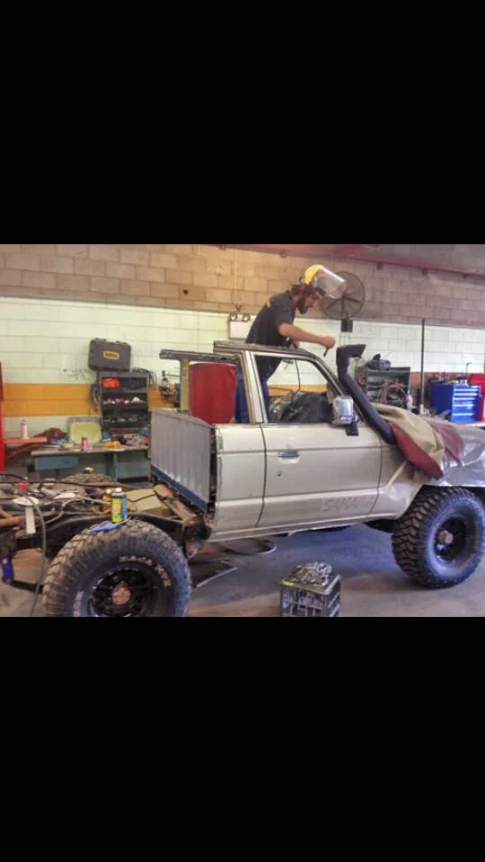

here are a couple of pics for you...
I think the 60 series body lines are harder to make look clean as a truck, but as you see in the first pic, when a genius does it, it can look OK...Having built the 55 in the second pic, my first advise would be to brace the interior vertically, horizontally, diagonally, front to back and inside out BEFORE the sawzawl comes out of the box...
the build thread for the 60 series is over on Pirate, the guys in stockton put it together.
also, respirators, cause breathing is a good thing
That side window treatment makes the truck. It looks really good. What guys in Stockton?
FC and Georg...Valley Hybrids

Lambcrusher, that 55 is pretty much the exact look I'll be going for. What did you use to close in the rear of the cab? Pics? Lots of Pics?
The one on pirate is insanely cool, but just a wee bit above my skill level in the sheet metal department.... I'm thinking find a scrap cab and use most of the rear bulkhead from it. I just really like a flat rear bulkhead as opposed to an angled one. It gives more room for me to kick my seat back too. Lets see some more deets on that 55. Is there a build link?
