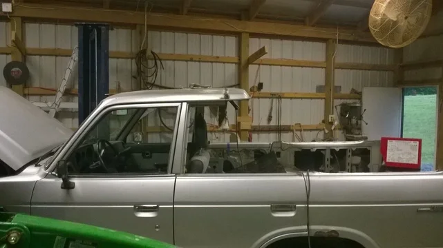

Yeah, I definitely won't go double cab. I really need the open cargo space. Also, I'm not a big fan of the unibody look even though it would be so much easier. Got the cab gutted today and started messing with windows. I may start with an 80's 4runner look and use a roll bar/bikini top before going full flat bed. The '4runner look would give me a pickup-esquw functionality with the option to haul extra people. We shall see. I figure I can always cut more off, but it's tougher to put it back on.
To make it look right i think you need to close off the cab and do a separate bed. Flat bed or Maybe one off a mini truck and add the body lines. Otherwise it looks terrible.

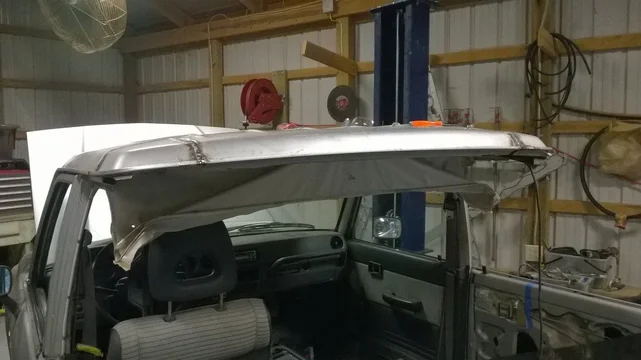

"Finished" up the rear cab line with the back of the old roof. wanted to get it semi sturdy before a camping trip this weekend. I will be closing in the rear of the cab with a mostly flat wall rather than the rear pillar of the fj60 body. What do people do for windows? What did you do white lightning? I would prefer to have a flat piece of glass in there. Just make my window frame?
Mine rear is lexan polycarbonate. But glass is the go as it will not scratch as easy just make a temple of the hole you cut and make sure you make the about a 3" radius for the corners so that the rubber seal will not wrinkle. Then take the temple to a auto glass mob and they should be able to cut some laminated glass and keyed seal to suit.
The glass in the doors is just the rear door 1/4 glass moved to the front of the door. Mine was is also built on a small budget. Paint job which i did my self was the biggest cost, may be worth Monstaliner it as it will save a lot of time on the sanding body filler perfectly and primer.
I ordered a custom cut of dot approved tempered glass and use school bus window gasket to keep it in place...you should consider having the glass cut to fit the fj40/45 rear window template, the buy an aftermarket one piece gasket from Specter

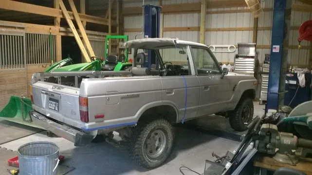

you may want to do some bracing before moving it much...
I was thinking about using rear 40 glass too, but I wasn't sure if it would be wide enough. My other thought was to snag a sliding rear window from a Toyota pickup and fit it in there.
As for bracing, the thing is super sturdy with that rear section welded into the roof line. Before I welded that in I took it for a drive and the cab would kind of shake around over bumps. Nothing now. It seems much less rattly than before. Also, the thing drives incredibly well. I love it without all that extra weight in the rear.
a light arse is a double edged sword...
Yea, I can believe it. It drives totally differently. I can already imagine the rear end skidding in rainy emergency stop conditions. I think once I get the bed on there it should be ok though. I wont be driving this thing everyday either. Mostly just to haul things.
