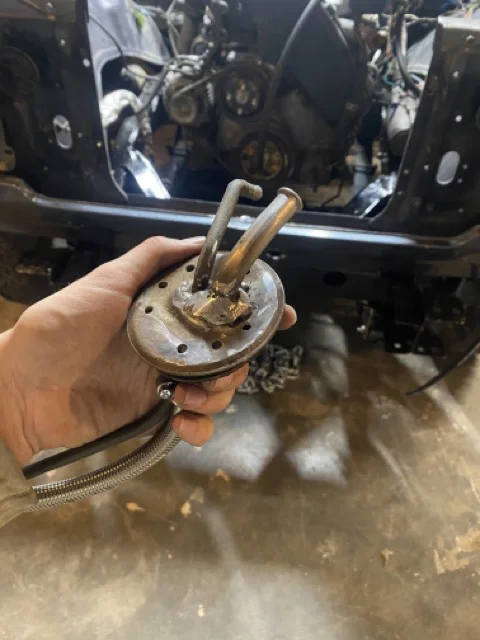

@mudgudgeon thanks for the help with the air in the lines. I traced the air in the lines all the way back to the fuel tank (bummer because I was quite tired of having to drop the fuel tank over and over again) and I was getting a TON of air in at the top of the tank. I had a friend weld a small section of 1/2" stainless tubing at the top of the tank (see image) and the weld appeared to blow through the tubing. Got that fixed, but I believe Im still getting a little bit of air in through there. Now the truck is running and running fairly well. Based on my exhaust, it seems that its running pretty rich. Fuel pump timing? Any other suggestions?

I have read other people having issues when running a secondary fuel filter.
Is this real? I was trying to play to safe by having two filters, and one up top with bleeder, but it sounds like this could make it difficult.
A 1HD-### really has no need for a secondary fuel filter. The tolerances are much more forgiving than a commonrail engine. IMHO run factory filters or something like ( Fuel Adapter System ) Suitable for Toyota Landcruiser 75 series 4.2 L 1HZ - https://www.berrimadiesel.com/adaptor-system-toyota-lc-75-series-4.2-1hz and change them regularly.
