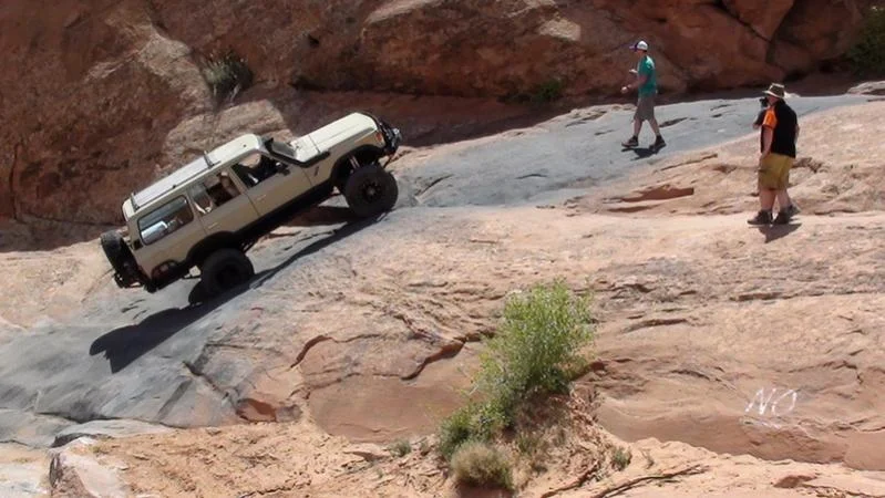

To keep it tech here are some pics. from Moab
Photo op on Porcupine Rim
Tip Over Challenge on Hells Revenge
My wife driving on Kane Creek
Kane Creek and Hells Revenge are some of my favorite trails! nice flex btw! :D
