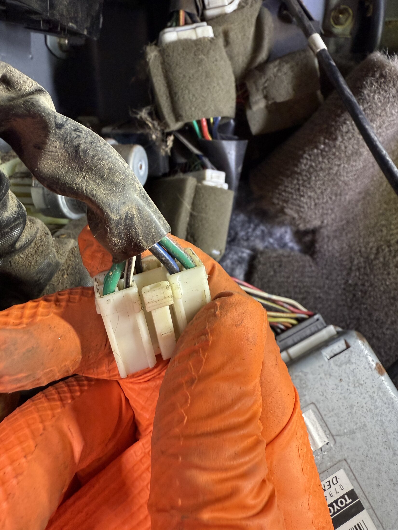

@ChaseTruck i just did the Pin7 mod in kickpanel and added an OEM CDL switch in my 97. But the switch is not working. (I do get the backlight in the switch). When I go into 4L the ABS light doesn’t come on. My question is does ABS get turned off with the CDL activation? Or is it supposed to go off when in 4L? I’m trying to figure out what isn’t working. CDL worked before I did the mods. Thanks.
The CDL disables ABS when locked. The CDL switch on the transfer case grounds pin A13-19 on the ABS ECU and illuminates the ABS dash lamp.
The Toyota EWD is invaluable when troubleshooting.
Thanks for the data. I’ve confirmed the CDL is not engaging. It worked just before I did this change. So it sounds like something has caused the CDL to not engage (and therefore no ABS light). So I’ll be checking the signal path from this new switch down to the CDL motor. There was a dummy plug in the dash connection C5 with pins 7-10 jumper installed. I’ll check if the switch accomplishes this also. And then check the activate/deactivate signals at the motor? I’m not sure what else could have happened after removing pin 7 from the kick panel controller?
That jumper shorting 7-10 is the same as having the CDL dash switch always on. That's why it auto locks the CDL in low range in the unmolested configuration.
By removing the jumper, replacing it with a switch, and removing C5-7 from the CDL control relay, you now have manual control of the CDL in both low and high range.
We’ve done this on the ‘93 a very long time ago. The one thing I remember is that I almost unpinned the wrong wire because I mistook wire colors under less than optimal lighting in the cramped conditions down there in the kick panel. Better light & focusing on the connector helped doing it right.
Oh s***. You guys are right. I depinned the wrong wire in the dark. It looks black with blue but it’s dark blue. And it’s pin 3. I’ll fix and remove on 7 and update. Cheers.
