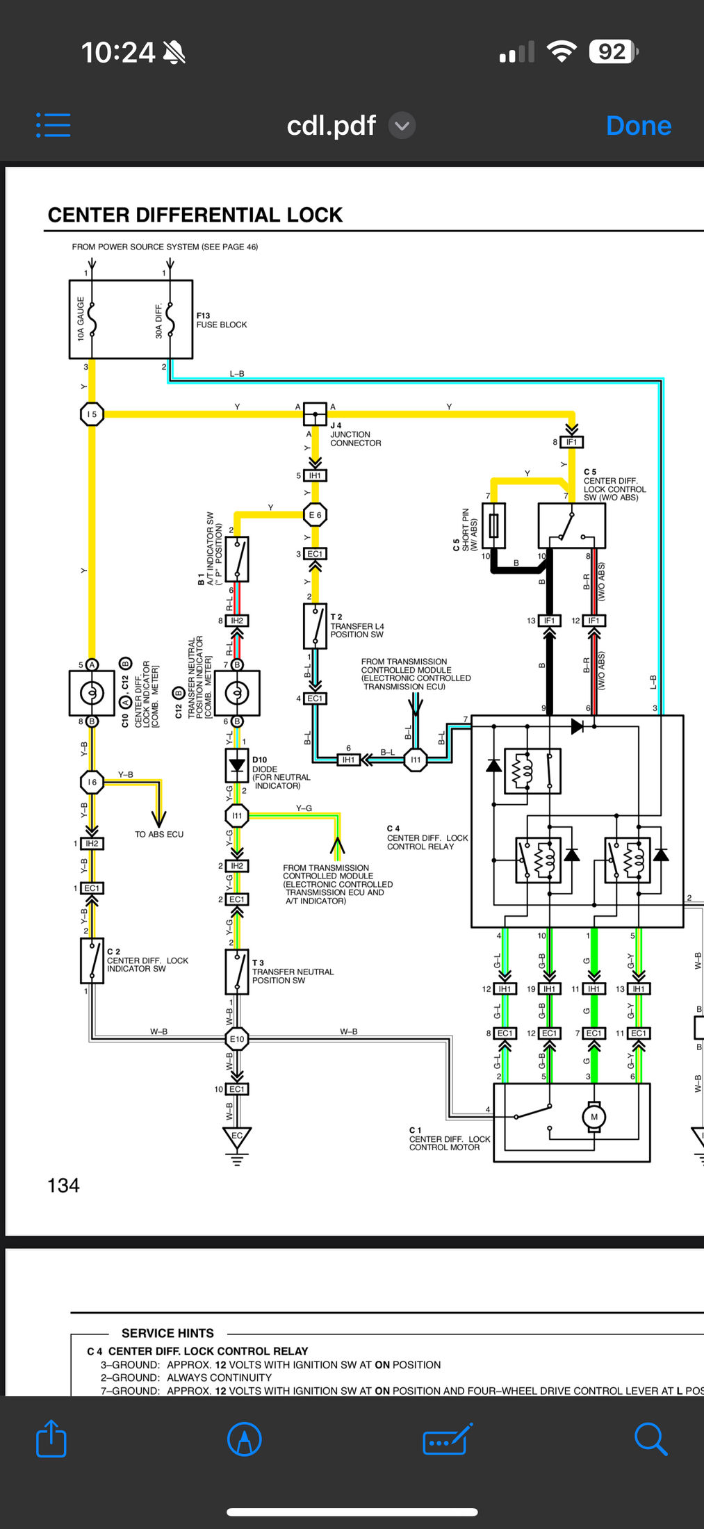

And I’ve been using this diagram. Why is it different from what you sent? @jonheld

NVMD! I got the 97 EWD and saw it matches what you sent. My bad. I got the previous from higher in the thread but I guess it was for other models.
