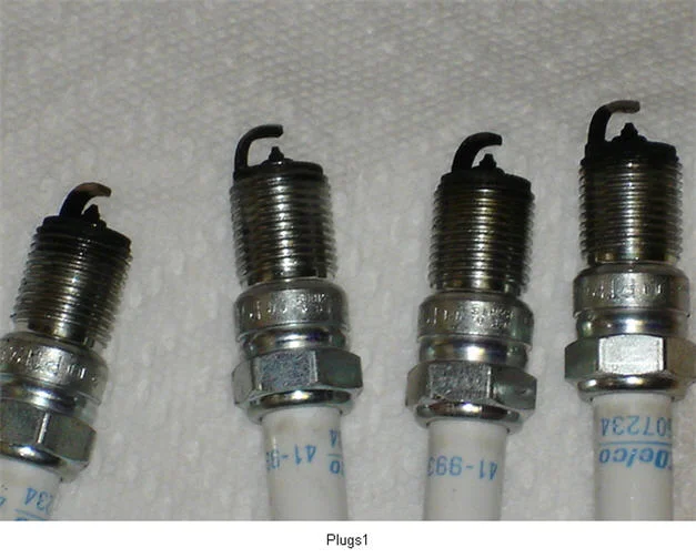

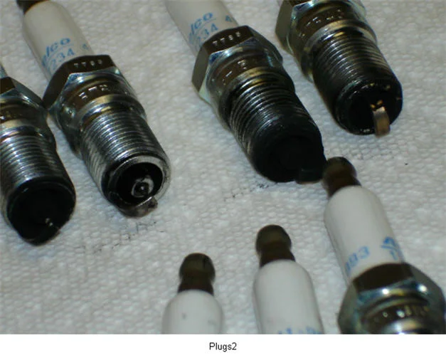

Plugs
Ok,
I've swapped the 02 sensors, changed spark plugs, and changed engine oil and filter. See the evidence of a a very rich running engine. While the pics are a little hard to see....you get the "picture"....
Waiting on new injector kit to show up, then I'll pull the upper intake off and swap injectors & spider setup.
While I did not take a picture of the 02 sensors... they look the same....black crap "raw fuel" all over them.
