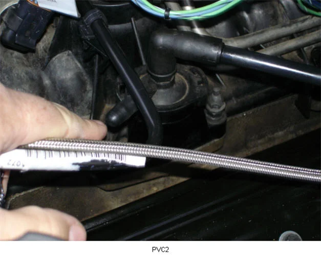

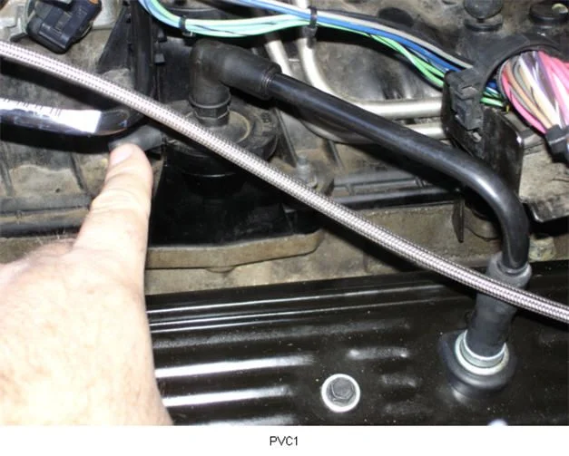

Ok, have new Evap cannister, and solenoid, + plastic hard line. Connected the wiring and installed the hose and have it roughly installed. Can someone tell me what connect to this (not sure of the name but see attached pic, its connected to the PCV valve.). Where you see my finger is a vaccum port I've capped off. Can someone tell me what is connected to this ? I assume a vaccum line that runs to something? See pics
I recall having a long plastic hard line that I think connected to this, but its lost in the mix now and I never had whatever was on the other end or whatever it connects to.
I've been looking through the shop manaual and so far I've not come across info on this, if anyone knows let me know. This is the driver side
of the 5.7 Vortec I have, that's from a 1998 Yukon.
Canister Purge

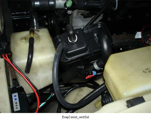

Remember this is the drivers side valve cover(post 171 above). The canister vent solenoid on a 98 is mounted right next to the canister(see 2nd pic below), the canister purge solenoid is located on the passenger side of the intake (see pic 1 below)and I've attached a picture of it below. It has the large plastic hard line that runs to the canister. ON my 98 there are no more fittings on the canister, its even shaped differently than a 97. I think the above pics have something to do with the PCV?
Are you talking about something other than the evap canister?
See 2nd pic that shows the evap canister along with the canister vent solenoid.
I think this valve I showed on the drivers side of the engine is plumbed into something else because I don't see anywhere for it to connect on the evap canister. The shop manual only shows two connections to the 98 evap canister. (1) one hose runs to the gas tank (2) the 2nd hose runs to the canister purge solenoid.
Edited to correct my screw up in directions... **
I do have clear directions in the shop manual on the purge solenoid, the evap canister and the associated plumbing. THe large plastic hard line runs from the purge solenoid over to the evap canister. THe evap canister in the 2nd pic has two ports...(one for the large plastic hard line)(one for a line that runs to the gas tank) in addition on the bracket that holds the evap canister you can see the vent solenoid(pic 2 which connects by electrical connection).
In post 171 above I"m trying to figure out what connects to that "valve" on the drivers side of the intake. I've looked all over the GM shop manual #2 that referes to engine "stuff" no luck so far. This valve really pulls some vaccum ie ...leaks at that port, thus the reason for the cap.
The pictures in the manual clearly show the evap plumbling and I've tried to replicate that .... So far I don't know what that valve is called that connects to the PCV in the picture on post #171.
