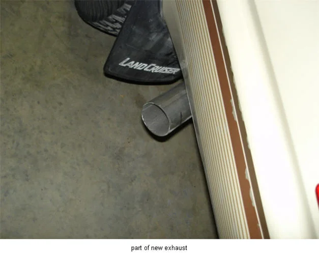

Exhaust is complete: 2 pipes from manifolds feed into a dual inlet single outlet mangaflow and then exits just rear of the drivers side rear tire. Exhasut runs real close to frame rail on RH side so we will have to figure out a reasonable route to plumb for fuel. I removed the factory hardline prior to exhaust work.

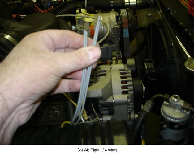

Starter wiring looks to be simple. Batter cable to large stud on starter and small wire that has a connector on it to the solonoid...don't see how this could be any different. On the alternator I have a pig tail that plugs into the socket on the GM alternator with about 4 wires coming out of it. On the toyota side I have the white wires with the eyelet and then additional wiires that have the large plastic connector at the end. Anyone have specific wiring notes on this?

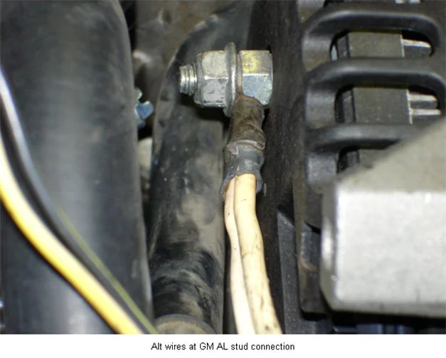

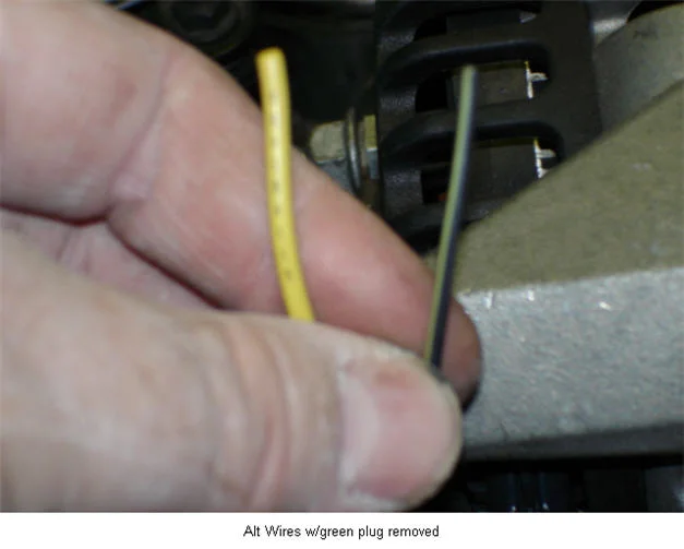

First I wanted to ask about the Alt wiring. See in the first pic below the wires that use to connect to the Green connector at the Toyota Alternator. Can someone tell me where these wires should go on the GM alternator. I've read differnt things and have asked around. In the 2nd picture you'll see me holding the wires that connect to the pigtail that plugs into the side of the GM alternator. I believe one of these ties back into the pos (+) battery connection stud at the rear of the alternator (I belive its the one marked S on the connector , I'm going off some notes I found, and have not yet looked at the pigtail close enough or maybe the alternator to see if the terminals are marked. The third pic shows the main ALt wires connected to the stud on the back of the GM alternator. I used a "reamer" and enlarged the toyotat eyelet to make this work. I may change this later to add some thicker wire because I've doubled the Amps at the Alternator compared to the OEM toyota alternator and the GM alternator I'm using.

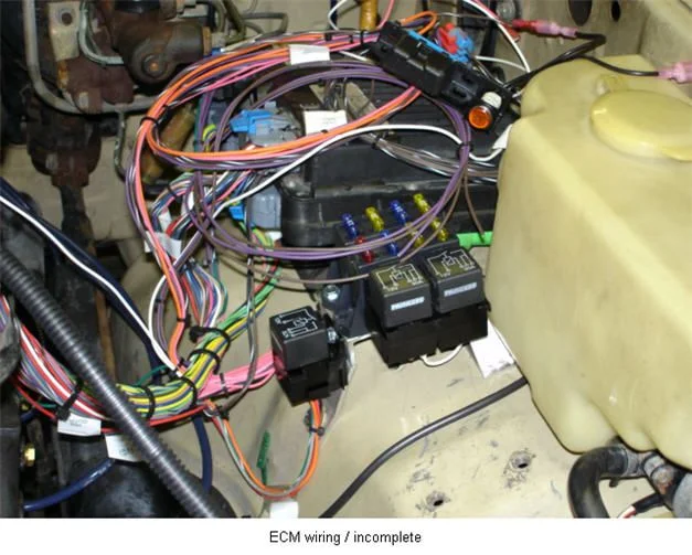

Also see the ECM mounted with the fuse block. Hard to see in the mess but the ALDL connector is laying on top... I think for the purposes of getting the truck running we may just leave the connector under the hood for now. Also modifed the dipstick bracket to work. Other picture shows new tail pipe and the gas tank vent tube, that we have not done anything with yet.
Completed the plumbing on the power steering, finished the ECM mounts + fuse block, complete wiring of the SPAL fan and controller, completed wiring for the engine harness, we have power at Ign on through the pos (+) coil wire, cranked over engine to make sure starter works....it did, and of course complted the wiring on the starter, and installed o2 sensors.

can someone identify the two wires in the first pic on my post # 132 above. These are the two wires
that connect to the toyota alternator using the green connector....at least thats the way they were on my 86FJ60.
Looks like one is green with a ligth green stripe, and the other is white or use to be white in color.

Truck did start right up,... I used one of the long shims on the starter and everything seems fine. We did figure out which wire is the "exciter" for the alternator. I need to get a heavier guage wire to run from the ALt to the battery.
